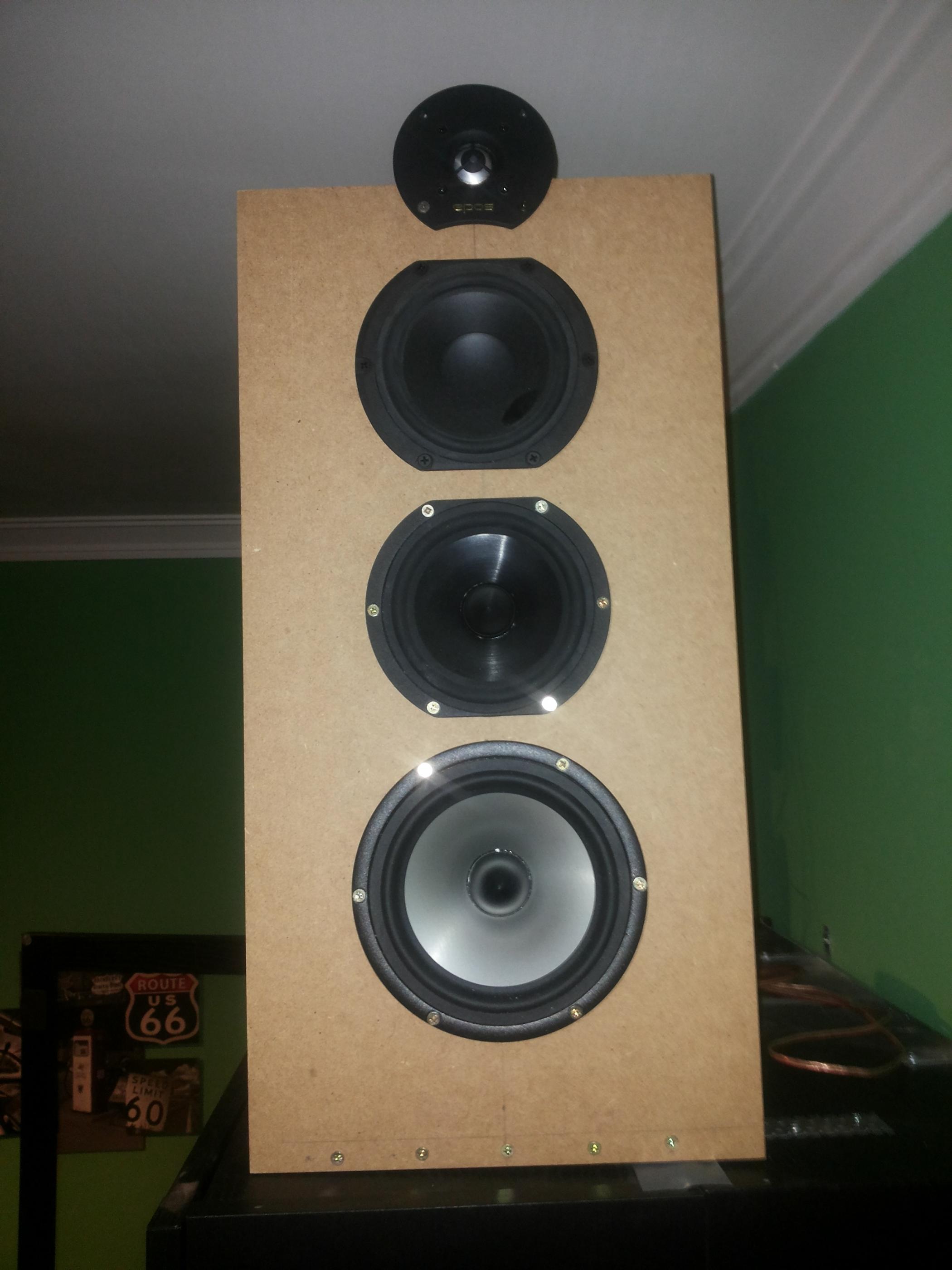

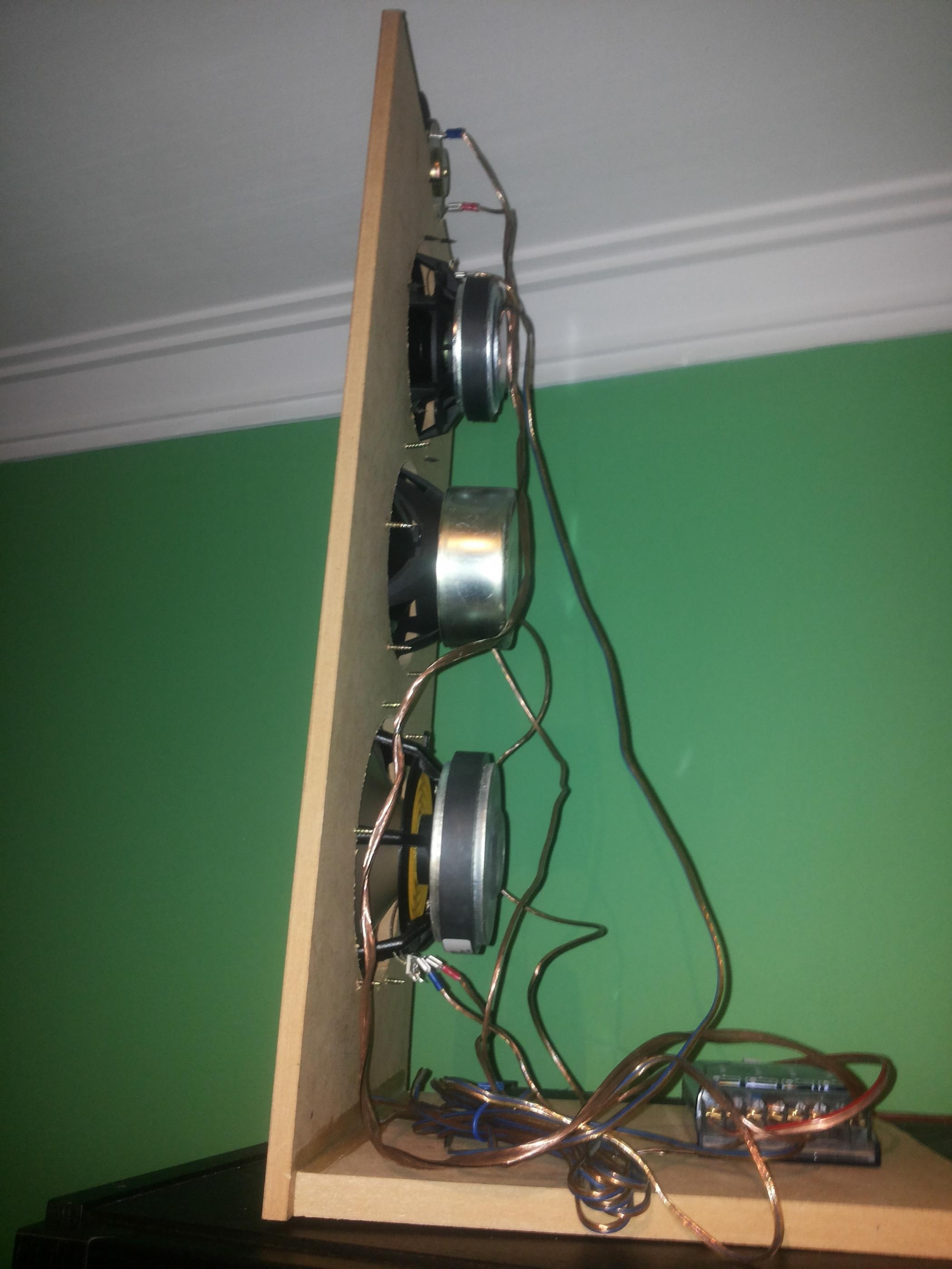

My very modest and first atempt at a open baffle speaker made with drivers i had and heavily equed with minidsp . Not finished but i was in a hurry to try it...
I will add other parts to stiffen to baffle later , i tested it last night seems very quiet but i will do it anyway , I use subs below 80hz , bass driver are seas 18rnx 6.5" and 5" from epos els3 speakers in series , midrange is peerles and tweeter also from epos els3.
All are left overs i had.
