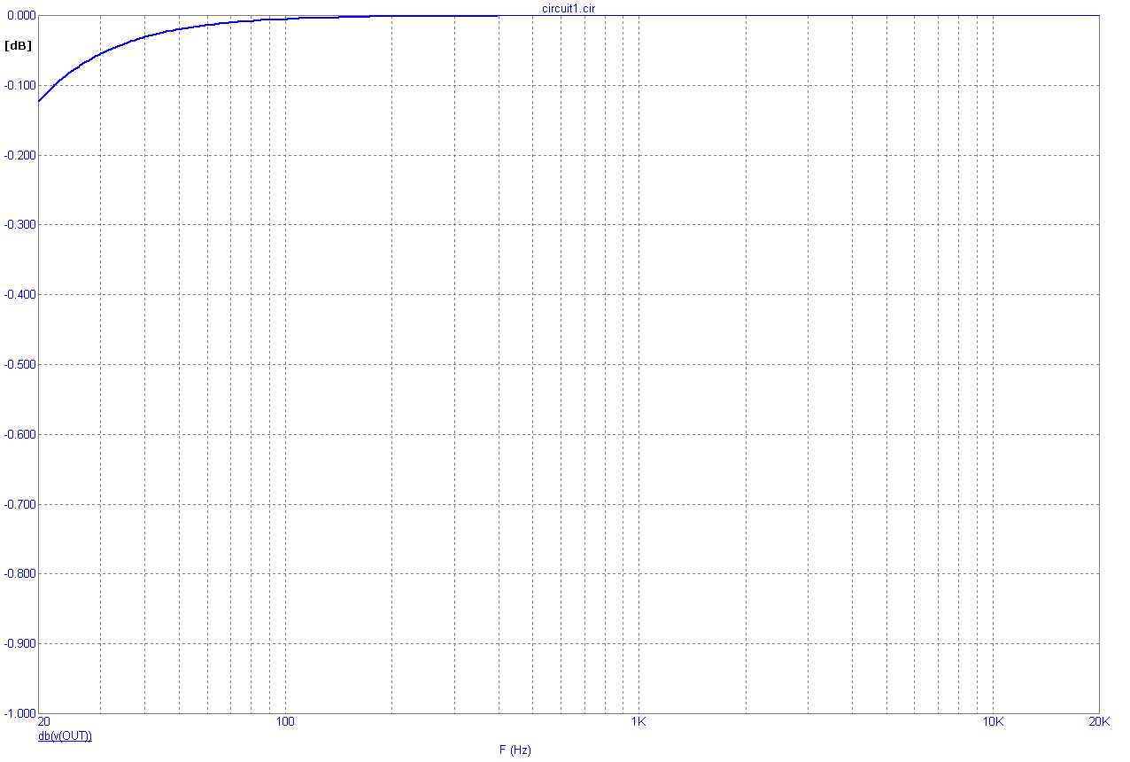

Again, I'm largely with Jay here. Been out of the picture for the last day or so, but did a first differencing based purely on visual alignment, and this shows a significant phase shift factor: the lower the frequency the greater the difference. So, a more involved process will be needed to tease out significant aspects.
Yes, the phase shift that corresponds to -0.1dB at 20Hz. Audible?
Once again, visual alignment of two files that are not sampled at the same moment (simultaneously) is very tricky.
I was curious about the -6dB not quite clipping on the blue and green files. What it looks like is hard limited in analog then a LF rolloff before being A-D converted.
I took Gaucho from the CD, re-sampled it to 48K, boosted the gain +2.4dB and flipped the phase. Looking at it there are 30-40 clipped samples in this form and the level matches within .1 dB to blue and green. Hard limiting to -6dB FS and its very close to the blue and green files. What I want to know is where did the 0 down to -6 peaks get removed?

Here's another guess: the low frequency roll-off is set by the DAC out and ADC in both the L+R channels. I.e 4 places: ABCD.
You did a soundcard loopback with L to L and R to R then a crossover loopback with L to R and R to L. In the latter you swapped the channels back in software afterwards.
This explains the slight difference in low freq roll off since A+C is not equal to A+D and B+D is not equal to B+C.
It also explains why one of the files wouldn't load in my mp3 player.
Green was the crossover version.
