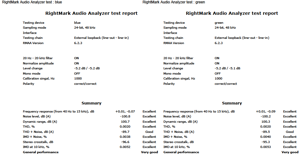

Just once more please let me repeat the RightMark results, both blue and green in one file:
Okay, so blue has better performance including IMD. Small? Tell me about it!
