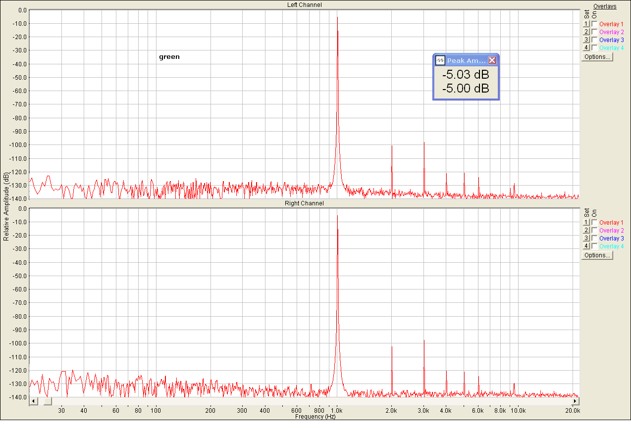

First, I would like to show the level of amplitude matching of the 2 music samples used. There were 2 audio chains:
1. blue chain: D/A - 'blue' device - A/D
2. green chain: D/A - 'green' device - A/D
D/A and A/D were same in both cases.
FFT of complete blue chain and green chain are now attached.
Thanks Pavel! If you still have the setups active, can you do a sine at 5kHz, please? That often shows more difference than 1K. When you see my comments, you'll understand. If you want to do dual tones, too, we would be happy to see them.

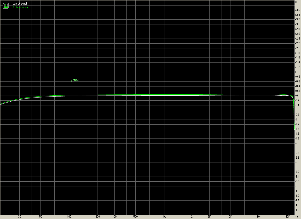

OK, I was delaying a thing a bit. Even 5kHz makes almost no difference. Please see complete RightMark results, with IMD vs. frequency as well. I am not posting hardware setups yet, for you guys to have a space for sending your impressions to Mooly.
Anyway, I assume I can guess your comments, they might be similar to mine and might be the reason why I started this test.
What's the reason for the change in low frequency roll-off?
Thanks Pavel. I was just curious because neither Blue nor Green sound like the rip I have of the same song. Maybe your source was different, or the master was. I suspect both, as your files are @ 48K, not 44.1K
My source was 'Studio Master' 96/24 flac file for D/A playback, but recorded at 48/24 A/D after it passes through 'blue' or 'green' device. It should not matter as the original has almost no content above 20kHz. But, the D/A - A/D process has changed the resulting sound somewhat, when I compare it with the 'Master' 94/26 in a listening comparison. So I agree with you, it sounds different from the Master data file.
