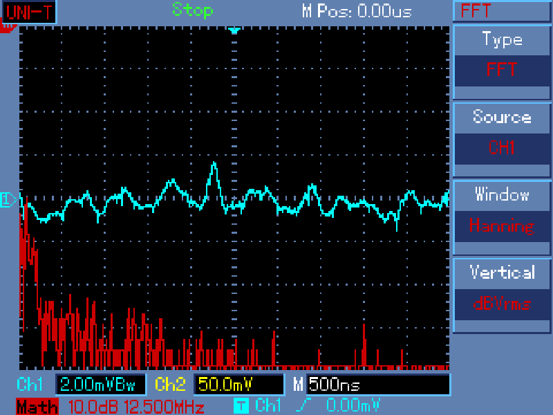

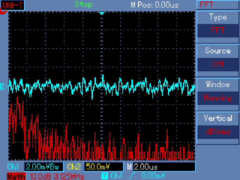

But actually, there is not so much of HF mess at the output of this DAC implementation.

You read it well, but FFT is enlarged and Y shifted and the top is above visible screen, though the marker says it is on the top - it cannot travel higher.
Anyway, the green almost does not change the HF spectrum. There are many paths for HF to leak, if it is not strictly UHF design and case.
