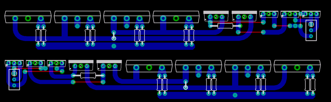

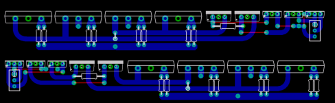

The IPS is on the previous PCB and the OPS I attach now.Can you post your amplifier PCB layout as well?
(The rails are wired with cables from collector to collector in the air.)

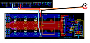

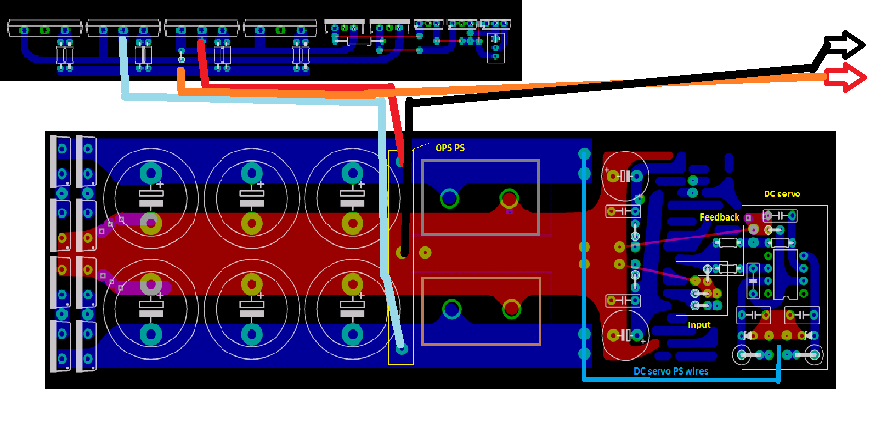

Can you draw this?Yes! The speaker GND wire goes to that GND point in the middle of the OPS PS section.
Is this correct? I tried to develop it correctly even 2-3 years ago when I made it... 🙂
From your description it sounds wrong, but I may be misunderstanding what you have typed.

See the attachment, thats how I wired my PS to OPS @ Speaker.Can you draw this?
OK -I see what you have done here.
The decoupling is on the IPS board. The 0V to the IPS board caries both the small lsignal ground return and the decouple ground return.
No decoupling on the OPS from what I can see - can you confirm that?
I think you need to test as described above - looks to me like one of the issues could well be the common 0V line.
