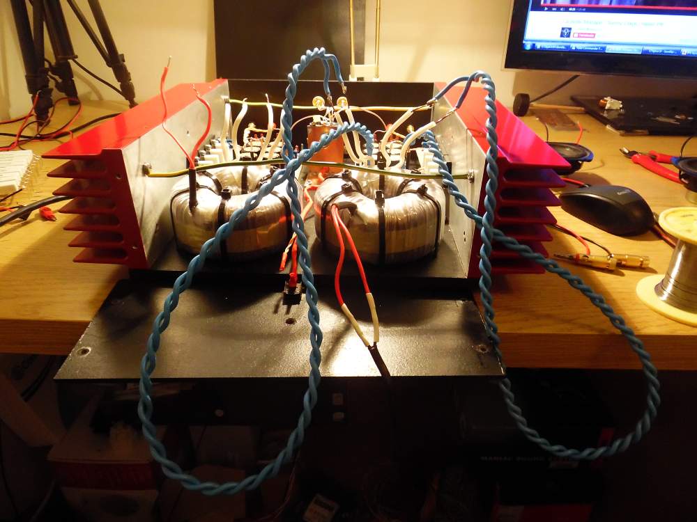

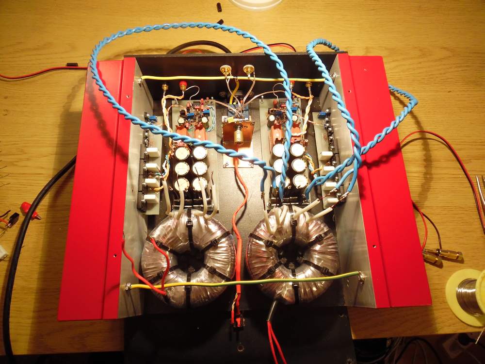

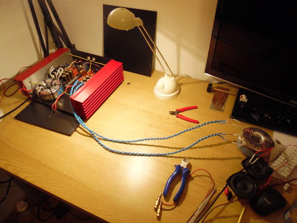

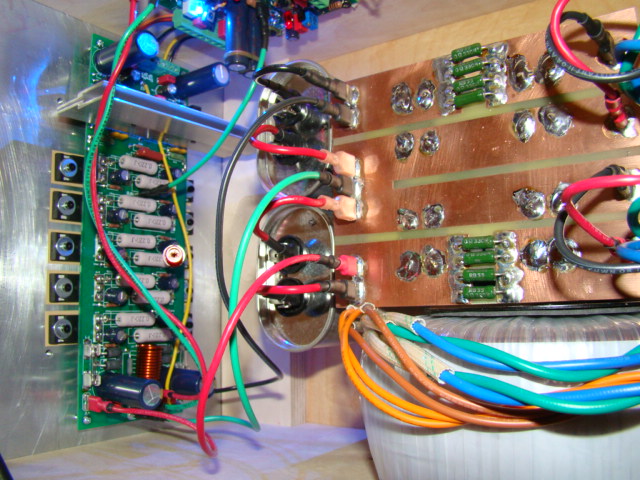

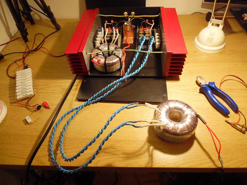

Report: I couldnt wait for testing this trafo EMF at last... 🙂
Moto: it is 100x times more useful to try something instead of asking/reading a lot... 🙂
Tests
Conclusions
Tests
- just using 1 side of this dual mono layout
result: the hum didnt change at all - secondary polarity changes (all the 4 combination)
result: the hum didnt change at all - wiring the main AC line far from the whole amp from front direction
To further: the amp is 100%-ly insensitive to main AC line!
Even puting it directly to the pot, input, FB wire, etc... Nothing hum incresing at all... - inactivating the earth
result: in my case the hum decreased a bit (heatsinks & pot case still wired together and via 10R+10nF to amp GND) - using EXTRA long ~ 1m secondary wires
result: the change was subtle, even when laying them directly to the sensitive parts(!!!) - puting the trafo far away
result: nothing changed - experimenting to holding the trafo to all parts of the amp in any kind of position
(sorry, no pictures I have only 2 hands... 🙂)
result: the trafo already could cause bigger hum but only at the input part, the PS and the OPS are completely insensitive to it.
Other: in some angles even holding it 1cm from the pot it didnt made any additional hum...
And in opposite with ostripers experiences: I found that the radiation is LESS at the P/S takeoff points.
Conclusions
- There are a lot of misbeliefs and misunderstandings carried on without testing.
- In a distance like at my layout the trafo EMF doesnt count (when there is no other big problem with wiring, grounding, etc...)
- Sec polarity: related to hum I didnt experienced any difference.
- Pri polarity: this maters clearly (in my case ~3x times more hum).
- Sec EMF: when the loops are minimized/twisted the EMF is subtle.
- Trafo placement: puting it directly to sensitive input section can be hard without shielding (as expected).

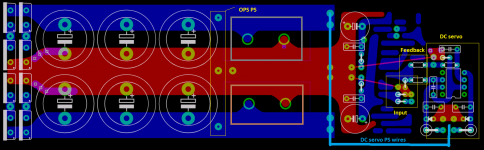

Can you show us your PSU PCB layout? Is your star ground 'T' d off from the PSU cap 0 V?
If moving the transformer does not change the hum, your problem may be more related to common impedance coupling see Daniel Joffe's first example.

Cortez, have you tried re-routing your mains cable to the switch well away from the pot and small signal wiring? Even with a 10k pot, set to say mid position, it will take surprisingly little capacitive coupling to introduce hum and noise with the configuration you show,
Yes I agree if moving the trafo away didnt solve it it shouldnt be a radiated pollution...

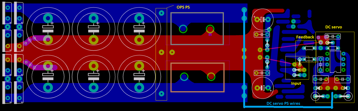

PS PCB:
Here you are! I tried to show only the relevant parts with colorization:
The red trace is the GND. You can see the rectifiers, the main filter caps,
(the last squared ones are 2.2uF oil paper caps for smoothing HF), the IPS PS.
As you can see the input section is very compact.
Now instead of that red wire going to the main GND trace there is the 10R resistor.
Any comments...?

Didnt you read #63?Cortez, have you tried re-routing your mains cable to the switch well away from the pot and small signal wiring? Even with a 10k pot, set to say mid position, it will take surprisingly little capacitive coupling to introduce hum and noise with the configuration you show,
I tested this as well, surprisingly it didnt made any difference.
To further taking it very very close to the ipnut/pot did not cause any increase in the hum at all!

If I am reading your diagram correctly, the 0V goes to the amplifer PCB, and there you terminate your on board decoupling and your speaker return - so there is only one 0V wire between the PSU 0V and the amplifer PCB. Is that correct?

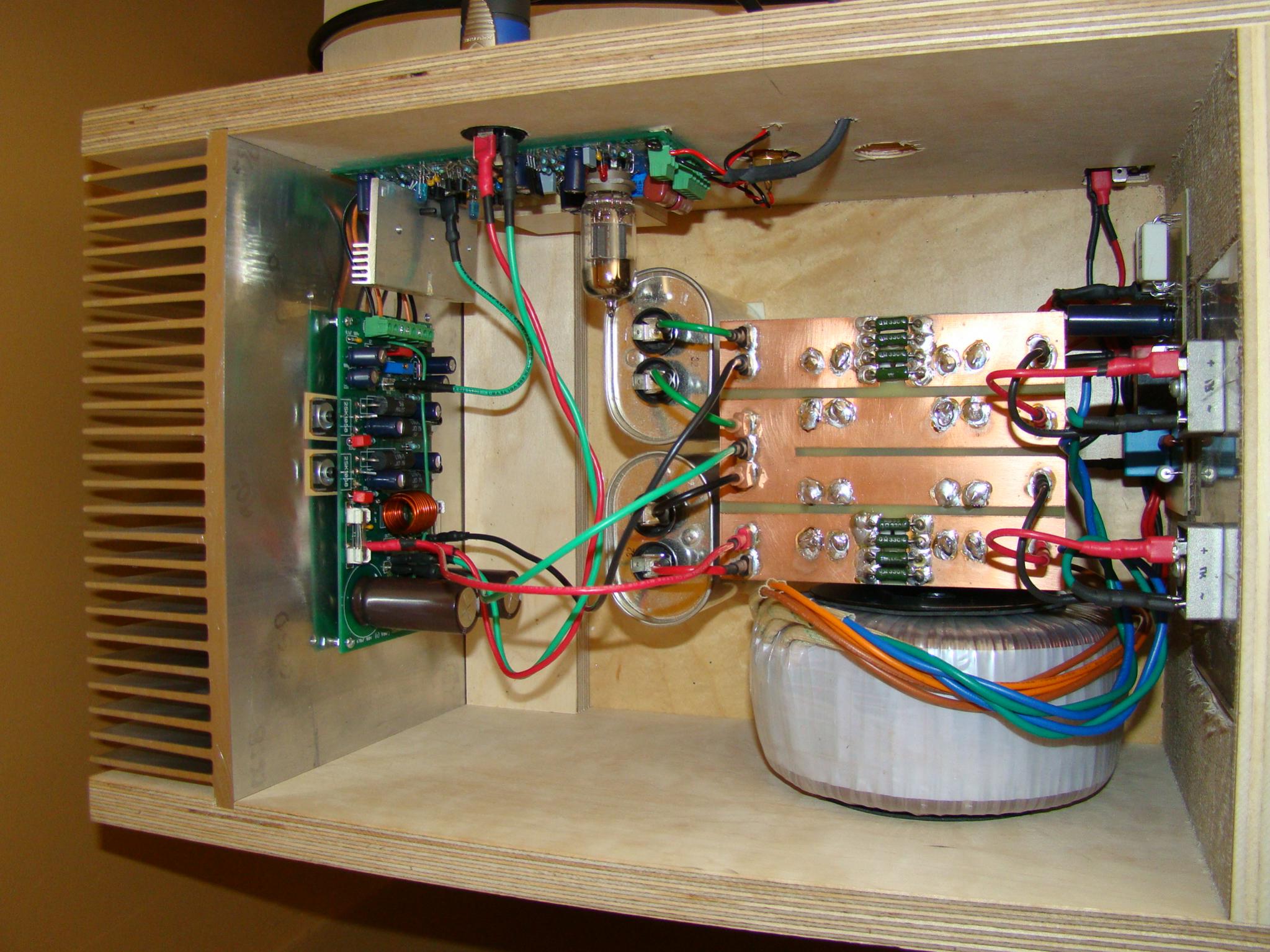

Here are a couple shots of amps I'm running. These are all the way quiet...as in ear to the cone and no noise. Since the photos I have installed the safety ground from the ground pin of the ac inlet directly to the heatsink and from there connected to the power supply ground through a cl60 thermistor. The amps were equally quiet with and without this addition. In retrospect I might do a few things differently but I probably wont mess with what works.
Evan
Evan
Wow - nice furniture Evan! I salute you! 🙂

Yes! The speaker GND wire goes to that GND point in the middle of the OPS PS section.If I am reading your diagram correctly, the 0V goes to the amplifer PCB, and there you terminate your on board decoupling and your speaker return - so there is only one 0V wire between the PSU 0V and the amplifer PCB. Is that correct?
Is this correct? I tried to develop it correctly even 2-3 years ago when I made it... 🙂

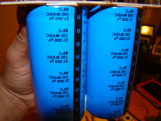

And how this statically radiated noise works?
You mean it spreads in a capacitive way from pri to sec and then to the PS?
But even the it is not clear to me ho can a 50Hz/100Hz hum go through the big filter caps an on the FB..?!
The caps "hum" , as well.
Even as they are smoothing a rectified trafo secondary , that 50/60hz
still comes through as charging pulses at the caps.
Hold a tiny amplified audio trafo near the main caps or rail lines and you will
hear that 50/60hz plus harmonics (quite a different sound than the pure AC/trafo) ... lower level - but it is still there.
When this rectified "hum" reaches the amp , it's feedback/PSRR cancels
this out -just a simple "unregulated supply" - not perfect.
For more intolerant amps (CFA's) ,I added cap multipliers as an offset for this weakness.
