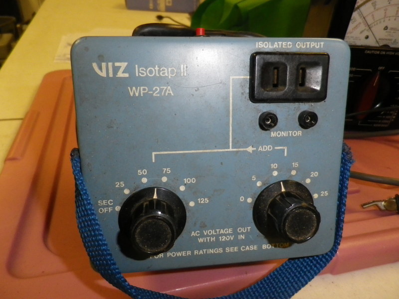

Does anyone have any experience with these? I had a friend give me one since he's closing shop, and if I can drop the little bit of hum I have by using it in front of some more sensitive gear, is there any danger in trying it? I don't want to cause a problem using it with 1 or two pieces of gear that's connected to other gear that isn't.

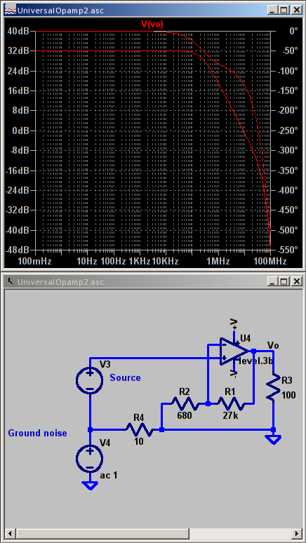

Note carefully where HBRR is located. Bonzai has the resistor on the wrong side of the adjacent junction. He has located the resistor IN the signal route.
Bonzai's location does reduce the current, but the resistance adds the interference voltage to the signal voltage. I think you had spotted this when you said:
"If any ground current flows via this 15R then it will be added to the clean input signal, wont it..? (attachment)"
Yes to your question "won't it..?"
The Joffe attenuation works because the added resistor reduces interference current AND moves the predominant interference voltage (interference current times added resistance) into a part of the Loop that is outside the Signal Flow and Return Route.
The 15R resistor in Bonsai's PDF is a terrible solution. As you can see, the noise is amplified by the full gain.
Connecting the feedback ground on the other side of the resistor is better, but the ground noise is still added at a gain of 1.
Reducing the ground path length will reduce the voltage developed, but that won't help when most of the resistance causing the problem is the input cable's shield. Furthermore, since ground loop currents have no return path inside the chassis, it will radiate magnetically with no way of twisting with the return path to cancel the field.
So the ultimate solution is to break the ground connection without adding ground noise directly to the signal. This is why I suggested my CMC ground isolator, which does exactly that. This is a common EMC technique.

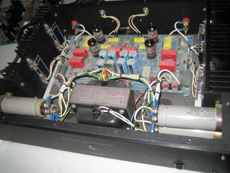

Well here is my practical input to all this. Exhibit A, one counterpoint SA100 that has hummed since I got it. Previously my room was big enough that I could ignore it so I did, thinking that it would encourage me to get back into DIY. Well I finally have, but finances have stalled the new amp build, so I need to eke another 6 months out this beast. Should be useful for testing the theories on this thread because it is a sub-optimal design at best. I am going to pretend to be thick and follow instructions as given to see if they work, as this should prove things.
First thing to note is that yes, the input mains cable runs all the way under the main board to the transformer at the front of the chassis! So unless anyone can suggest otherwise steps 1 and 2 are dealing with that and the input wiring. The main board is loosely dual mono with left and right diode bridges and smoothing caps. The speaker return runs under the main board.
Photo btw is not of mine, but broadly similar. Welcome any additional suggestions except for 'ugh rip it out and put a proper amp in the case' as I am sorely tempted, but would like it to be some use before then.
