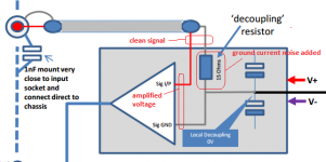

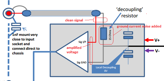

Cortez, the original version had the 15 ohm isolation resistors in the wrong position. The updated version has them drawn correctly

Hmm.. Are you sure..? I checked and the 15R is now in series with the input signal.Cortez, the original version had the 15 ohm isolation resistors in the wrong position. The updated version has them drawn correctly
If any ground current flows via this 15R then it will be added to the clean input signal, wont it..? (attachment)

Cortez, I think you have copied the sch from Bonzai.
The decoupling resistor is in the wrong location.
I tried to explain this to the Author. He asked for further information so that we could understand the alleged "problem".
I sent a long explanation via the Forum as requested.
The Author did not reply !
I have downloaded the current pdf "how to wire up a power amplifier - updated"
the decoupling resistor is still in the wrong location.
