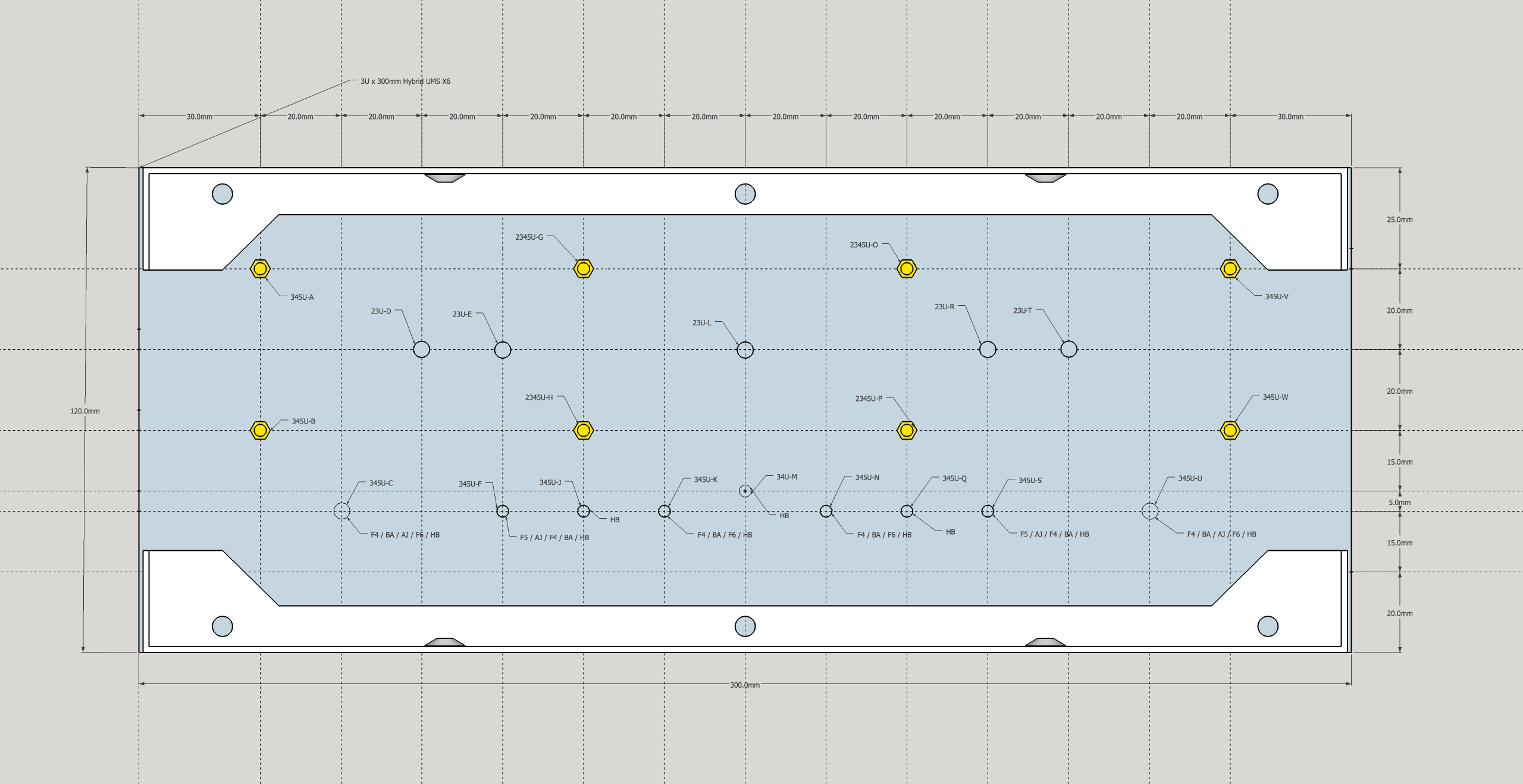

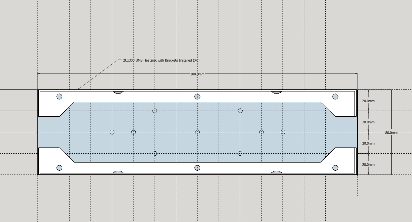

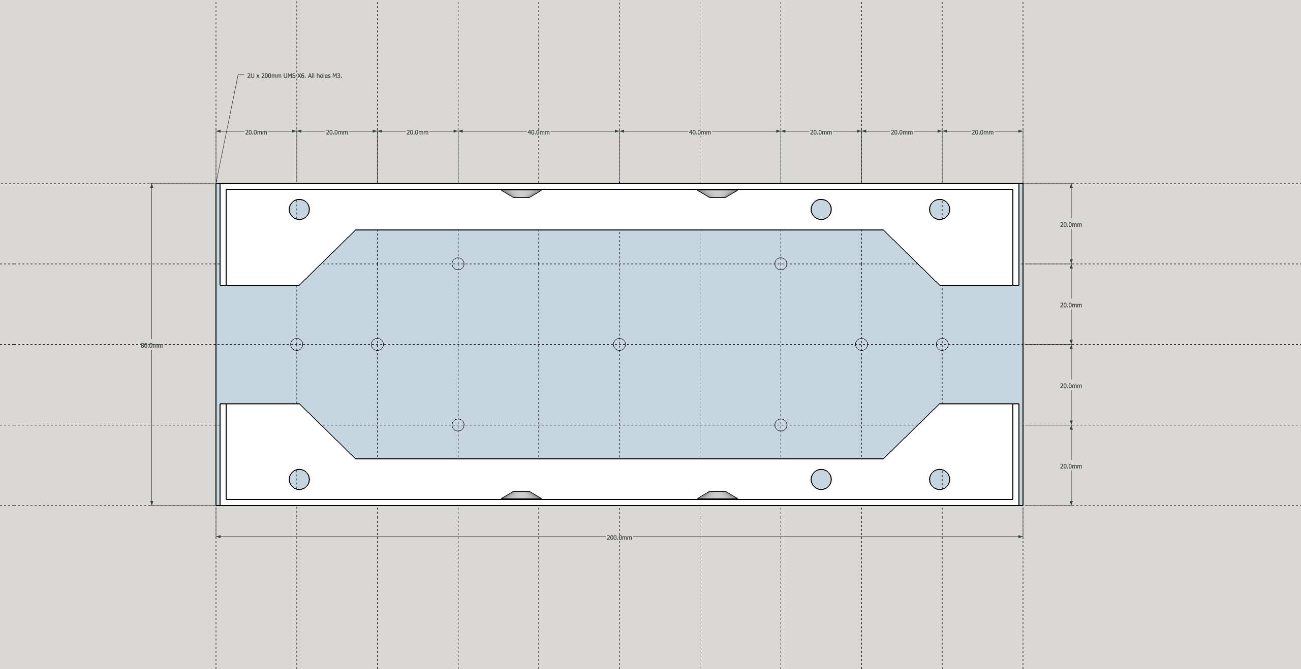

As a way of providing context, attached is a 3Ux300 UMS design. It takes the 2Ux300 UMS (again as yet unpublished, but it's what you see in the ACA heatsinks), and merges it with the 3Ux300 UMS. You can then upsize a 2U project to use 3U heatsinks, or downsize a 4U project to use 3U heatsinks. Why has it never made it past the drawing board? Well, for starters it's a bit of a dog's breakfast (a mess) isn't it? Again, not to say it's not a good idea or won't be implemented, but adding holes with wild abandon is not something we want to be doing. Less is more. These are important holes that will adorn the chassis of DIYers for many years to come, and should be carefully considered with input from stakeholders (designers, builders, etc).
As I have mentioned a few times, it's about time for a UMS 2.0 revision. It's been 8 years. Take the learnings from the last 8 years of this interesting experiment, and make any adjustments necessary.
- Publish the existing 2Ux200 and 2Ux300 specs.
- Confirm a 3Ux300 spec (whether it's a hybrid monster, or not).
- Possibly add Pico's 4Ux500 ideas into a 4Ux500 spec (The symmetrist in me would like to see more of the 500mm heatsink being able to be used as well as split and centered boards catered for in each of the split heatsinks)
- Possibly add a 3Ux400 or 3Ux500
- Possibly adjust or abandon the current vertical offset of the UMS on the heatsink in favor of vertical symmetry
Keep in mind that each standard requires Hifi2000 to consume and keep stock on their limited shelving space. There needs to be a good market demand and turnover.
All these are good and interesting possibilities. Feedback will be welcomed by builders and designers. Past customers will be surveyed.

We've been asked many times over the years for a 3Ux300. A 4Ux500 is a neat idea and Gianluca and I are very happy to roll it out as an experiment. But the devil is in the details.
Here's what is probably going to happen:
- The store will make available a standard 4Ux500 Dissipante chassis. There will be a limit of 16 of them available for pre-order (unless some of those are consumed by a custom order from Pico or others), shipping in 2 weeks. At this stage, these will be standard chassis, not deluxe (no baseplate, no UMS, no max vented covers, no rear holes, no rear faceplate holes).
- If people such as yourself want to buy them, great. It will give us confidence to work on this format more in the future.
- Currently there is no such thing as a 500mm baseplate. The 400mm baseplate can be used, or we could make custom 500mm ones for this run.
There's a lot of interest in this thread, but I'm presuming what people want is varied - plain, UMS or "Pico" heatsinks, plain, Deluxe or custom rear panels, will a 400mm baseplate do or do you want a 500mm baseplate. Anything is possible, but the easiest thing for us to do for sure is just roll this out as a standard item first and people can customize it as they like, as they can currently with any other chassis from the store.
Down the line, a 4Ux500 Deluxe could be born.
As for Pico's needs, that's no problem either. We just need to know what he wants.
It sounds like he has very specific requirements and we're happy to help.
