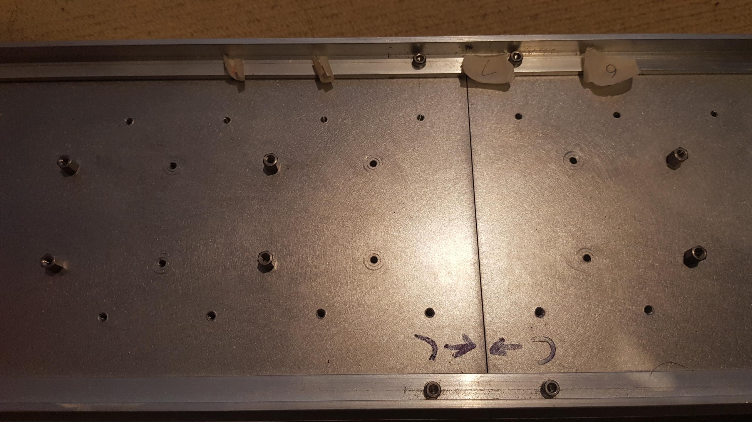

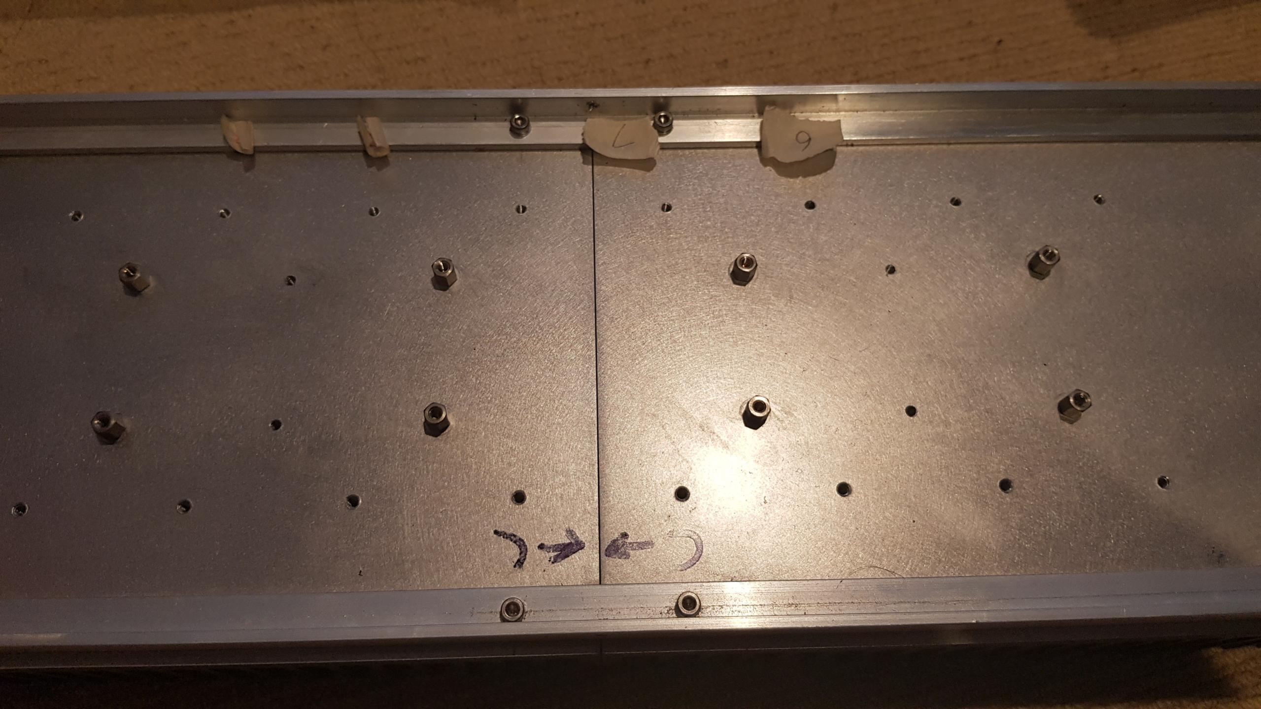

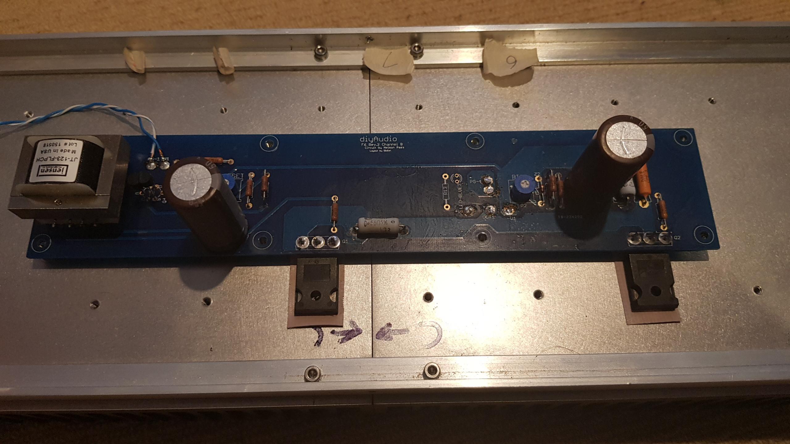

Keep in mind the chassis is going to have 4 drilled heatsinks
Yes of course.
I have a modushop 5U x 400mm with 4 drilled heatsinks.
This is normal.
A lot of people have complained about their F6 build on split heatsinks.
This can easily be fixed by adding an additional set of mounting holes so the mosfets sit symmetrically on the heatsink.
This is something that should be added.
I did this manually but I know others won't want to manually drill and tap a single hole.
I can add it on the drawing if that helps.

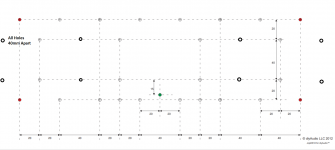

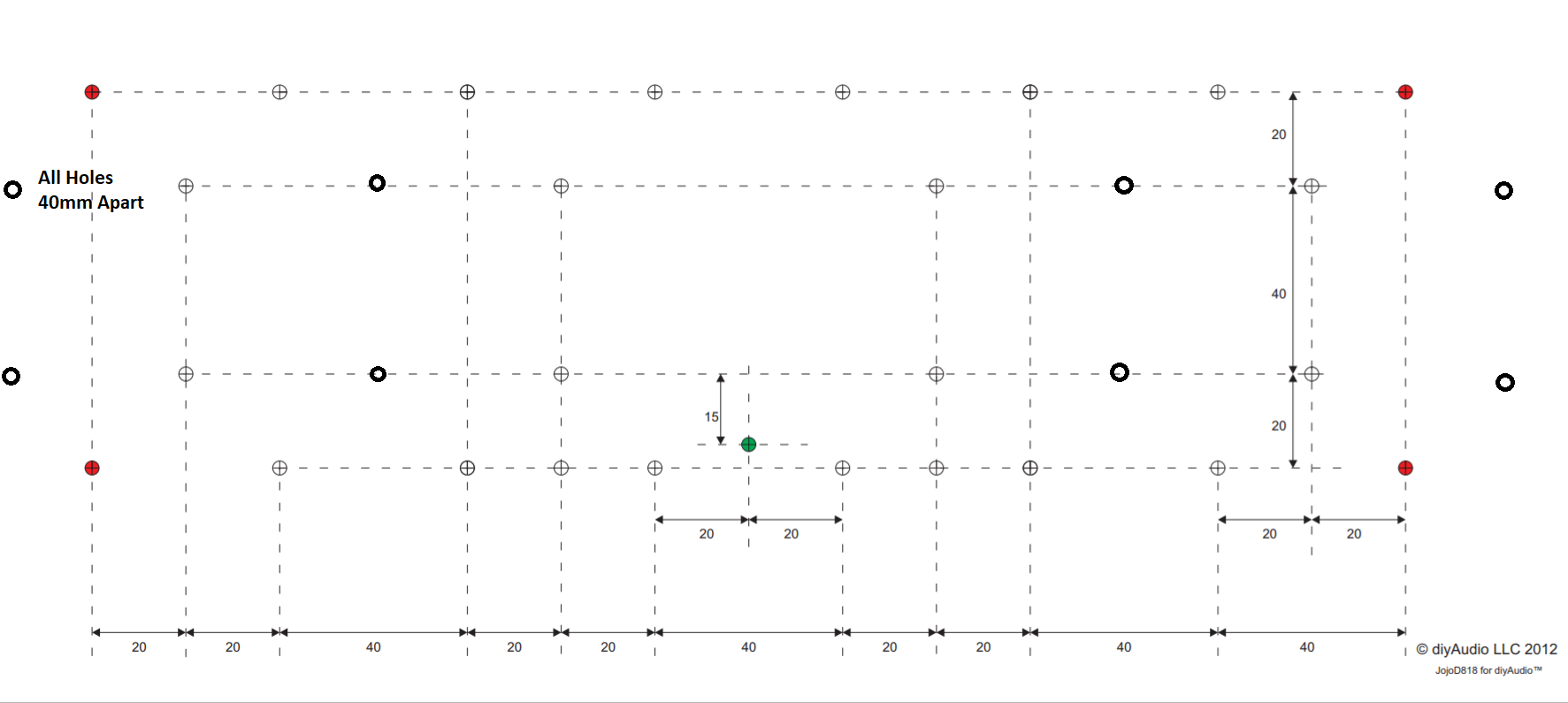

UPDATED Universal Mounting Specification
Hi Gianluca
Eight Additional Holes added.
All new additional holes are offset 40mm from original holes (equidistant). This will fix the mounting problem with F6, plus add additional options for longer future pcbs etc.
I don't have access to Solidworks right now so had to modify the existing drawing in MS Paint.
It's a very simple addition to the original UMS spec. Hope this is adequate.
All holes should be included (including the red holes) - the green hole won't be possible on split heatsinks so that should be omitted.
Hi Gianluca

G'day Pico,
Another Melbourne lad, great.
We were going to come up with a price for this to be a standard Dissipante chassis, that can be stocked in the store as a regular item at a regular price, rather than the extra costs associated with making a custom product.
This would mean no UMS, no extras.
It could also be offered with UMS heatsinks, again at a similar reduced "standard" cost similar to the Deluxe chassis, rather than a custom job price. This would require a 4Ux500 UMS pattern to be made canon. The UMS is up for a revision soon, but it's not something that will happen overnight (we're all flat out, thus this would be in the order of weeks or months of very careful deliberation and analysis of the use cases of many different designs).
If you are wanting a standard Dissipante, not a standard design that will roll out from here forward, but a custom hole pattern, this can be done as a once off. This is a third option, and would be a third price and it would be more expensive than if it were a standard item that will be stocked in the store from this point forward.
To proceed we'll need to know exactly what you want. The offset hole pattern you've suggested means it will be optimized for just the F6, which is fine, but people use the UMS pattern for many different designs (both now and in the future) which do benefit from having the pattern even on both sides.
Gianluca and I are quite interested in offering a 3Ux500 and 4Ux500 as a standard item, optionally as a Deluxe with the UMS or perhaps an expanded version of it, but I'd be thinking it should be evenly spaced on both sides of the split.
