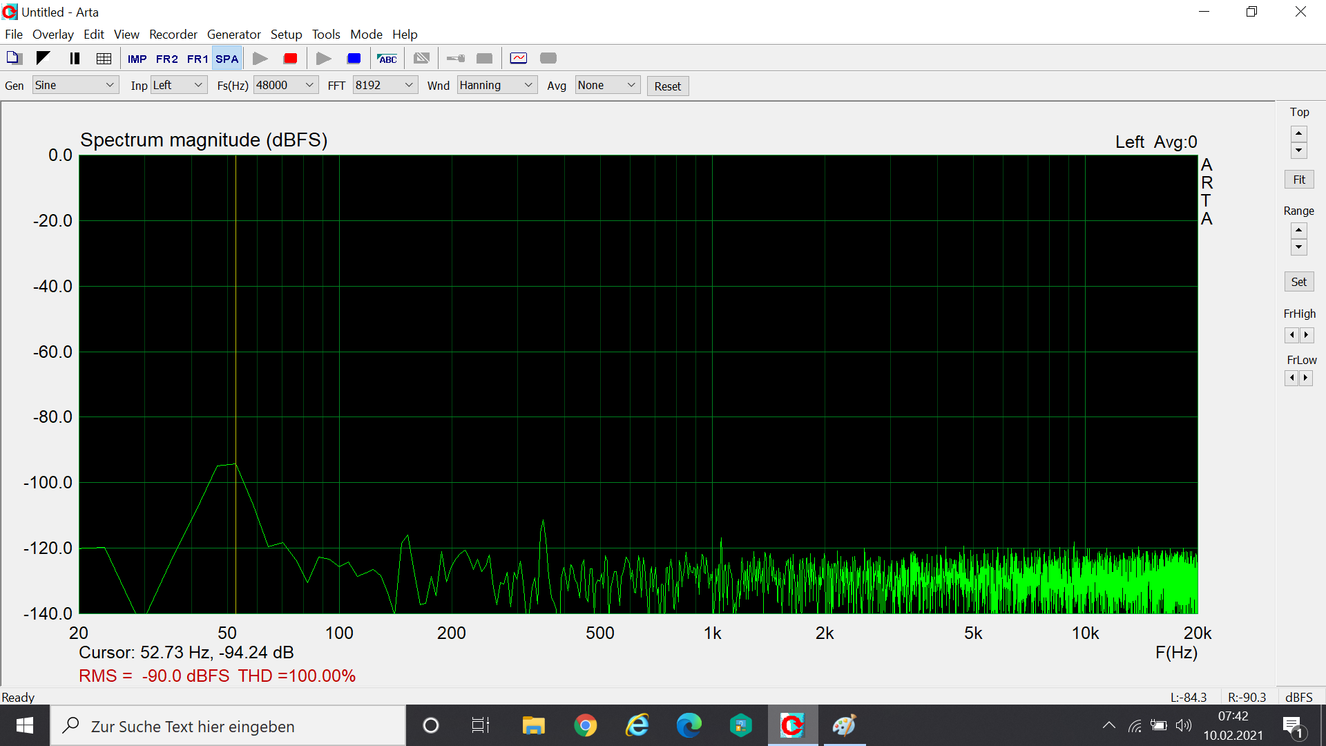

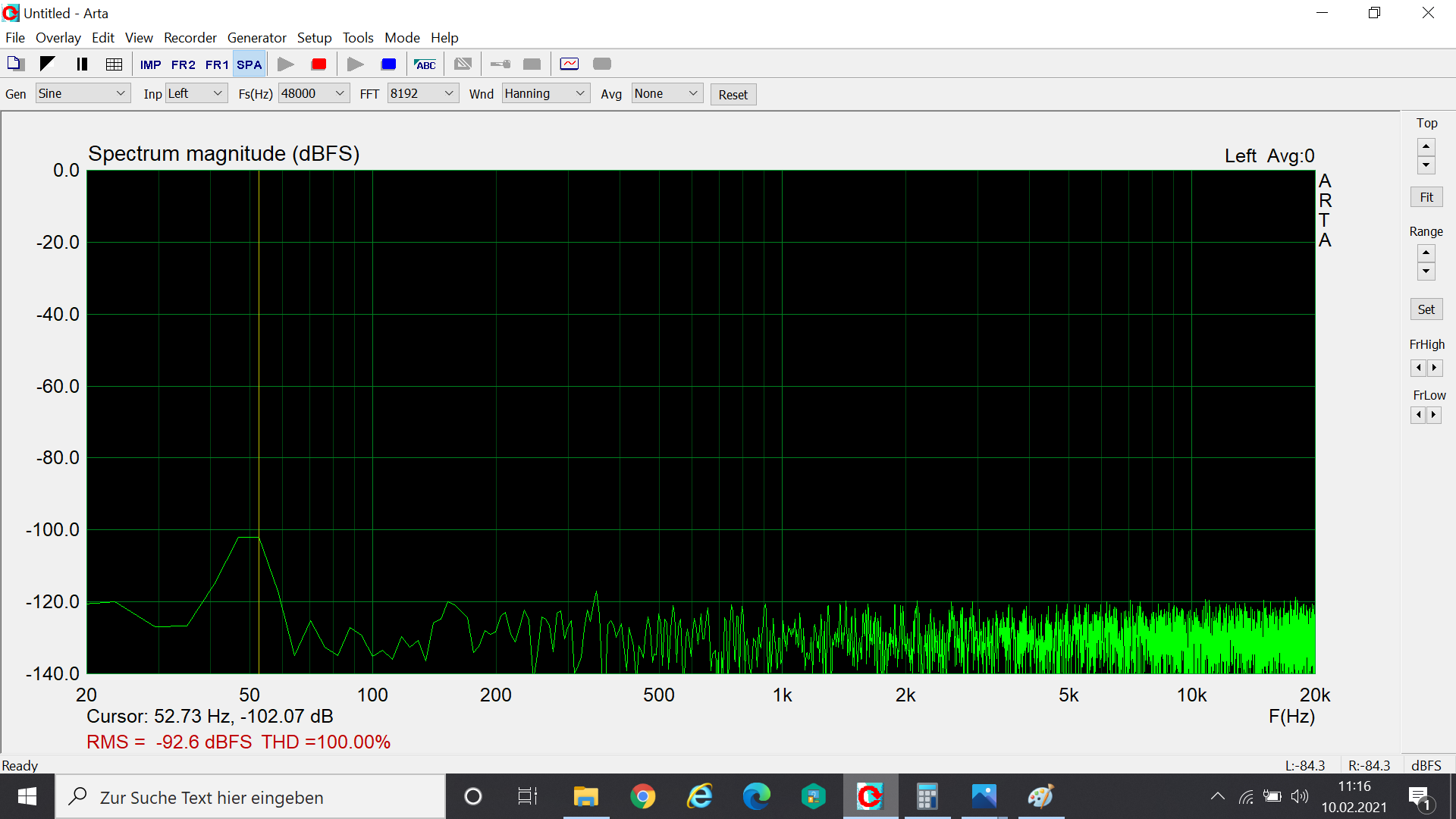

What I found so far:
- As there is little space between mains connector and the input on the gainstage, I put a iron shield of 50x80x3 mm inbetween, which gave me -6db hum. Noise is now 0,18 and 0,35 mV, which I cannot hear anymore.
- 100 mA Bias on the gainstage extends the distortion free range (I guess class A range, because current stays constant until that point) to 2 Volts. But my sinks are 75°C already. I will get bigger ones and bias even higher. Would be awesome to mount them on the rear plate, if that was possible.
- I already have the 50mm long heat sinks on the rectifier pcb from the shop and they run 80°C
- silicone isolated solid core wires get easily cut when wiring beneath (will round the edges next time)
