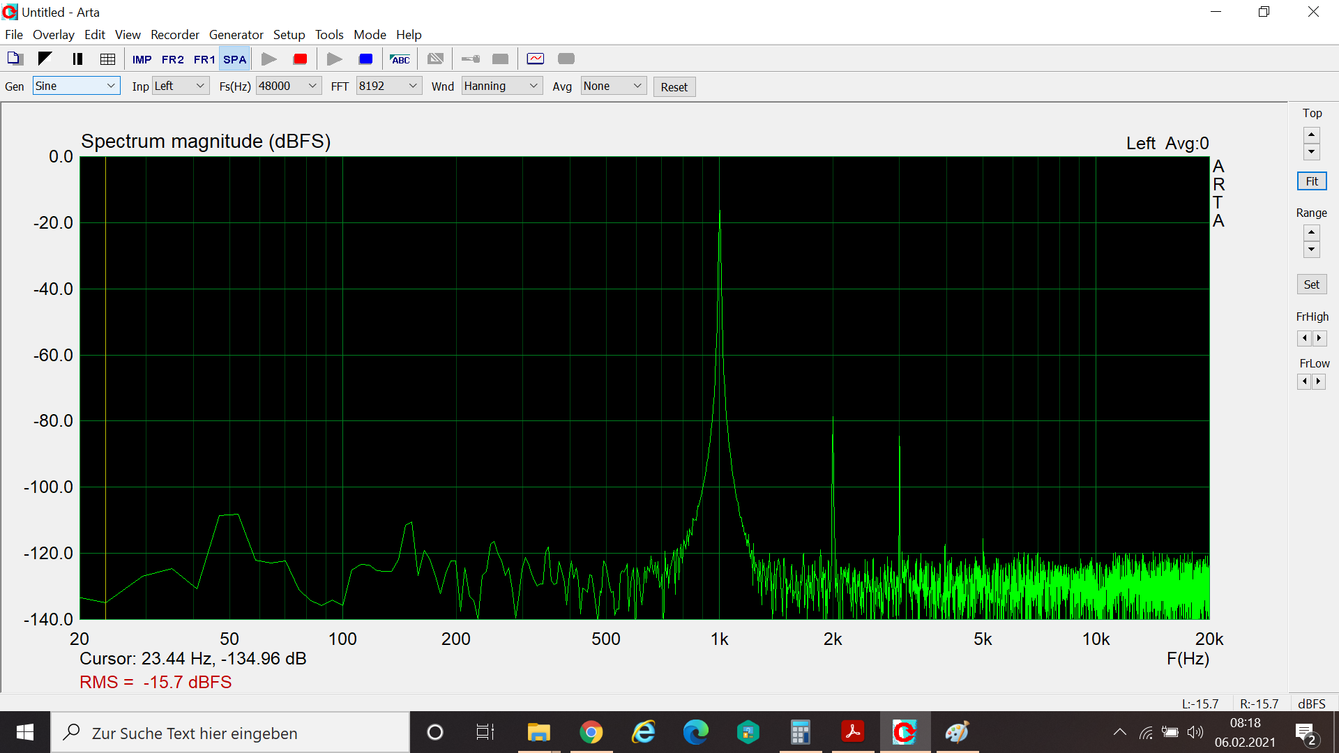

-Regarding ripple: I have to correct myself - it is 2.5 mV RMS at full bias (measured with Fluke 179)
- I used these chokes 10mH:
Blocked As the resistance is quite low I was afraid of a voltage spike caused by the high inrush current. But the softstart should have taken care of that. Although I will measure this later.....
- I did test with an old speaker and it was dead silent and sounding quite good
- adjusting distortion at the moment, which is a bit of pain as P3 does all kind of things on the BA-3 gain stage
- Soundcard is the awesome RME ADI-2 PRO FS and Software for FFT is ARTA Freeware: ARTA Download

I couldn´t resist converting it to stereo and give it a listen. Ohh boy there I am standing with goosebumps all over - best indicator for when things are right.
Yes I can hear humm up front in stereo and yes the distortion is higher than expected. But this result with my old speakers and without burn-in is very promising. I would describe it as relaxed and just real.

Hum could possibly due to radiated hum field or ground loop.
The ripple on the supply was good, so see if you can fix the hum issue.
Absolutely, Class A is where it's at.
Thank you very much for all the good advice. I cannot hear the humm from my couch and it is knocked down to almost inaudible in bridged mode with ears to the speaker that is.
Sooo what I will do is listen to this amp while building the other one and move the transformer further to the front panel, by drilling some extra mounting holes in the base plate, I will also measure the distortion of the gain stage before putting it in this time around. Maybe I will measure the matched JFets from the shop just to be sure. Any improvements achieved in the 2nd build will be adopted to the first.

You shouldn't be able to hear it at all.
My supply has 15mV ripple and it is dead silent with my ear next to speaker.
