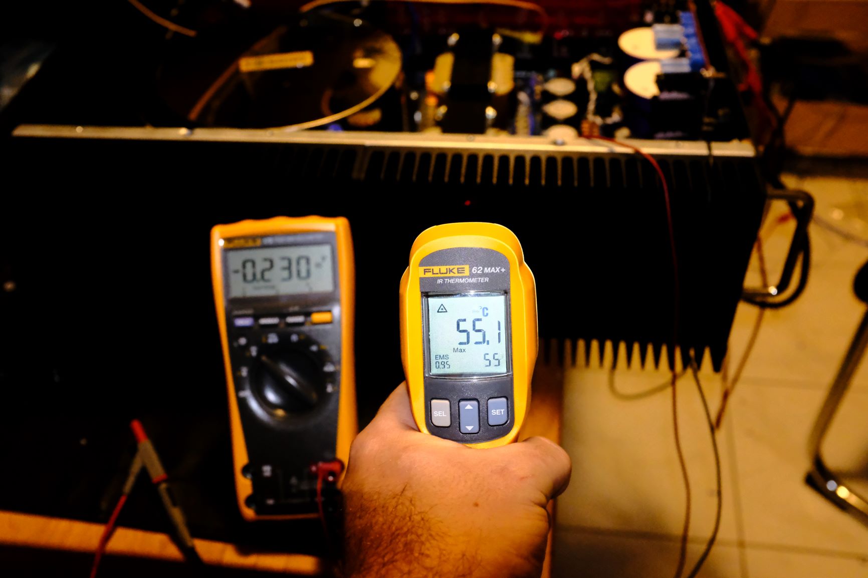

That was quick, well done - what amp is it? I assume that is 145 watts dissipation per channel?
Many thanks to Pico, Gianluca and everybody involved in making this happen!

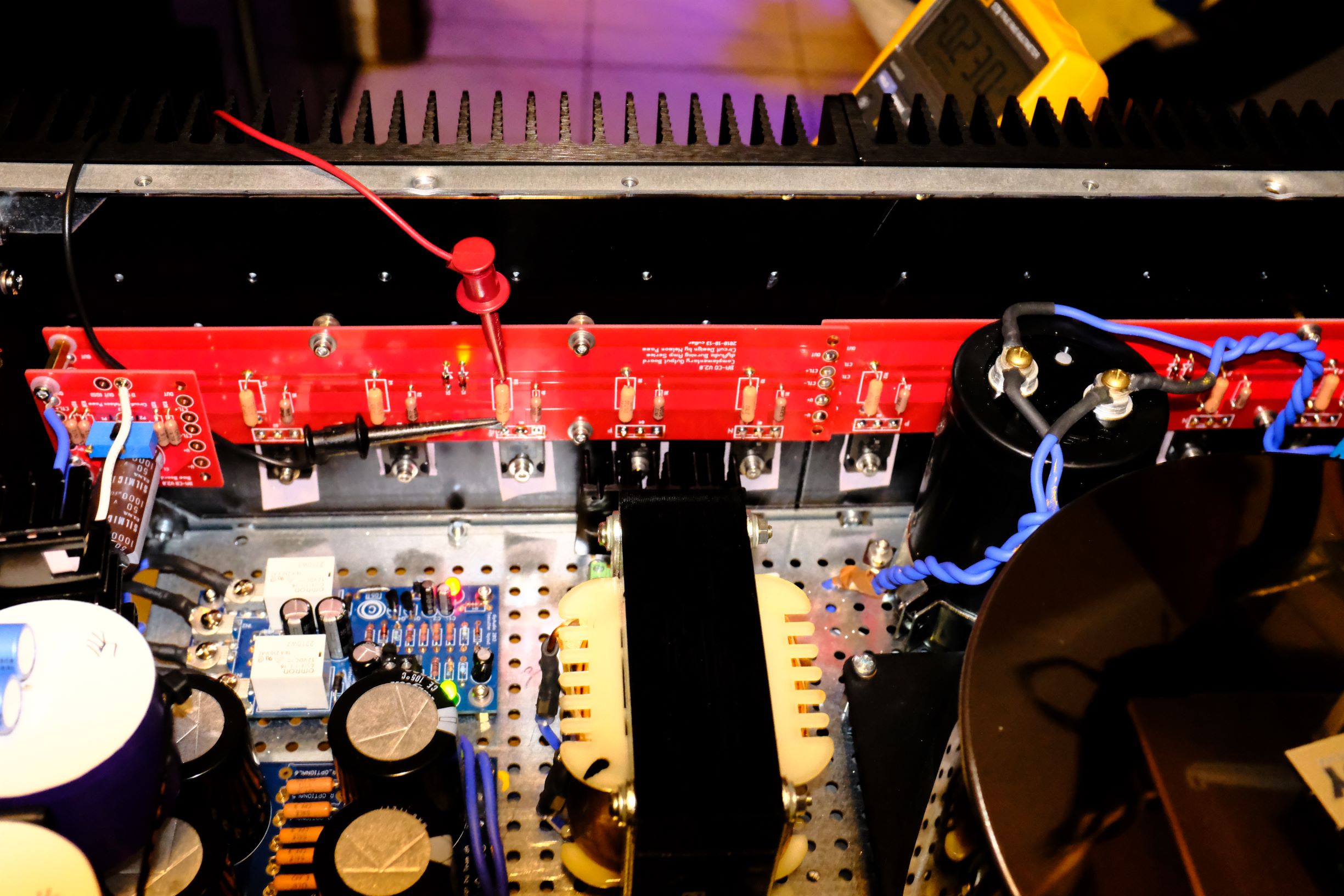

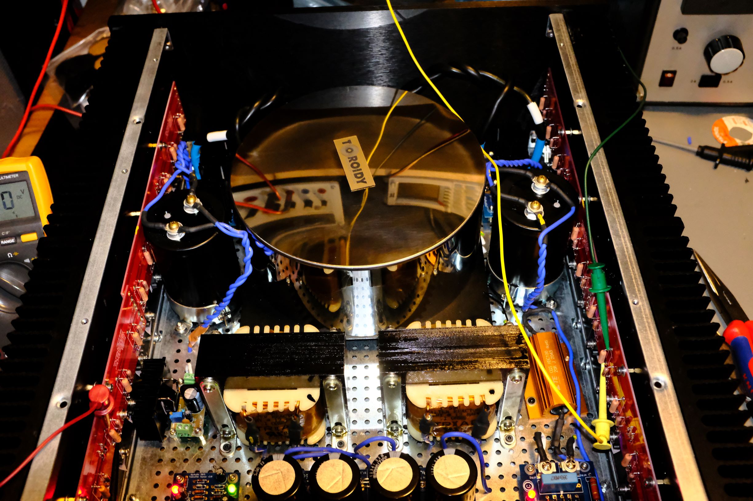

Got my first beast up and cooking. It dissipates around 290 Watts at 54°C heatsink and 23°C surrounding temperature.
Good work, you legend.
This is a BA-3B Monoblock and yes it is 145 Watts per half. I had the PCBs for this one preassambled. I still have to adjust for distortion and of course give it a listen. With all the masculinity I packed in that case, it got a little crowded at the rear plate 😀

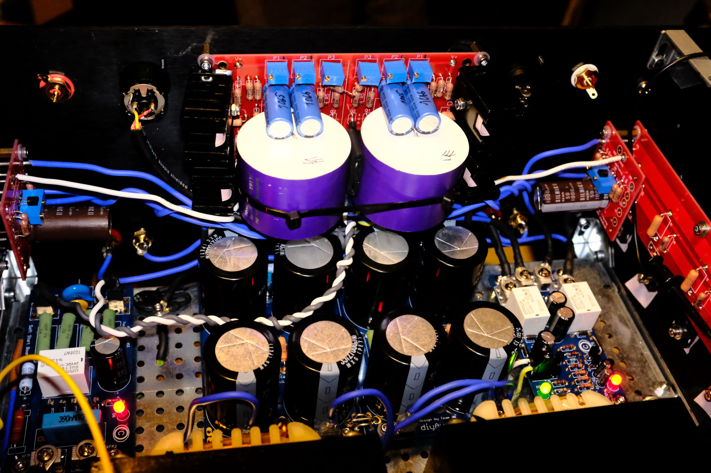

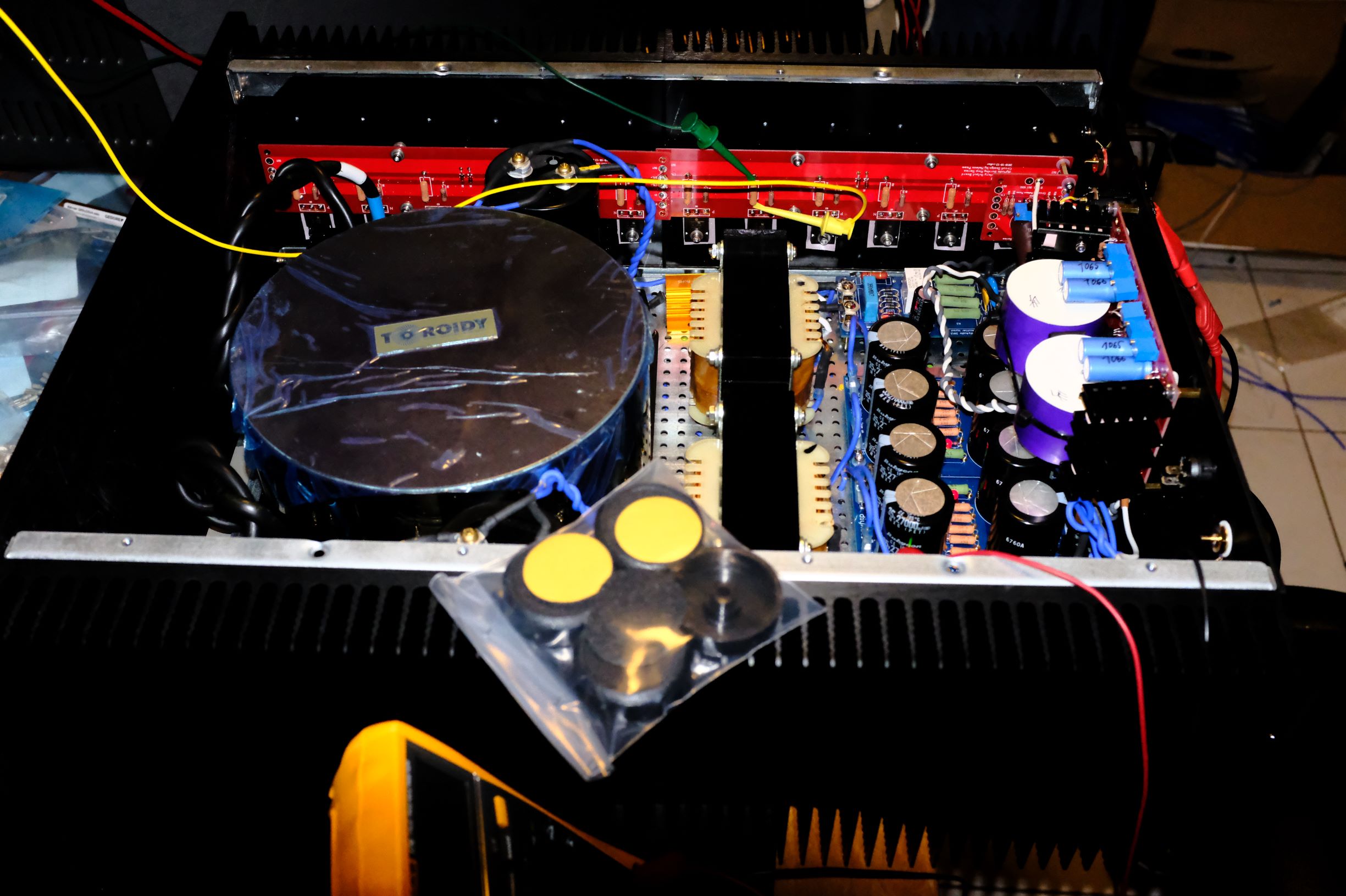

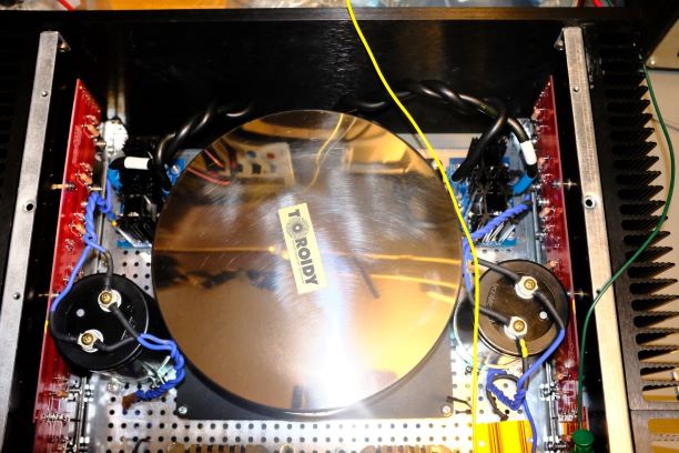

took some more pics.....
The scratches are fingernails blood and skin 🙂
Good work so far, you have been very busy. That toroidal looks massive sitting in there, must be 1kva at least. Also notice you are using a CLC supply with the two iron cored chokes.

- Transformer is even 2kVA (the price difference to 1kVA was negligable)

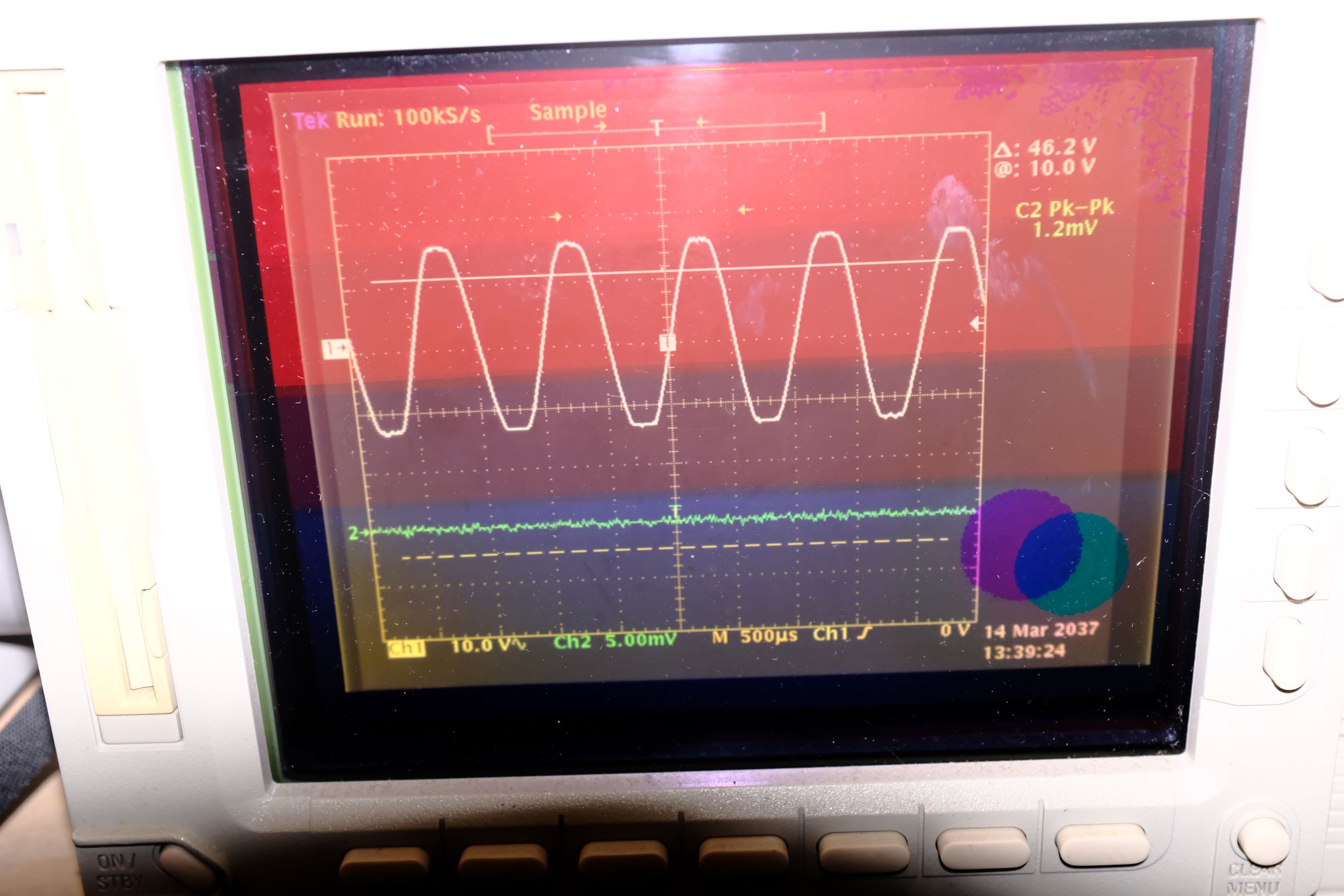

- Yes with the store supply it is CLCRC Filtering: 0.5 mV ripple. In the meantime I shielded the chokes.
- No listening yet but it starts clipping at 100 Watts into 6 Ohm in balanced mode
- Will measure and adjust distortion before listening

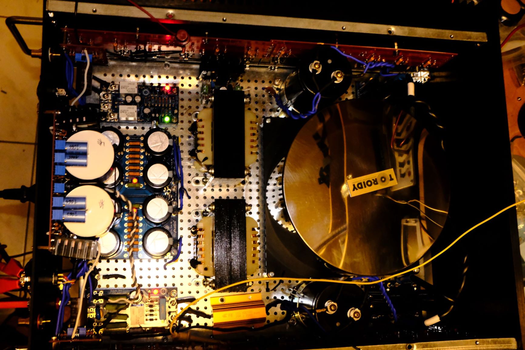

and more pics
I guess the 2nd Monoblock will be a bit prettier....
