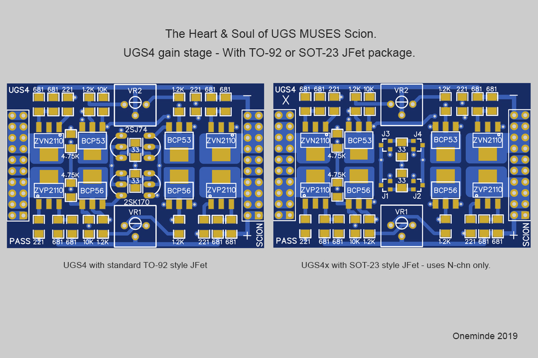

The Heart and Soul.
I started last weekend not knowing how to do proper schematics and PCB design, this was something "magical" others are able to do, but not me. But with some persistency and a pinch of determination, anything is possible. So here we are with the heart and soul of the UGS MUSES Scion preamplifier. We are now officially leaving behind the UGS used in the prior versions and entering an era of using an official PASS LABS UGS gain stage. Spite it being a few years old, it now uses MOSFETs at the output instead of BJTs. It also feature 1206 SMD resistors like I wanted.
As you can see, there are two versions of this gain stage. The normal UGS4 which use the standard TO-92 style JFets... for the hardcore Toshiba 2Sk170/2SJ74 users. For does who are a bit more adventitious there is the SOT-23 version called UGS4x which uses surface mount and N-Chn only, so no need for complimentary N- & P-Chn JFets. Designing the SOT-23 card also future-proof's the preamplifier for when the market run out of the original Toshiba JFets. I will do tests with both cards and report back.
With the gain stage designed, I can now move on to the motherboard, PSU and MCU portion of the preamplifier.

I changed VR1/2 to multi trim pot instead of single turn. Allows for better DC offset adjustment.

waw,it is amazing,It's moving so fast.
for the VR1 and VR2,if we change to use multi turns should be better.but in my memory,this kinds of footprint only have the single turn
Best Regards
Leo
1 ). Yes, PASS use single turn only which I suspect can be a bit "rough". The new multi turn is Bourns 3296 series which has 25 turns.
2 ) If you look up On Semiconductor 2Sk3557 and look at the Id-Vdss chart and compare that to the 2SK170 and 2Sk209, you will see which one is the closest 🙂. Not only that, but the 3557 has a nominal 1dB noise figure compared to 2SK170's 0.8dB.

N-channel JFet's conduct in both directions - so the UGS4x only use N-chn by flipping the drain and source for one side (mirrored) 🙂GOT it,but what is replacement for the 2JS74? still have good choice for that?
