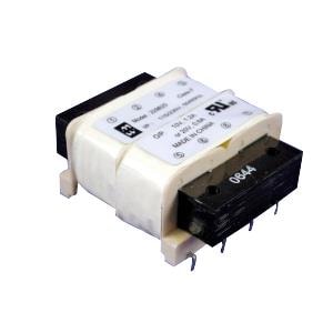

I thought about separate PSU cabinet, however, using R-core (which in itself is better shielded than a ferrite core) together with the shielding and potting should be enough, after all, the transformers will be housed inside their own compartment (Faraday cage) in the front or close to the front of the unit and should provide an equal amount of RF and EMF shielding as a separate unit. The amp side will only be exposed to DC. The incoming AC line will also be shielded from the DC side in a similar manor. That way, the whole preamp is one unit which save space.
Panasonic offers the TX2-5V relay as SMD in the form of TX2SA-5V. The main reason I am considering SMD is to bring all the components over to 1 plane and in so doing create a pure gnd plane underneath. I am just putting out the options.

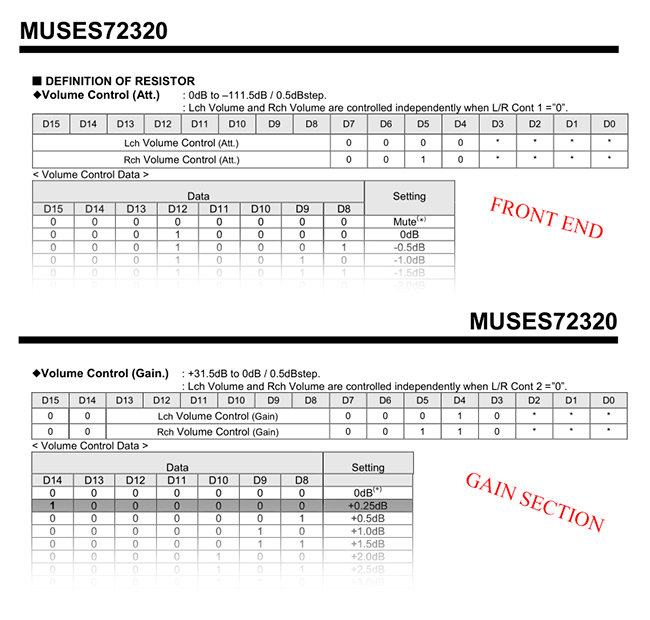

MUSES front end.
I was looking through the Stereophile review of the XP-30 and read something that puzzled me for a bit.
So I opened the data sheet of the MUSES and sure enough, there are two distinct functions. One is attenuation and one is gain. Meaning one can use the chip to only attenuate the volume which is at full gain when the attenuation is 0dB. The gain is (assuming) a OP-amp stage, which effectively is its own gain stage or secondary amplifier - that is a big no no since it most likely mean you have one type of gain stage up to 0dB and another gain stage from 0dB to 31.5dB. And I am sure they have sonic or musical differences.I run the NJU72320 on ±15 volts so it has a large overload margin. I really like this part as it has no op-amps in it—I only used the front, attenuation section of the chip and not the gain setting section.

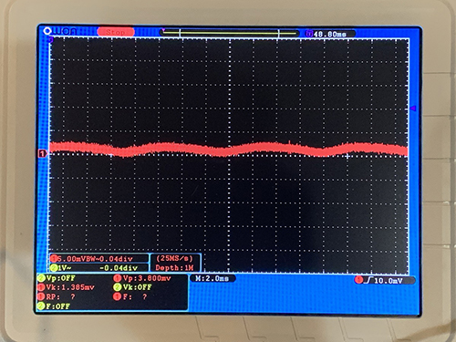

Smooth Like Butter (SLB): This is the SLB Class A power supply with active bridge rectifier, a CRC filter, a capacitance multiplier (CFP topology) with built in ground loop breaker NTC and star ground hub. The standard SLB provides a dual rail system that provides up to 5A (tested) with only 1mV rms ripple under a 4A load at 37v output. Use of the LT4320 active bridge and low RDSon MOSFETs as the rectifiers means that there is almost no heat generated in the rectifier (a traditional source of large amounts of heat under heavy Class A loads). The active bridge also switches at zero crossover thereby minimizing noise generated by the rectifier. A carefully engi-neered CRC filter requiring only 2 x 15,000uF bulk caps followed by a complementary feedback pair (CFP) capacitance multiplier (Cap Mx) takes the traditional 100mV rms ripple CRC PSU down to in-audible 1mV rms ripple. You will hear the blackest of blacks in your amplifier’s background now. More details of the SLB can be found on DIYA.
1. Almost no heat dissipation or loss through the rectifier.
2. Improved voltage headroom since no 0.6v drop across the silicon rectifiers
3. Smoother inherent ripple from the rectifier since switching is active and time phased to occur at zero crossing
4. More compact since fewer and smaller bulk caps are needed
5. Lower overall cost since fewer large bulk caps are used (and we all know this is one of the most expensive parts of a Class A amp aside from the case)
6. Most importantly, improved performance relative to a traditional CRC supply with lower ripple and higher current capability.
7. as icing on the cake, the SLB provides a smooth slow ramp up to prevent mains current overload and tripping fuses, plus, it eliminates turn on speaker pop.
This unit averages 1mV rms ripple under a 4A load at 37v output.
That is a superior start, and since this preamp is working in the mW range, this rectifier and ripple rejecter will not break a sweat. It will barely work at all. It will be paired with Hammond Manufacturing 229D series split core transformer. The PSU will be operated in mono configuration, each channel will use its own PSU and transformer. The MCU or controller card will only use a transformer and voltage regulator since no audio signal will pass in that unit - the AC/DC conversion for the MCU will take place in the PSU enclosure such that only DC is present in the amplification unit.
