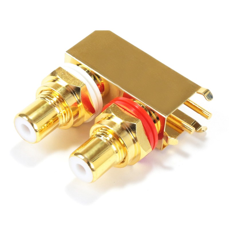

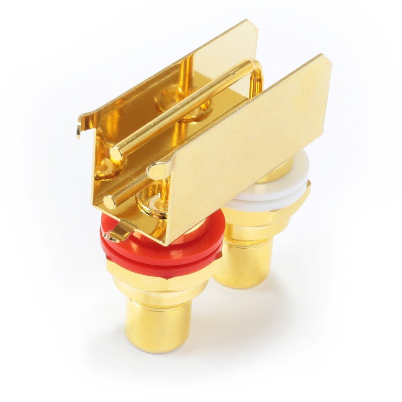

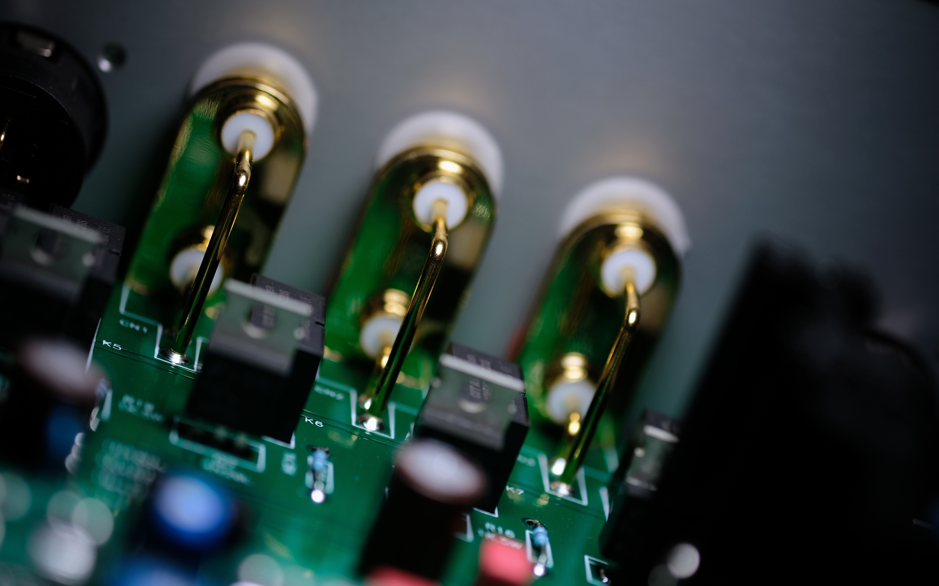

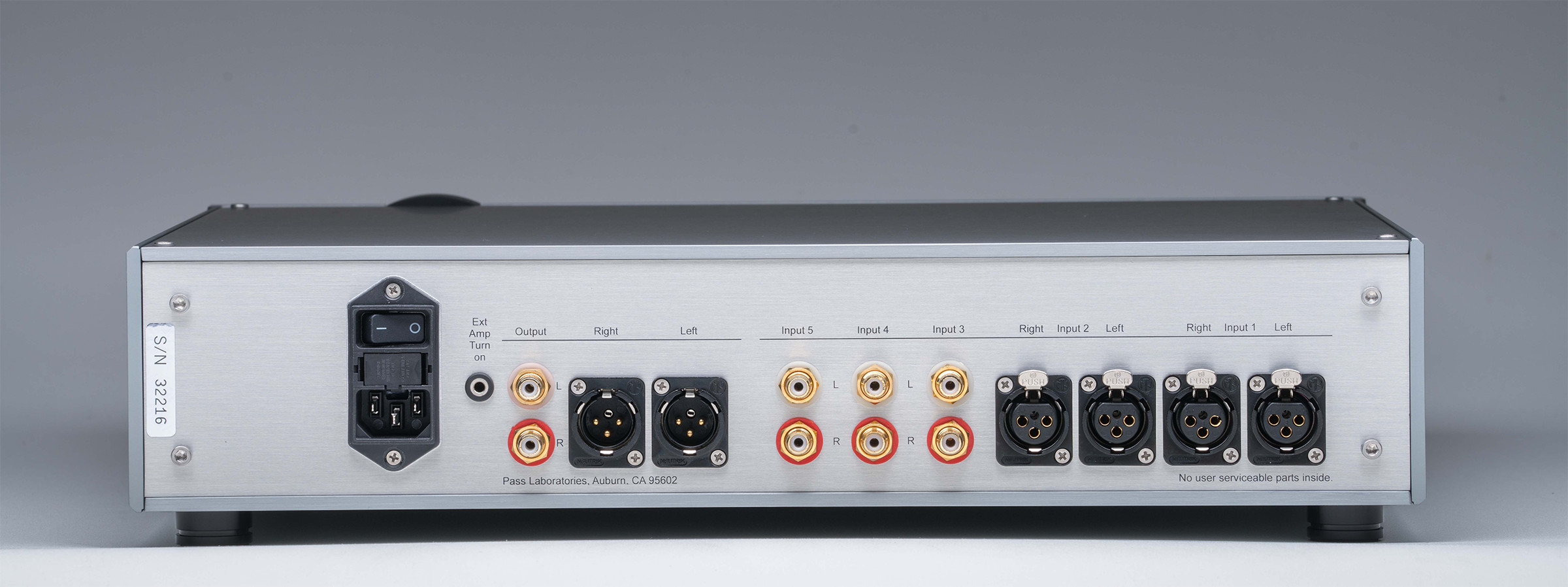

Searching the internet for a while to find the RCA connector used in the XP-12 ended up at Cardas GRFA DBL PRT G. They cost $25/pcs. Cardas is market as esoteric audio, so the price is a reflection of the branding.
Another solution comes from a French company called ELECAUDIO and offer a similar product (stacked connector for PCB mount).
This ELECAUDIO ER-110 RCA stereo socket is particularly suitable for PCB mounting. It has a special design with two long, angled contact pins and 3 fixing tabs, making it easy to mount on a printed circuit board. In addition, this base has a good manufacturing quality, with gold-plated copper alloy contacts ensuring good conductivity and excellent oxidation resistance as well as PTFE insulation.
Spécifications :
XLR

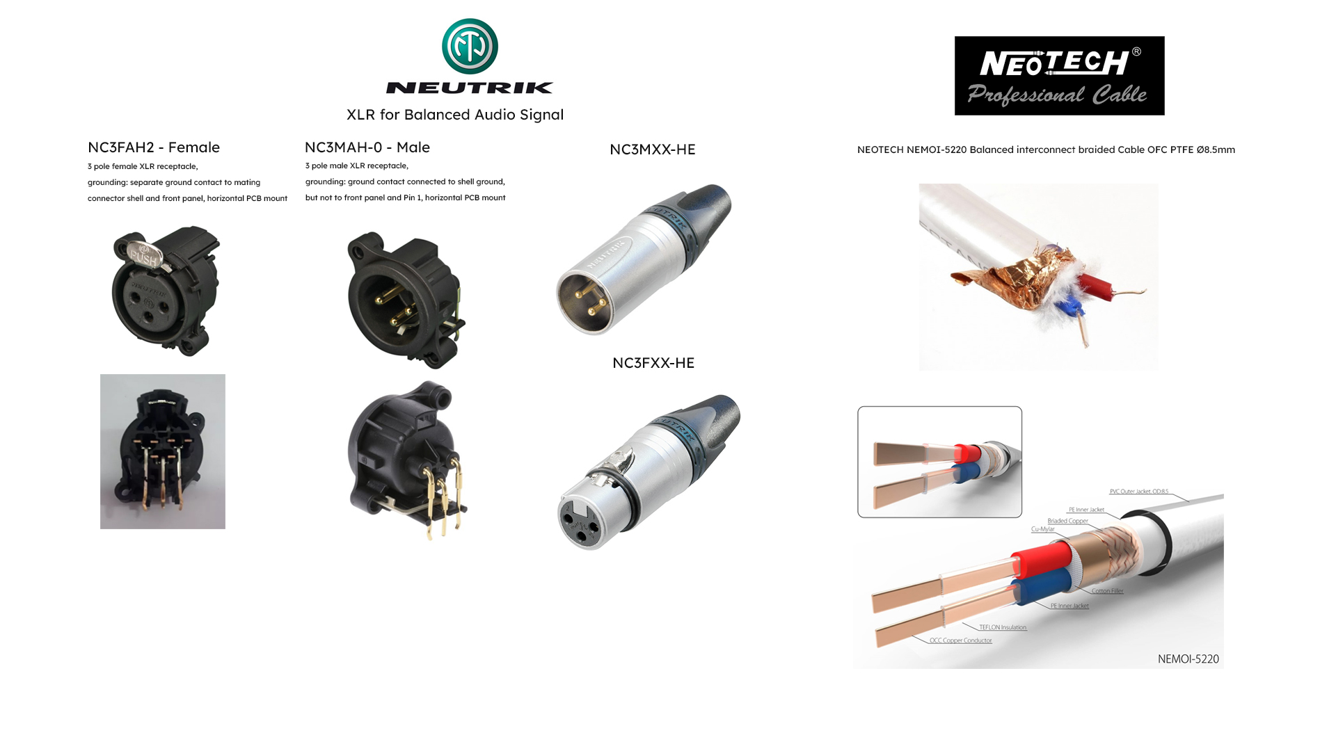

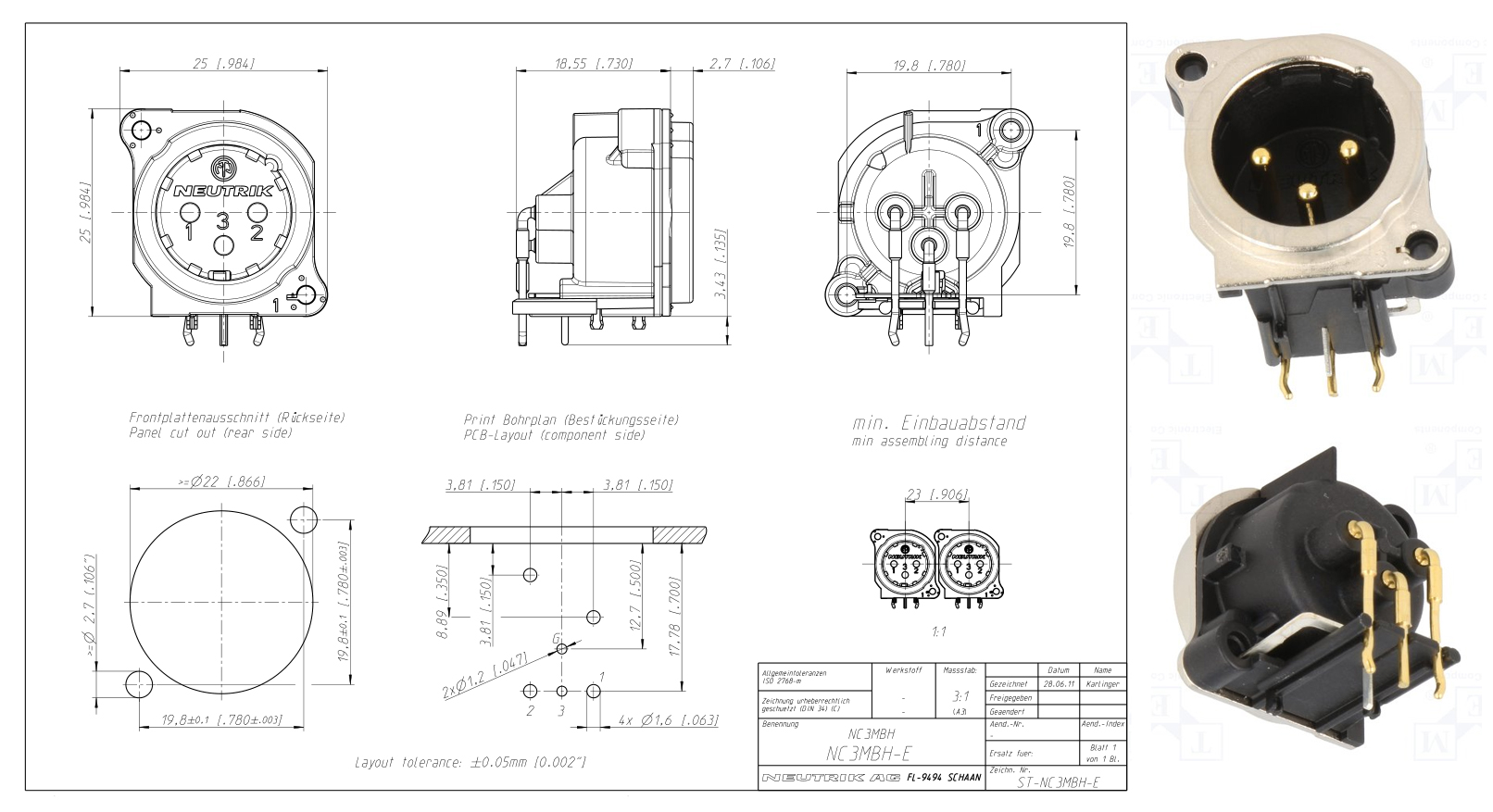

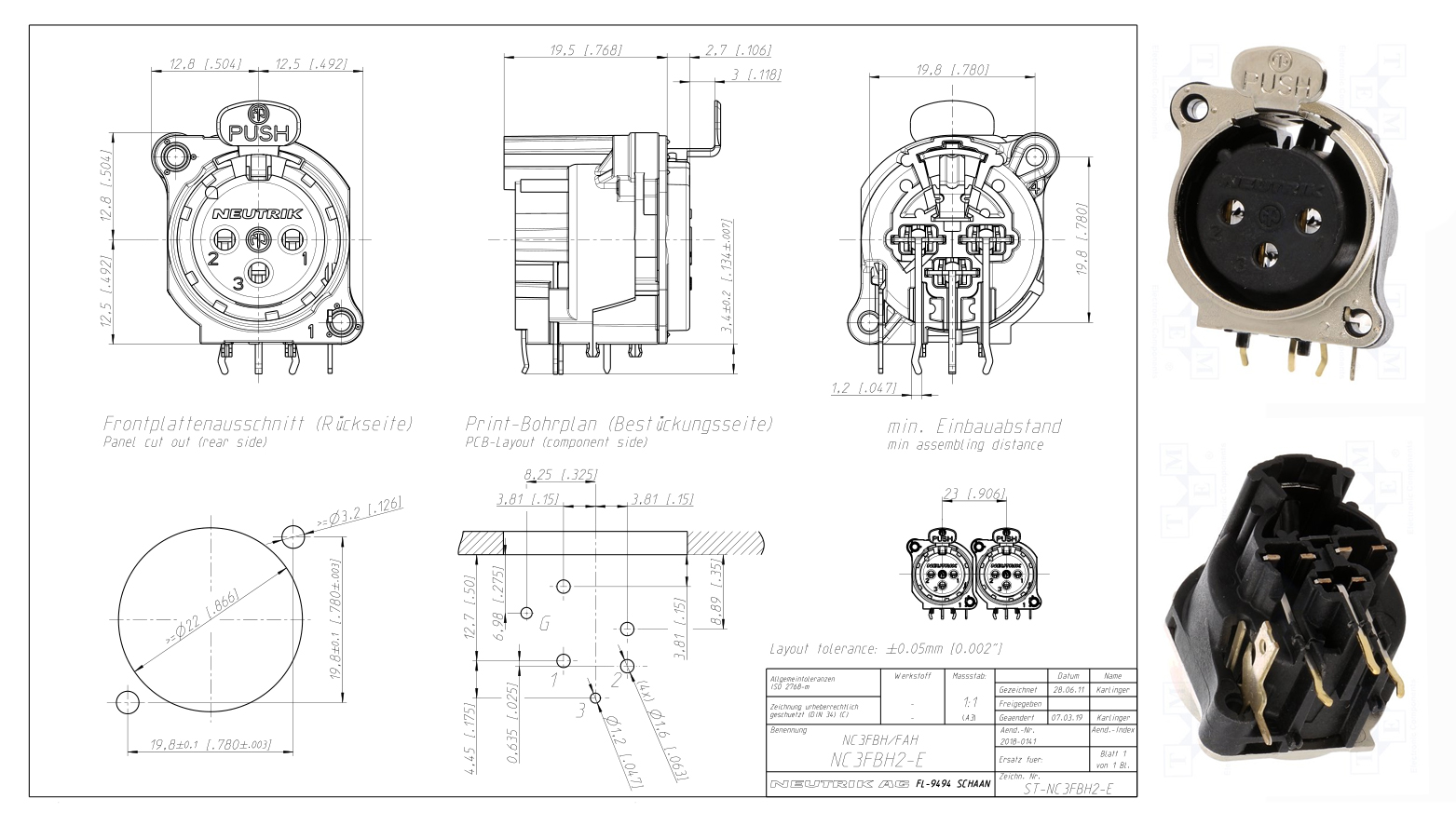

UGS MUSES uses Neutrik NC3FAV1 (female-IN) with 1+G, common ground, and Neutrik NC3MAV (male-OUT) which use separate ground. PASS XP-12 use Neutrik NC3FDM3-H (female-IN) which use separate ground, and Neutrik NC3MD-H (male-OUT) which use separate ground. Original UGS MUSES uses the rear mounting style which I prefer while PASS uses external mounting which I do not like. Its just a matter of visual preference, that is all.
When it comes to the models I have selected, I am taking it a step further:
If we do like the XP-12, then we have 5 inputs ( 3 pcs RCA and 2 pcs XLR) and 2 outputs (1 pcs RCA and 1 pcs XLR). I like that and it should be enough for most people.
Spécifications :
- Type : Stereo RCA plug
- Contacts material : Copper Alloy
- Plating: Gold
- Insulation : PTFE
My mind right now: Cardas or ELECAUDIO or Cardas or ELECAUDIO or Cardas or ELECAUDIO or .... LOL - ELECAUDIO ER-110 has better support and is $14 compared to $25 for the Cardas. Perhaps that is all the arguments I need.

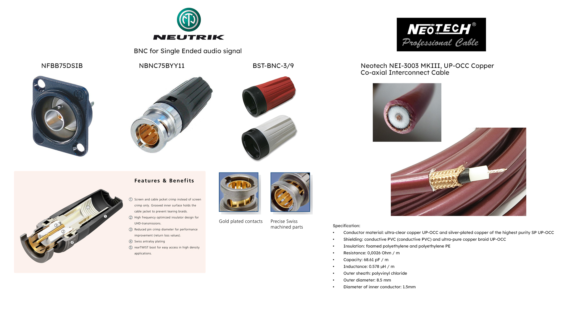

If budget is no object why not eschew the wretched RCA connector completely and use gold plated BNCs or similar? Ground connecting before signal is so much more civilized. You can get gold plated RCA-BNC adapters.
Sure, I can consider BNC instead of RCA. After all, professional audio use BNC instead of RCA. Why RCA has maintained its wide dominance for home AV equipment is beyond me. The one thing that "worries" me is difference in resistance between an RCA and BNC. I see BNC has primarily two resistance values, 50 and 75 ohm. Producers of RCA connectors typically do not mention impedance for RCA connectors.

I then spent some time going over Cardas and Neutrik and indeed, contact material is brass or phosphor bronze. A quick search XLR which use copper as the contact material and EIZZ and Viborg pop up as alternatives.Hello,

I've had some time to consider the signal infrastructure since Mark Tillotson commented using BNC instead of RCA is better. Since I will build most if not all of the audio equipment, I can just go ahead and select XLR & BNC as the only connectivity I will use, but keep in mind that this does not affect you who which to build a UGS MUSES Scion preamplifier. We will move forward with panel mount connectors only, meaning you are free to choose BNC or RCA and model / manufacturers at your hearts content. The motherboard does not care. 🙂
I will collect some info on my personal choices for the XLR and BNC and publish it in a post soon.
