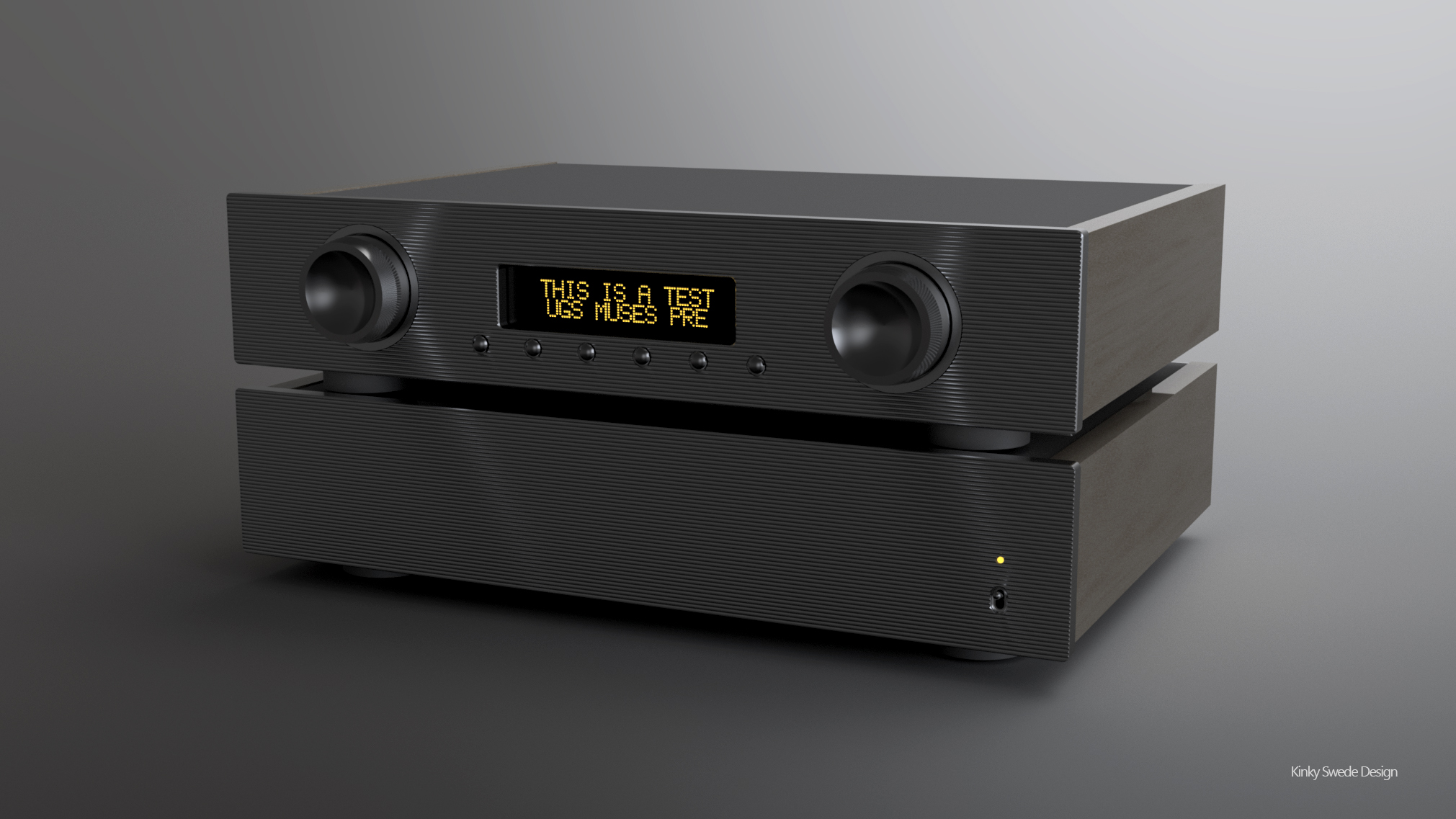

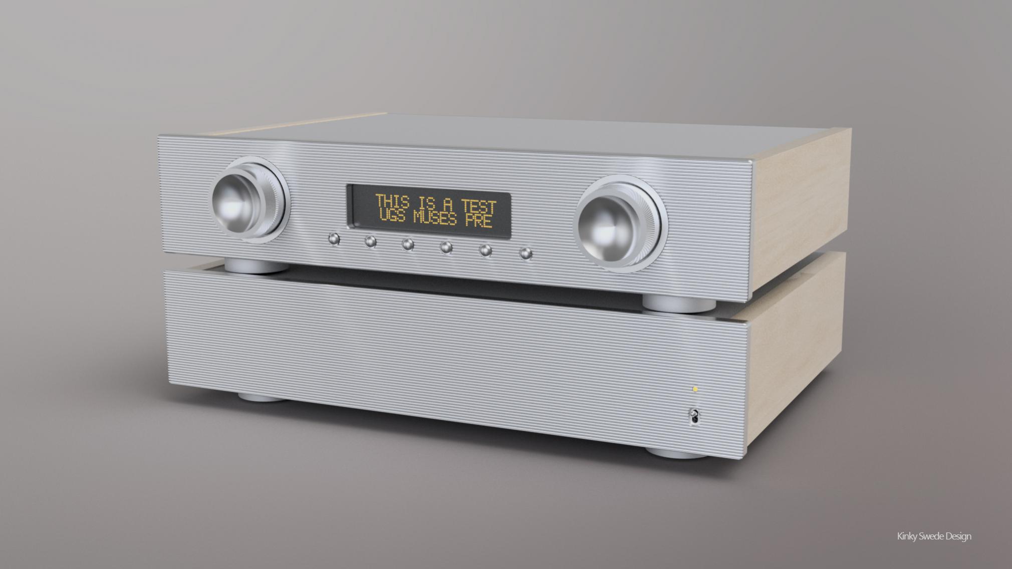

Thought I would share my design which I did last night for the original UGS Muses.
Found some inspiration while surfing the net. The ideas for the volume wheel will carry over for that smooth feeling, the rest is true to the UGS Muses.
pay attantion if you want to use 2 OLED displays, the display will get bigger...
i think your rendering reffers to use only 1 display.
That is the plan, to use the Noritake VFD - added an orange effect since I want that (gel film)pay attantion if you want to use 2 OLED displays, the display will get bigger...
That front panel looks gorgeous! The 'gun barrel' gray set is beautiful.Thought I would share my design which I did last night for the original UGS Muses.
The "gun barrel" gray is an effect of low light + backlight to show the display an power on led. So not an actual color 🙂That front panel looks gorgeous! The 'gun barrel' gray set is beautiful.
I'm still torn between using American Black Walnut or Ash.
