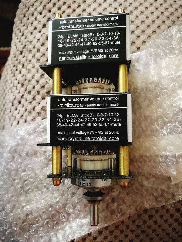

NAGRA use this approach in their preamplifier, a nanocrystalline core and voltage taps situated around the core. See attached images.

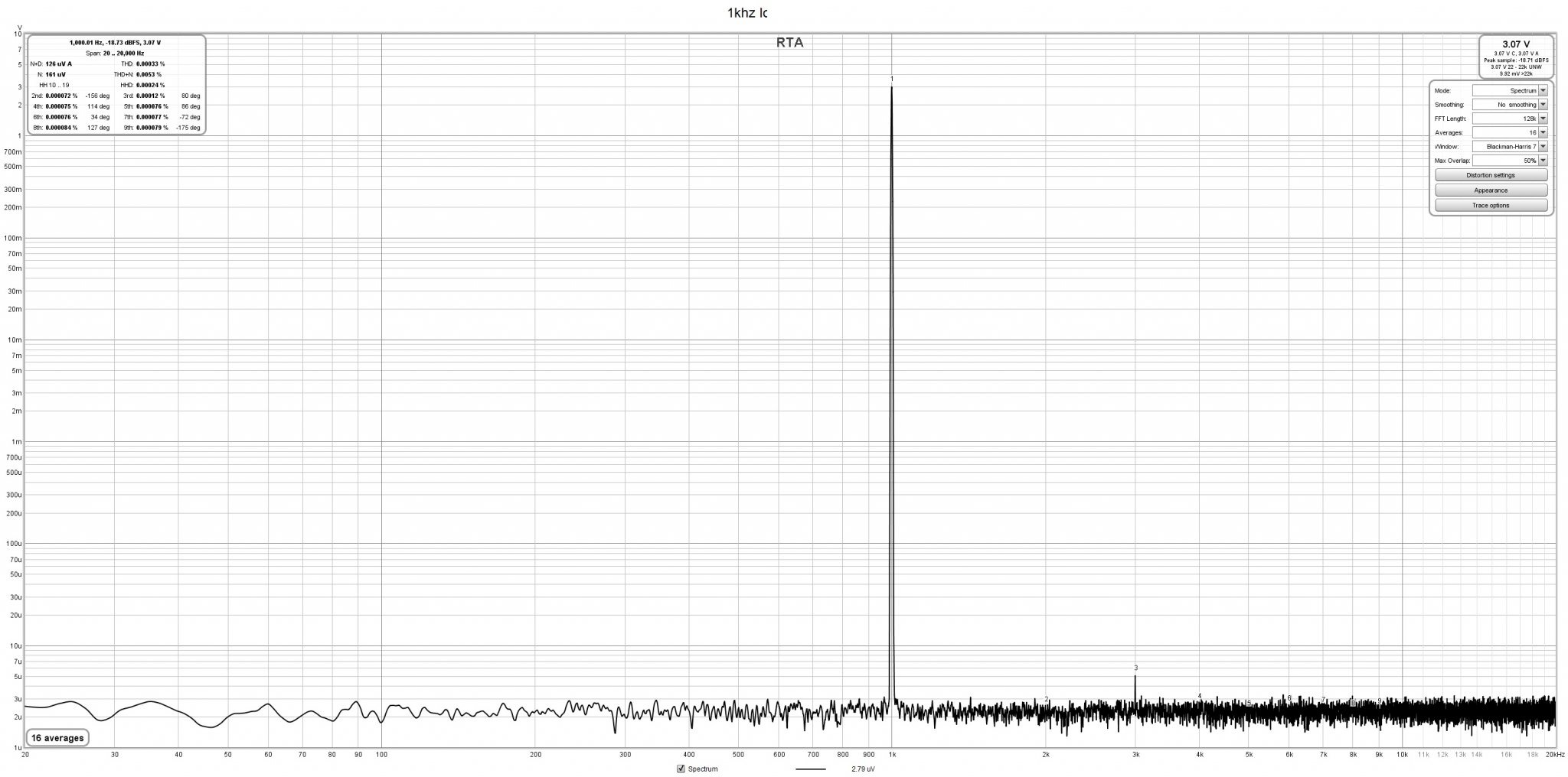

In my ugs preamp I have a cinemag wired as a autotransformer with 6db gain. It was inspired from ZenMod IP.
Both the ugs and the cinemag version sound very good, I can't decide between them.

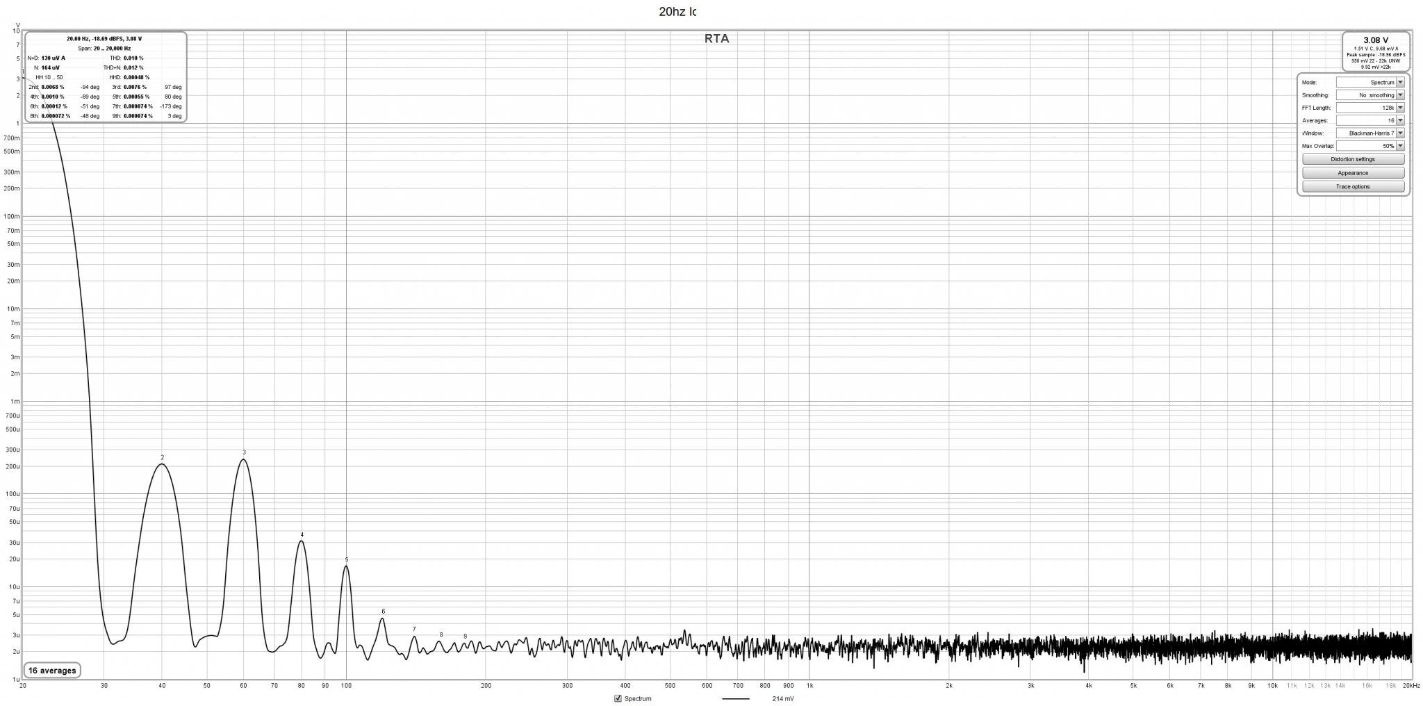

When fed with low frequency(20-50hz) and high level signals the autotransformer behaves a bit worse than the ugs because the core stars to saturate.
Being able to convert bal/se to bal/se, the sound is good, it is also very simple and most important doesn`t used unobtainable parts so I thought about trying better cores for the autotransformer. I want to try the AMCC016A and wind my own coils like you, 1+1:1+1 for 6db gain exactly like the cinemag(to be able to compare them).
These cores are big but are good if you want to drive a power follower and want low thd at low frequencies. For line levels a smaller core will do.
For me at this moment winding those transformers are only future plans and I need to learn first how to wind them...
