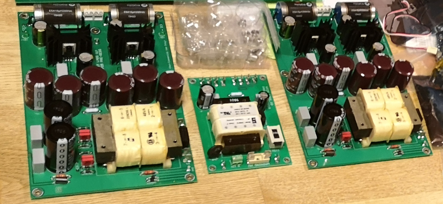

That Hammond will need it's own pcb, since it meant for pcb mount. But sure, you are aware of that 😉 ? Much easier to use a toroidal or C-core meant for chassies mounting.
J.R
I am aware of the construction. Is or was considering an enclosure and potting it (which would allow for a conventional mounting) 🙂 .. well see what happens I guess. First need my boards and it feels like they are stuck in limbo, no shipping update since the 28/7 ..

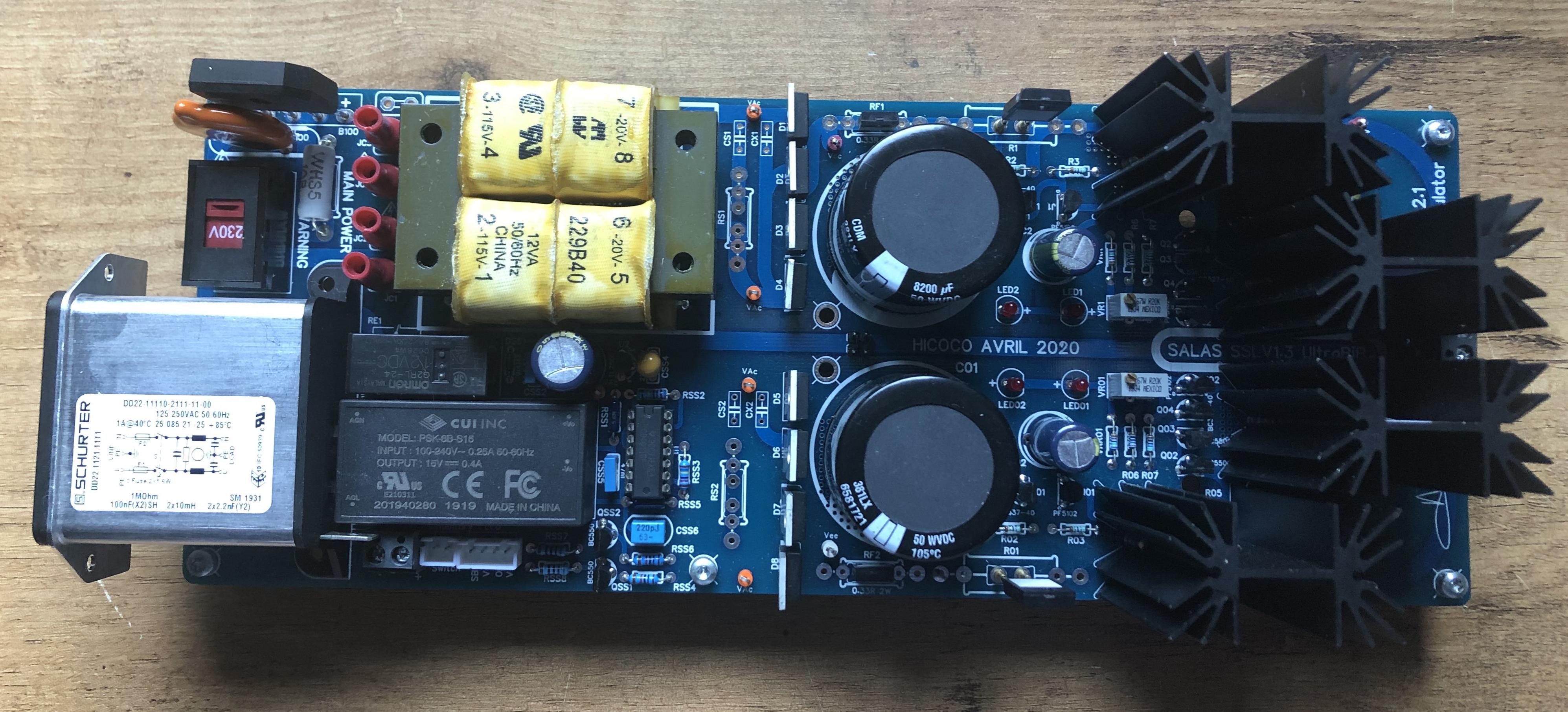

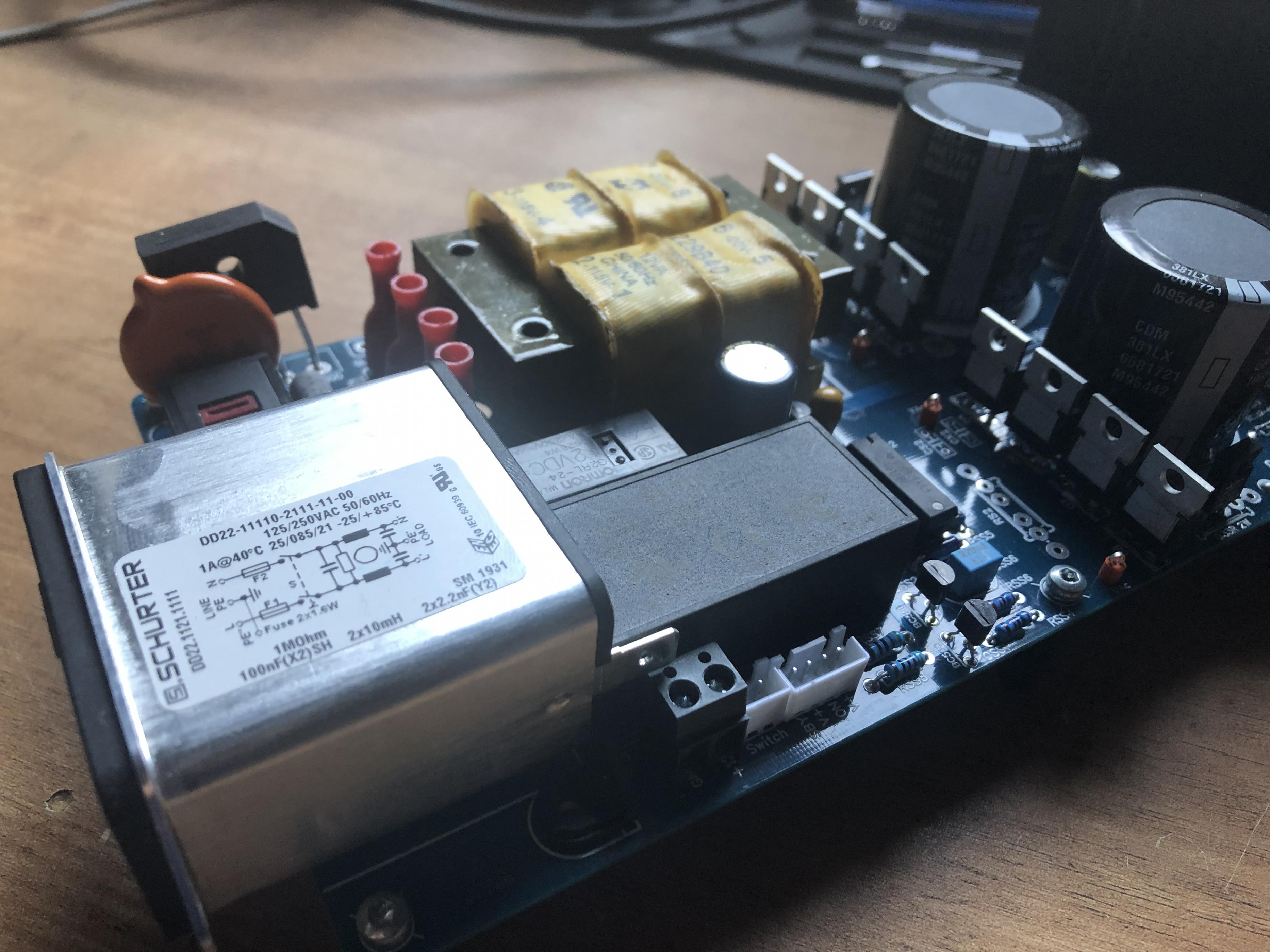

I just finish and tested this new board with a 2X20V , 12Va 229B40 Hammond, will use it for the new UGC muse preamp with 2X28V, 12Va 229B56 Hammond.Hi,
J.R
that is an adapted Salas UltraBib with on/off.
yes i did and i am not sure if i will use it, i prefer this combo with transformer and also i can connect to it other boards
