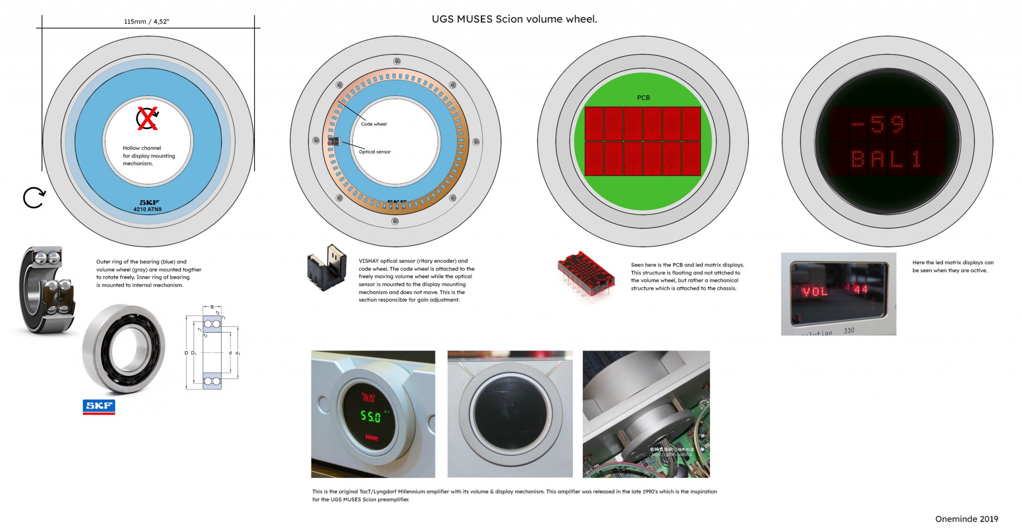

Good morning everyone. Got an update for you all.
Lets see if double row have the same feeling when I have one in my hands.<contact@steinwaylyngdorf.com>
Thank you for your enquiry.
The bearings used for the volume control in the Millennium is not SKF double row. Two single row bearings are used. We still stock these and if you want them changed you can send the amp for service via your nearest Hifi Klubben shop.

I wanted to ask something in past but I forgot.
Do you want to use also a remote with this preamp?
Also to mention that de display you want to use is not a direct replacement with the ones(vfd or oled) used in the ugs muse so you will need to write your code from scratch. I wrote a few messages to Alex but never got a reply.
Yes, the preamp will have a remote. In secret, I have been considering making the remote in the same style as the volume wheel ... The ultimate fidget toy ... 😆. Might be a bit much, but will see. Might happen, might not. But doesn't need to be part of the original program. Lyngdorf offer something similar for their Steinway series of products: https://steinwaylyngdorf.com/steinway-sons-remote-control/
Yes, I need to produce a controller card from scratch. It will be based on ATMEGA and Arduino. Even if I can't write a single row of code atm, I will learn... unless I get a programmer to join the adventure.

I'd be surprised if there are no existing solutions that could be interfaced to the big volume "wheel". The MUSES kits out there use rotary pulse encoders, which should be relatively easy to mechanically mate with the "wheel" . No programming needed at all.
Similar solution was presented here:
https://www.diyaudio.com/community/threads/gb-query-interest-for-remotedial.349170/post-6957428
I don't remember if I posted this pic, but this one shows general principle I will follow, with some changes and adaptations ofc. As an example, the display PCB have to be mounted from the front, so the glass cover will house some magnets for easy access and hidden screws. Stuff like that. I have not worked on this for a while and the LED display is completely different, so will need a new controller. I have a folder with hardware and software ideas for it, which I will go over again and check what I have picked up or learned since last time.
I will use a pulse encoder similar to a rotary. I am starting on or with this and will adapt for the Arduino platform. I think it is better to work with something fresh than having to work with someone else's code. http://www.labbookpages.co.uk/circuits/wheelEncoder.html
When it comes to the displays, I have something for that as well, the Micro Dot pHAT by Pimoroni - driver and Arduino library. The rest are simple toggle switches and some stand alone LED's like standby and lock. Lock is to prevent the wheel from increasing/decreasing the volume by accident.
Don't worry, I will shout if I run into serious issues, but thanks for the interest and ideas... appreciated 🙂
Regarding the remote, I think I will look at the Apple remote protocol or something other well established. A simple remote will be part of the first run. A "wheel remote" will come later and is more or less identical to the volume wheel + a section containing the MCU, transmitter, psu and battery... But I want to deal with that as a separate subject
Meldano’s idea is very nice but doesn’t offer many extra buttons, I was thinking to try an apple siri remote gen 2 with the ugs muse preamp but I’m not sure if the later will recognize the remote ir code.
The question isn't what but how. I'm thinking bluetooth, which opens up the market for "which remote", plus, should be relatively simple to integrate with Arduino. There's a lot of different off-the-shelf types and all we need is.
