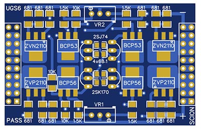

I can take a look at it, but FYI... the UGS6 is ready and have been for a while, I simply didn't want to disclose the full information. Since so many UGS gain stages already exist in diya, the harm is significantly less, but I don't want to share the schematic since it is a current product. I can show a pic of the PCB render but will disclose my altered version. Someone could probably figure things out via the official service manual and various other official documents available online - as long as it doesn't come from me - This is the one I will alter.
I also discovered that spite being the same transistor, sometimes the Cob and Mhz vary. Same platform but worse spec than another producer, which is interesting.
OBS: Some of the function is not on this pcb version.
You have paralleled the gain resistor [common degeneration] and needtubes have done similar work on his [UGS-UP-Mini: A 25W SUSY Amp] amplifier.
All the help I can get from prior work is of great appreciation
