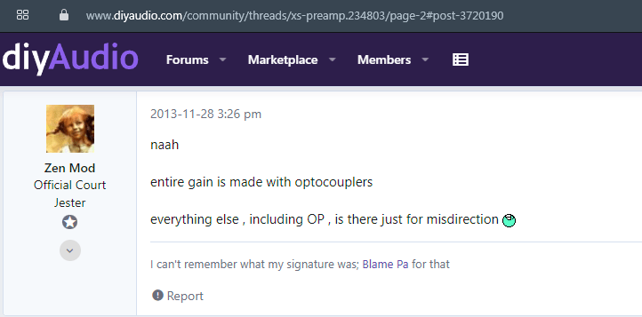

Found something that peaked my interest: ZM: "Entire gain is made with optocouplers", so I stumbled upon an article called:
Use a photoelectric-FET optocoupler as a linear voltage-controlled potentiometer.

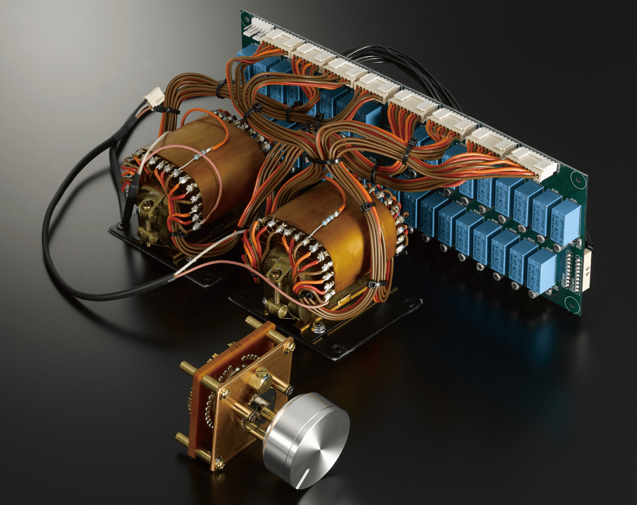

I remember when I stumbled upon the picture of the Luxman CL-1000 volume attenuator and thinking: They must know something I don't.
I have found 7 pages, including two of your blog articles, talking about the Iron Pumpkin and some other stuff. That is an impressive amount of threads for "one" preamplifier, so naturally, I want to go over them. I did notice you have an active JFet stage, and since you do, I am thinking... one could include the ability for the preamplifier to be active H2 dominant via Schade and/or H2 generator - put this is pure speculation atm.
The UGS6 and XS gain stage will still have a life in the differential amplifier no matter what happens to the UGS Muses edition - but, one shouldn't let pride or history prevent personal and gadget growth. Plus, if the UGS Muses preamplifier changes so much (internally) that it no longer qualify being called a UGS Muses, then this thread stops and I will reorganize things and some time later create a new thread for the new endeavour. No matter, the volume wheel and LED matrix display will carry over.
The Luxman CL-1000 is a +$20k history.
Inductive vs resistive volume attenuation.
Alright, a few days have passed and I have come to a conclusion which goes as follow.
I have read numerous articles, forum entry's and spoken to a few who actually have both inductive and resistive volume attenuators and some comments have even made it to this thread, and while its not a clear cut case were one can always say: "alright, this is the best one", I can see a trend. Discrete resistors and mechanical attenuators is a subculture of audio equipment alongside inductive volume attenuators, both transformer and autoformer is lumped together here for ease of argument and I am not jumping into which is best in either camps.
While either solution have its pro and cons, of which some have been debated, by non other than me, since I now did spend some extra time going over the whole topic, something stood out and that is: Very few people have issues with the MUSES digital volume chip. Spite being a resistive attenuator, this is a precision and high grade or quality. Quite and precis. Neither does it appear to remove musical quality, it is more neutral than anything else, which ofc is a positive. This gives the engineer a larger pallet to work with and he/she can tune the electronics to his/her own flavor.
Moving over to inductive for a moment and its a completely different ballgame. Transformers in the audio chain tend to divide people. They either like it or they don't, for transformers tend to be a bit mellow or soft. Midrange forward comes to mind which can make the presentation laid back and relaxed, and yes, many people like this character. But defining it as better is something we cannot do since it often roles of the highs, hiding details and resolution, and before you attack this statement, be aware that it came from many users and not just one.
And its not always about the technology as a whole, no no, its much more complicated than that. The core material used, winding techniques, the use of toroid, EI or double C-core, if it is shielded or not.... and so on. Lundahl talks about the difference of Amorphous and MU metal differences, beyond that you have Finemet or nanocrystaline, on top of that, you have copper vs silver debates. This is not limited to Lundahl, this is common knowledge in the tube and attenuator aspect of it also matters. Doesn't sound like a simple cut case to me. If you want a good AVC/TVC, you have to pay big dolla.
