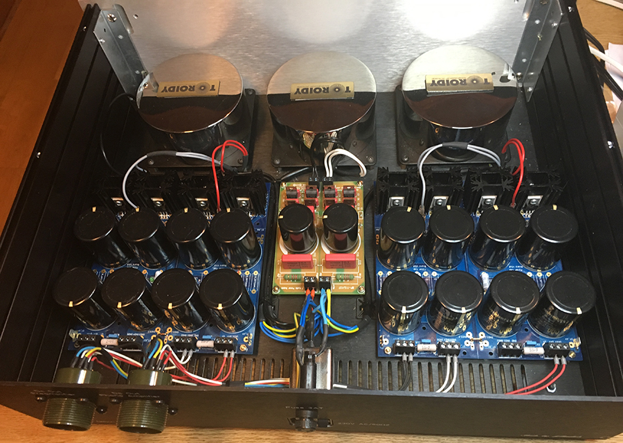

PSU
Right now, I am considering a 30VA R-core transformer, individually shielded and epoxy potted for each channel and the MCU unit. That is 3 individual transformers, hooked up to "custom" versions of the Salas UltraBiB shunt regulator.
As with everything, this is subject to change if I stumble upon something better. But should be good for now 🙂

Yes, go all the way ! 🙂
I wonder if a combo between the diyaudio universal power supply and Salas shunt regulator could work ? The UPS would take care of the AC/DC and reserve and the Salas shunt regulator takes care of the dc voltage regulation... sounds like a neat way.
Hi,I wonder if a combo between the diyaudio universal power supply and Salas shunt regulator could work ?
I updated my last post with another picture 😉
I know you are using the UPS, but the one in the middle, is that one for the MCU perhaps or is that one for the MM/MC RIIA ?Hi, I updated my last post with another picture 😉
What I am proposing is using both the UPS and Salas architecture on a custom PCB, so in the schematic tie them together into a coherent unit, possibly scale the capacitor values since the UPS has 40kuF to 60kuF/rail compared to 6.8kuF/rail on the Salas. The UGS MUSES psu call for 2,7kuF or 2.2kuF... so. I have nothing against a good amount of reserve spread on several capacitors so they share the demand.
