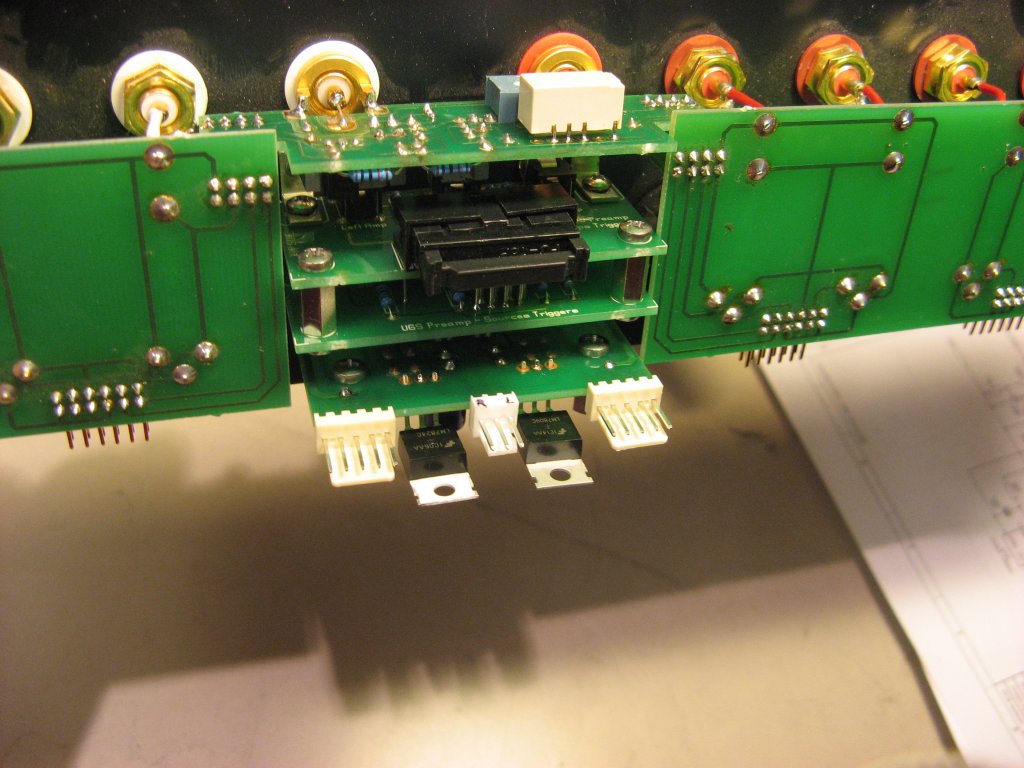

Trying to finalize transformer specs, and whether to go 2x6Vac or 2x8Vac. Is there any disadvantage to using LDOs on the Logic Supply card? I know these are limited to 500mA. This is enough for the relays, etc.? If I got the 2x8Vac, and then decided to use LDOs, is heat going to be an issue?
If using the standard TO220 regs on the Logic Supply card, it mentions heatsinking. I haven't seen any pics in either this thread or the homecinema thread showing what users did for this.
Thanks for any advice. I haven't run this on PSU designer.
Thanks for that pic, very helpful. Was that pic from here (diya) or homecinema.fr? It seems that I've read both threads twice (translated from French), as well as some of the UGS AI thread. Hard to wrap your head around how all of this goes together 🙄
I'm going to be ordering parts to complete the preamp cards, Eric D.'s PSU boards, and 4 shunt PSUs this weekend. Quite a PITA these days with parts availability, but fortunately I have the majority of the really hard to get stuff already. Now if I could just find 15mm U channel in the US for the UGS heatsinks. I can find 15mm square tubing, but not sure how well that would work (without shorting something).
Don't remember where I grabbed that pic, it was long time ago not now, might have been from the french site.

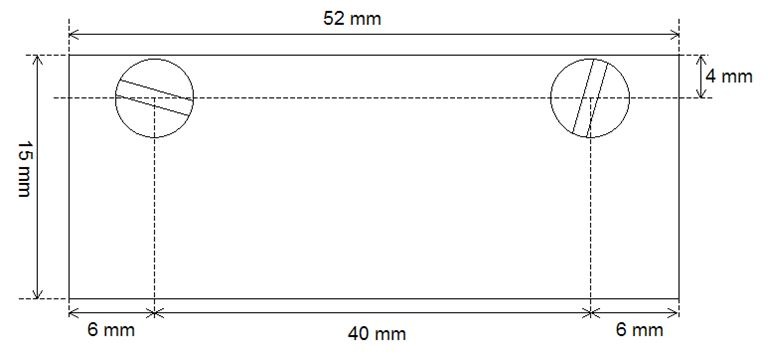

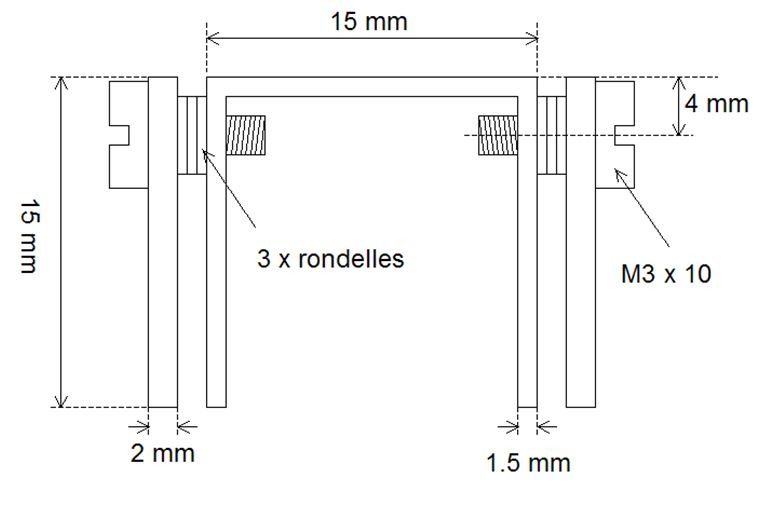

I have locally available 15x15x15x2 mm U-profile raw aluminium (15x2mm flat bars as well) and will need to make mine.
It is not 1.5mm like on the plans posted by Ine earlier, but might do the job. Need to take an exact look at the fit. Better for the taps.
