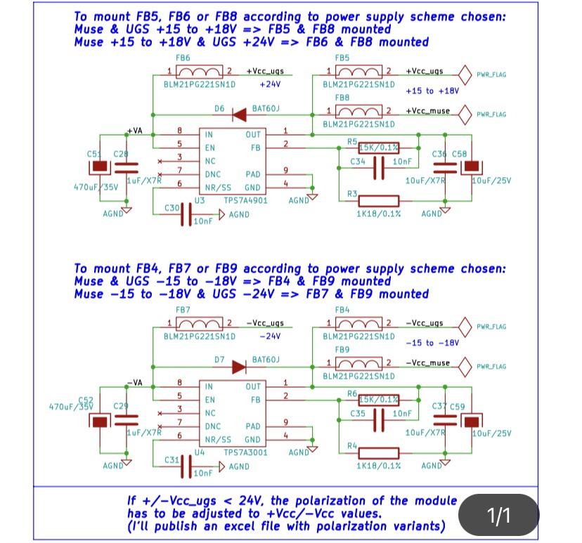

Your 28vac trafos are just fine.
You need to set the shunts for 24vdc. Higher voltage drop across the ccs mosfet means better performance but also a bit more heat.
The ugs modules can be powered up directly from the shunts with 24vdc or from the onboard ldos depending on how you populate some of the ferite beads.
I guess you will power up the modules directly from the shunt regs.

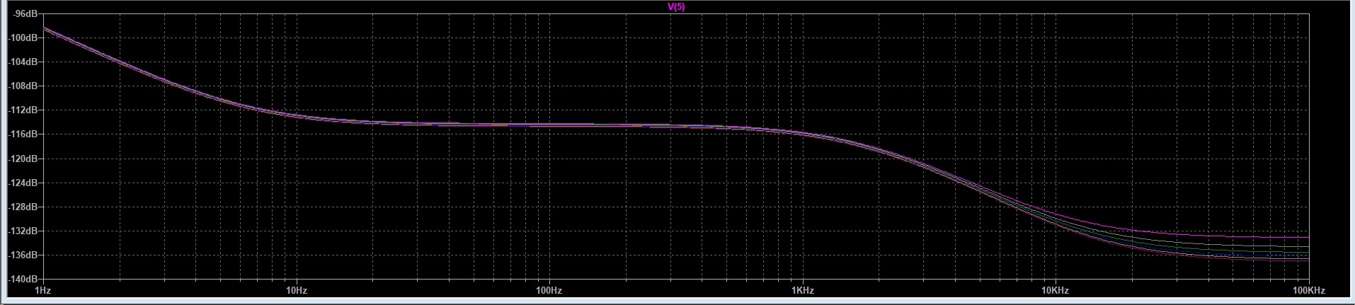

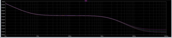

Hello @Ine and @Alex_twn, nice to see you around!
more is also ok
not only ok but better. I ran a sim showing how the regulator works from 30 to 35vdc on the input and 24.7vdc on the output.
Me… I prefer the better performance at the expense of some extra heat.
Edit. If you have 28vac secondaries you can always insert some resistors between the secondary and the bridge lowering easily the dc voltage after the bridge. Well this if you can’t manage the extra heat.
If you use snubbers on the secondaries you will have to calculate them with the resistors connected.

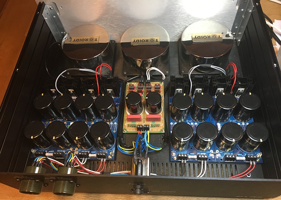

Back to working on the two I am building. Almost have the preamp boards done (just the relays and psu jumpers to add). uC boards are done and loaded with latest firmware. I have one shunt PSU built, have the parts for the other 3.
I built one of Eric D's power supply boards yesterday and hooked it up to one of my trannys (Toroidy 100VA 4x24 2x8V). The unloaded voltages I am seeing are a bit high, but I guess not unexpected. I'm seeing ~35Vdc for the 24V supplies and around 11Vdc (closer to 12) for the digital feeds. I guess I'll just need to anticipate dealing with some extra heat.

Question re: heatsinks for the shunts: are the onboard heatsinks sufficient for these, or do most people sink the mosfets to the case bottom? I was thinking of ordering some Aavid 530002B02500G screw in 2.5" heatsinks instead of the Ohmite ones specified.
Also, @Alex_twn , you were spot on your guess of 32V; with one shunt connected with the 470R load resistors, that is what it dropped to.
Agreed Alex. I questioned my ability to properly drill the chassis base plate for mounting the shunt devices to it, so am going with the onboard heatsinks. I had wanted to use the Aavid bolt on version, but it appears those are only available in 1.5", so I went with the solder pin 2.5" above.
Got all 4 shunts built, adjusted, and tested. I was kind of surprised that the 470R load resistors run that hot (85-92* C) as there isn't much current thru them (~51mA, so about 1.22 W on a 4W resistor).

Are you using the UGS Muse board set from Alex (from the group buy). The preamp boards take the +/-24V from the Salas shunt boards laid out by EricD and feeds the +/-24 to the UGS boards. It also reduces the shunt +/-24V voltages to +/-15V for the Muse chips using a pair of TI LDOs. The Jung superregs for the Muse chips would seem to be unnecessary given the way this is done for the UGS Muse preamp?
