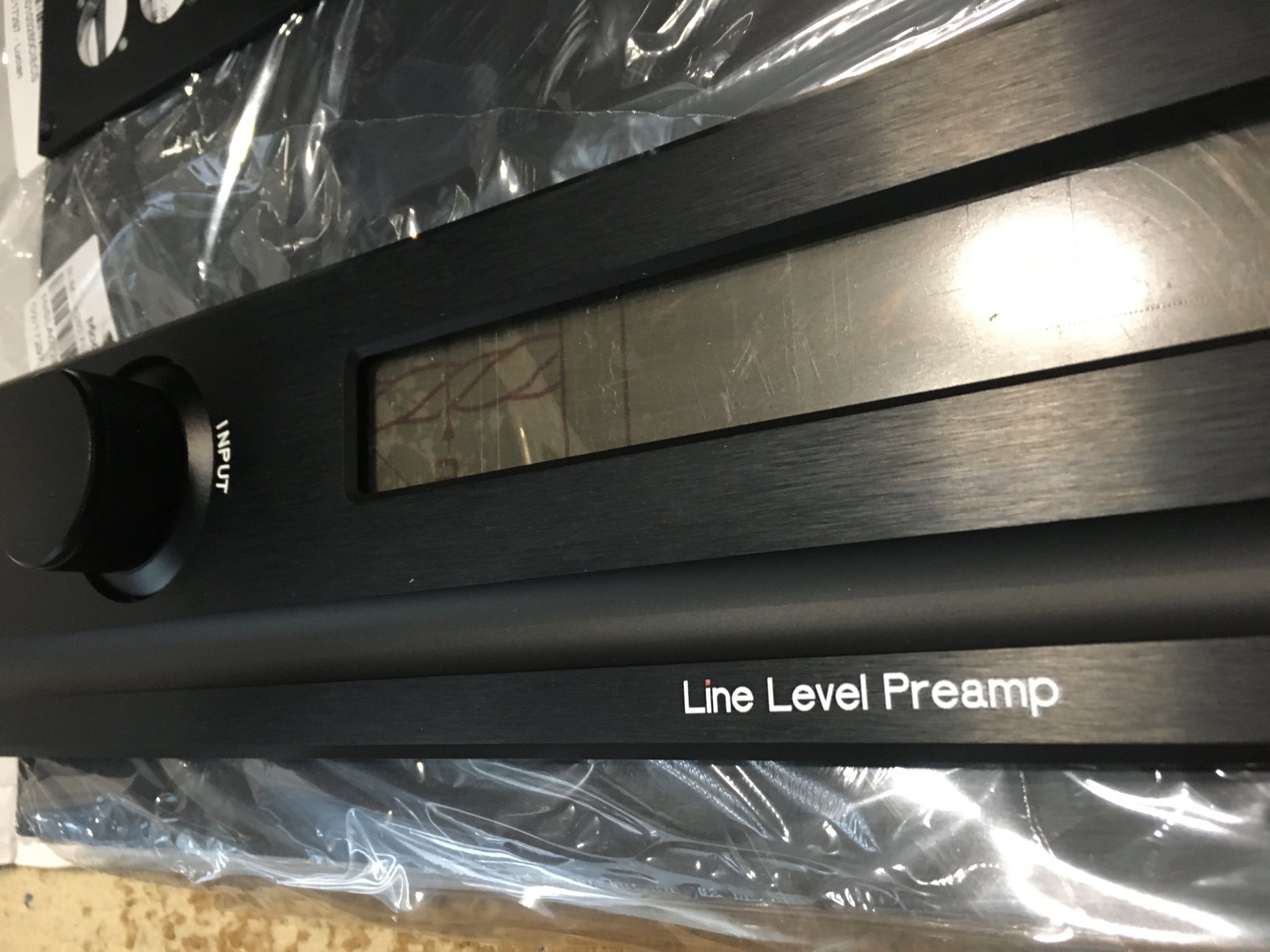

If you use pin strips to fix the displays to the mcu board the usually used combo is 10mm tall so I took this into consideration when doing the calculation.
The display is 3.5mm tall, 1mm for the pcb and 2,5mm for the metal frame in front. If you sum the 10mm height of the strips to the 3.5mm of the display you have 13.5mm from mcu pcb to the front of the display.
There are the pins of the strip that advance a bit in front of the display but these can be easily clipped off.
In your drawing for the front panel you have extruded 8mm for the display from the back to the front. Inside this extrusion modushop mounted a 3mm thick plexiglass so there are only 5mm remaining from the 8mm.
To have the front of the display fit next to the plexiglass you need standoffs with a height of 8.5mm(13.5-5) so from here I said that I think you used 9mm standoffs.

These push buttons made out of aluminium are indeed looking very nice, thanks for sharing!Also, was poking around and found these pushbuttons, which I may use for mine. 9.7x6.6mm

Indeed looking very nice, congrats on that beautiful job.Still a lot of work to be done but it looks good

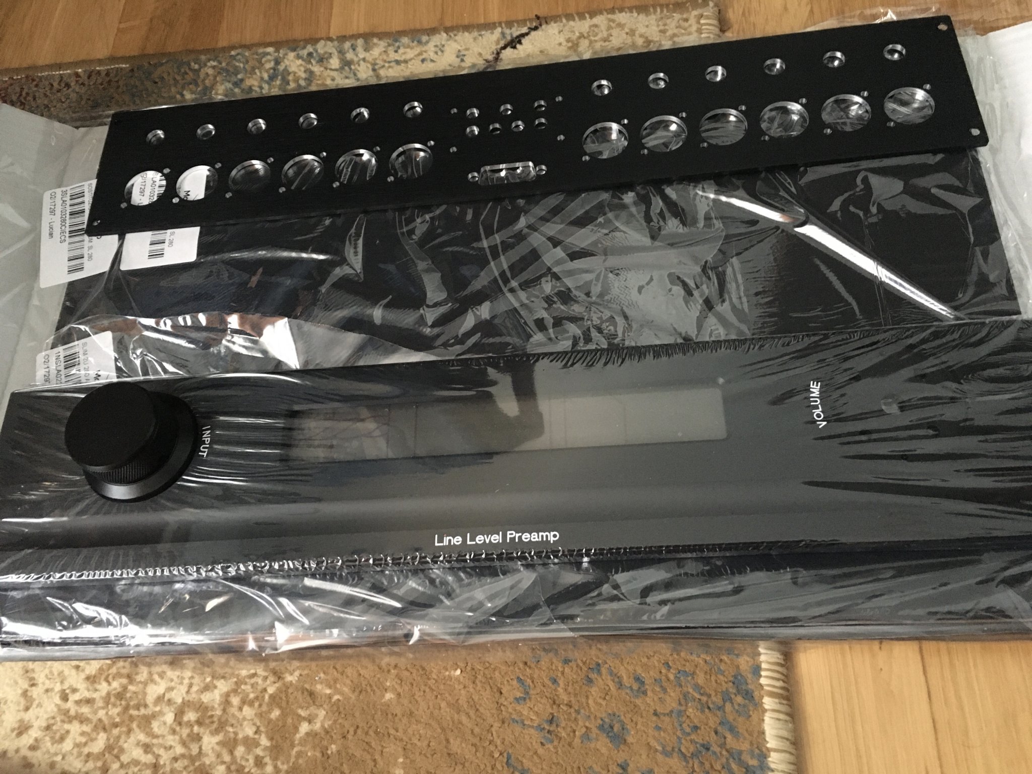

You say you did order the front panel at Modu, right?
Yes, indeed. They did a very nice job and I recommend Modushop.Indeed looking very nice, congrats on that beautiful job.
The drawings shared here that I copied mostly from Ine aren’t ment to be used with the standoff type I wanted to use(male/female) and I needed to modify the drawings (this after sending the drawings to Gianluca). I think Ine uses passive standoffs. So being lucky I was able to modify the drawings.
In the end I am satisfied with what I got for the money I paid. It’s too long that I host the pcbs on the floor or on the table. They needed a decent enclosure.

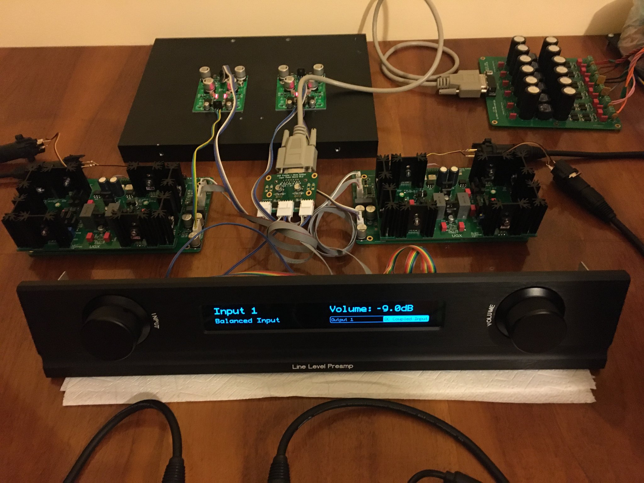

I built the UGS long time ago, in 2017 following the GB in HCFR thread and never have any issue...
In November I leave my house for one month and I switch off all my system, unpluged all main AC for safety, internet connections, etc.
Back two weeks ago I reconnect everything and now I have a problem on the right channel:
After 15/20 minutes playing well the right channel stop for few second than start again. After few minutes stop again for longer and restart, random.
First of all I checked the connections and everything is fine.
After swapping between the outputs and the inputs I realize that is the UGS.
I swap the 2 USG modules but nothing change

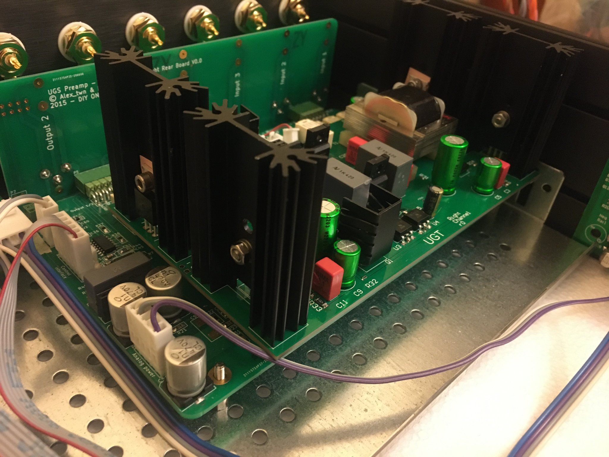

I keep it in the banch with the PSU and I start to check all the various values, everything is fine.
I dismounted all the PCBs, resoldered all the various connectors on the back board and preampli board.
Riassembled, riconnected but the problem is still there, stop to play randomly after a while.
The problem is random so it's really difficult for me to understand where can be the issue and I was thinking to change all the ICs in the preampli board (I have all the ICs with the exception of the MUSES).
Before to proceed and to have a confirmation that the problem is in the preampli board last night I swap the P2 and P6 connection from the MCU.
With BIG surprise after 2 hours playing is working well without any interruption (???).
Now I am really confused... if there is any hardware issue why don't show up again? I really don't know what is going on
In the next days I will do some more long listening session. In one side I hope that the problem pop-up again, at least to understand if it's in the preampli or in the MCU.
Maybe someone have the same issue?
Any suggestion will be highly appreciate
Thanks,
Enrico
