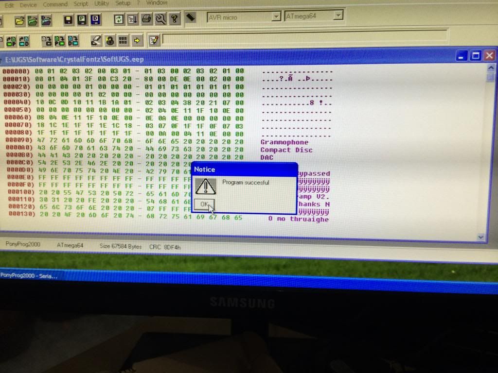

I did Hex and eep only, how to do the fuse bits? apology I'm new to this programming thingy.

On your AVRISP MKII click fuses tab. Then enter low fuses and hi fuses.

Yes I did use ponyprog2000 and succesfully loaded hex and eep but after the upload when i switch on it has no response.
The files contain howto program the avr for ugs. Have you read it ?

@Junie : Write the fusebit not help ? Do you write the atmel with crystalfont firmware ?What about Contrast control for lcd (pin 3?), did it using trimpot ?

Hi didiet78, thanks for your reply.
The fusebit you mention is it like a "configuration and security bits"? it's part of the procedure in Ponyprog2000 which I select three boxes namely BODLEVEL, BODEN and SUT1.
I use the crystalfontz sw. the contrast if I'm not mistaken is taking care of AD8420.
One thing I wanted to know is if there's a problem with AD8420 does it affect the on/off state of ATMEL? the thing is why it's not responding to power switch even though the ATMEL is programmed successfully.

Junie , did you follow this procedure ?
Remember you have to load 2 files...the XX.eep and yyy.hex.
The on/off switch does have a delay...you have to press it for a while but remote is instantaneous.
Ofcourse play with the contrast...it might be on and contrast is off ! either way when on the led is brighter than on standby !

Hi carlos, yes i load two files first the hex then eep all the same time.
The delay, how long is it 2s, 3s..
The relay should engage to supply voltage to LCD but in my case it's not whenever i press the switch.

Finally it's working
a mistake in programming the microcontroller.
I should have selected the HEX file from the PROGRAM FLASH and EEP from DATA MEMORY, what I did previously is put hex and eep on the same PROGRAM FLASH.
Now it's Alive!! Thanks Didiet78 and Carlos, you keep my mind FRESH during the troublesome moments 😀.
