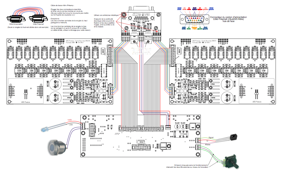

Hi Junie here are the full schematics and cabling diagram so it's up to you to choose the trafos and the relays you want to use.
Study the schematics and let me know if there are any remaining doubts.
I'm having trouble posting the Cabling file....I'll see what the problem is and send it later.
Anyway this complete schematic will answer all your component questions i think.

I think this will help, or give me your email via pm (4MB pdf) 🙂
denis
yep!..be carefull that you have the power supply adapted for the relays you intend to use!...you can use whatever voltage you want; 12V or 24 but power supply has to correspond.

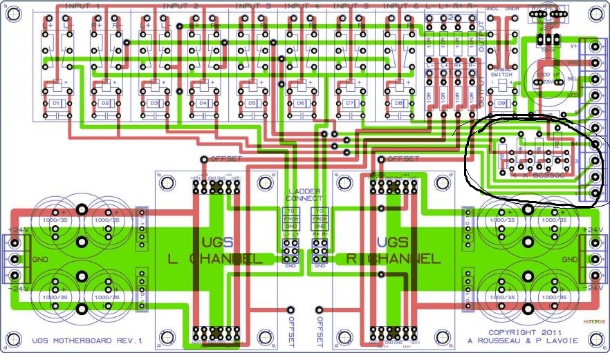

Hi potepuh, sorry for the late answer.
The schematic you are showing is not the design we talk in here.
Without more info, I can only say they should allow less a milliamperes in the bases of the BC550C
So roughly, for 24v relays, make it 27k

on problem CeeVee, it was just longer to figure it out with just the pcb.
The 3 transistors he needs RB value is for a discrete OR gate to command the unbal relay.
About 1mA in the base is fairly enough to saturate the transistor.
I guess there is a topic on this other design ?
Moderators hereby ? 🙂

22.1K but the exact value is not critical. As you probably figured out already, the corresponding transistor controls a relay that shunts the unused IN- signal to ground when an unbalanced input is selected.Anyone knews the value off the RB resistor.

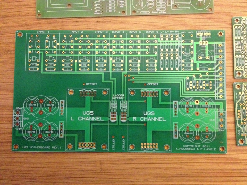

NAR and me, with permission from Mr. Pass. Our boards were black. I saw a green board above. Hopefully it was sourced through DIY channels, and not for profit. I will post some pictures of my build so you can get a feel for what the end product can look like.
