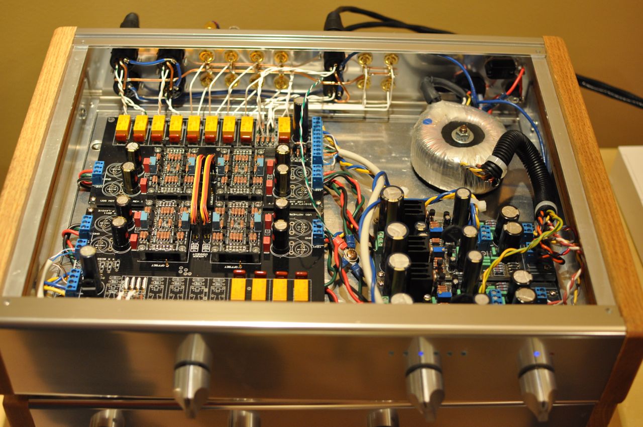

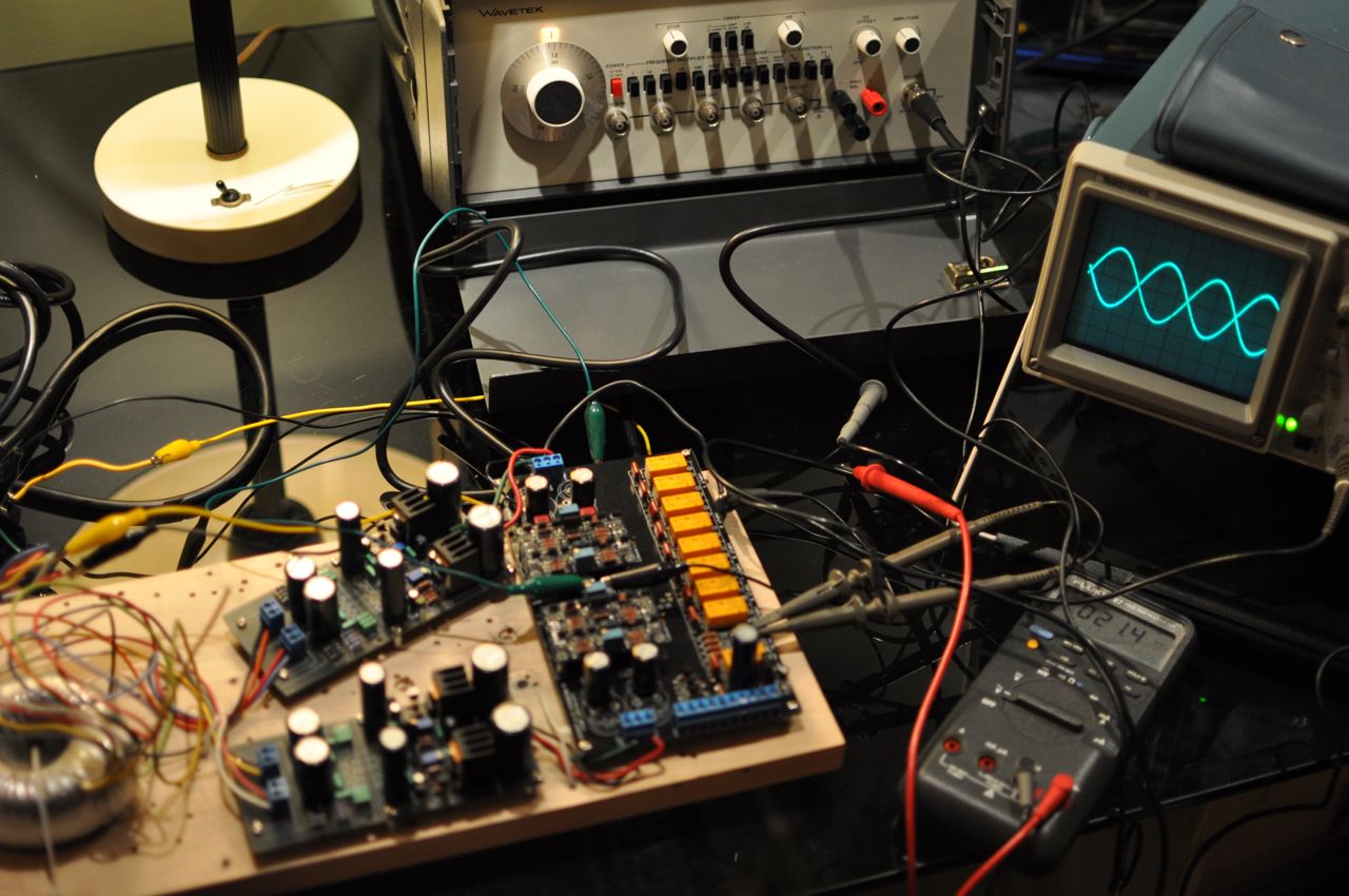

Here we go… The first photo shows a UGS module. The second one, a mother board with right and left UGS modules being tested. The third photo shows the complete preamp with two UGS in series for extra gain. It has been in use for years without a glitch. Knobs are: volume, input select, and phase reversal.

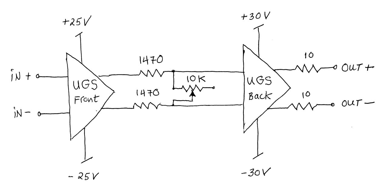

If anyone is interested in the UGS but need more gain, you can use two UGS in series. For volume control, wire a pot (10K) in shunt configuration between the + and - signals between the gain stages. As a side benefit, the input and output impedances then become volume-independent. I would be happy to provide details if anyone is interested. I've built it and it works nicely.

Yes, certainly. The diagram below shows one possible configuration.
Let's look at the volume control first. It is just a pot or step ladder that shunts the differential signal running from the front UGS to the back UGS. I had a nice 10k DACT handy, so this is the value that I used. In order to even out the attenuation steps, I put two resistors in series (1470 ohm) before the shunt. At the maximum volume setting, these cause 2.25 dB of attenuation. On the bright side, this configuration allows using a double-gang stepped attenuator in a balanced preamp.
This would work with UGS modules in stock form. But since I am a natural born experimenter, I tweaked the front and back modules a bit.
For the Front UGS, I changed RFB from 56K to 100K to increase the gain from 10 dB to 15 dB. Otherwise the module is stock.
For the Back UGS, you will note that I run higher supply voltages. To accommodate this without putting the precious jFets at risk, I increased the two 10k resistors biasing Q1, Q2, Q3, and Q4 from 10k to 15k. RFB is stock at 56K, so the gain is 10 dB. The preamp has been powered on for months in a closed enclosure without thermal issues.
The total gain of the preamp is thus 15 - 2.25 + 10 = 22.75 dB with balanced inputs and outputs. I like how it sounds with the F4. Hope this helps.

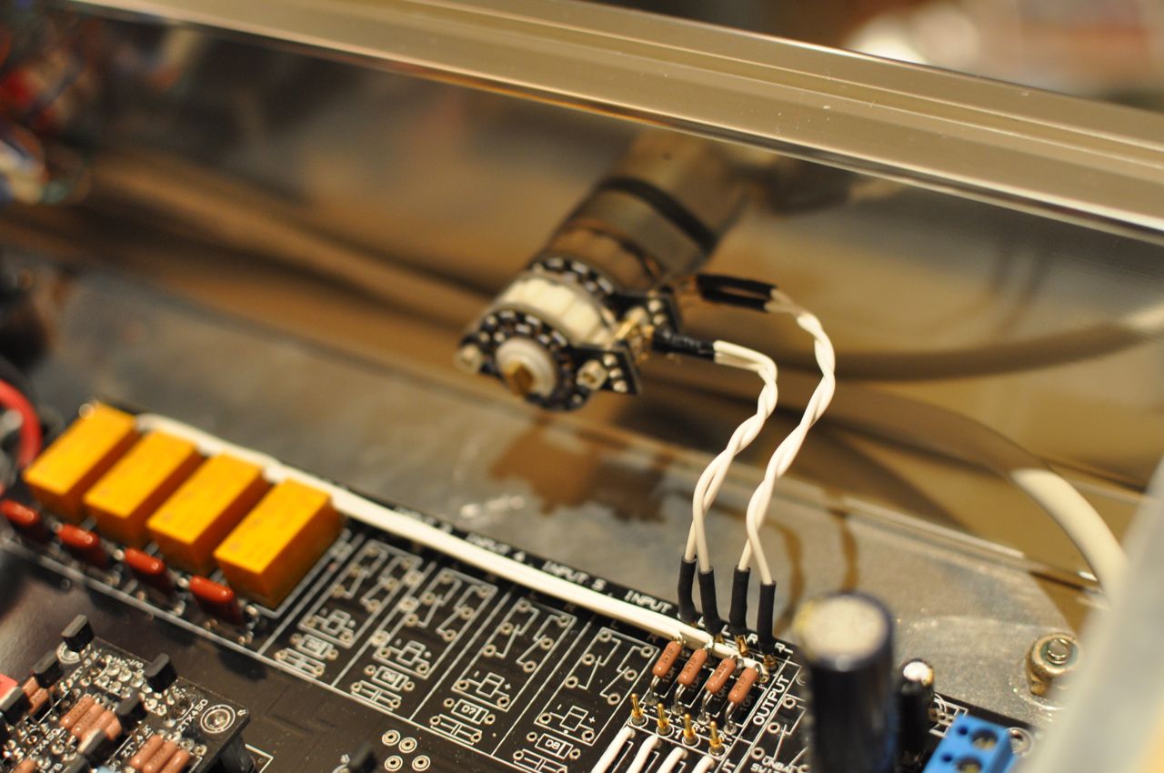

Here's another photo. The 1470 ohm resistors are clearly visible on the PCB.
Dual UGS in series: Relative and absolute offset adjust
Pierre,
How do you adjust the relative and absolute offset?, with both UGS boards mounted in circuit or adjusting each UGS board alone.

First I adjusted each UGS module alone - with its final, stabilized supply voltages. Then all together. Beware of cold drafts 😀.
I matched the Idss of the jFets as close as I could (within 0.4mA per module).
For testing each module, it helps at first to leave the RFBs out (unpopulated). Then it is possible to verify if all dc voltages are normal and if the transistors are biasing properly. There is a message in French by François (Flat) dated 11 January 2007 that explains this step by step. Found it on another forum long ago and all I have is a hard copy. After testing the module this way, I populated the RFBs and the modules worked without issues.
