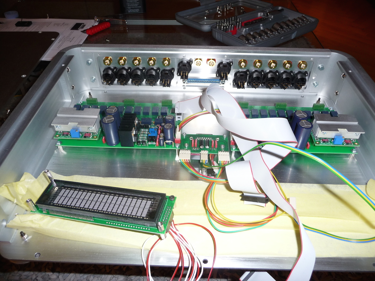

In case others may need the fileMaousse said:Just found the file on the french Forum :Junie said:Dear Maousse,
Good evening to you.
Can you please permit me to copy the back panel design layout of your UGS preamp. I will make one for myself.
Junie
backpanel
It's a file for Schaeffer AG: Home fr
It's made with their design software.
The design is made for HiFi2000 Slimline 2U case.
I had to modify the powersupply holes.
The one from the file is not big enough for the sub-D 15 connector and 1mm is lost for the locking screws.
For my backpanel, I removed the metal brezel from the connector and cutout 1mm from the locking threads.
I'm just rebuilding my UGS for a display update and to prevent loose connection, I just drilled the 2 holes all the way through.
For those using 24V relays like me, and willing to use Noritake VFD, I pulled out the 9V regulator and inserted a 5V DC/DC converter just before the µC power input. The DC/DC converter is placed after the shielding plate I have between the logic section and the analog section, to keep noise away.

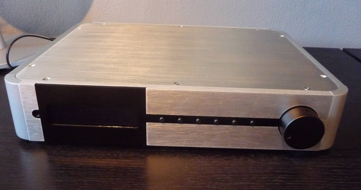

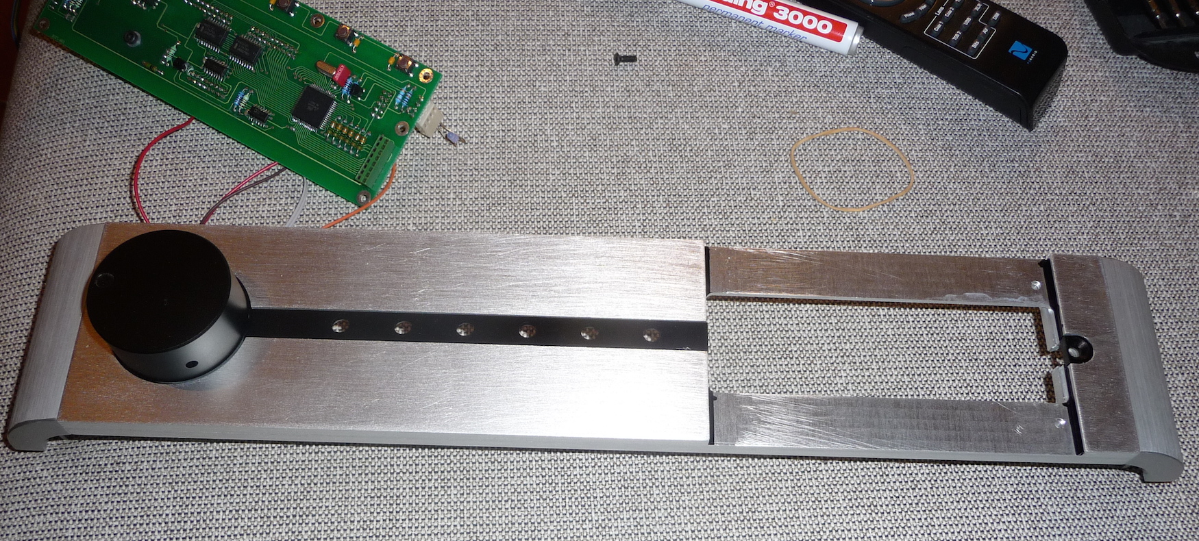

Painting the Front Panel.
http://s67.photobucket.com/user/jiviking/media/DSC_0127_zpsd17ac022.jpg.html
will look for shop to do the printing, I hope I can find one.

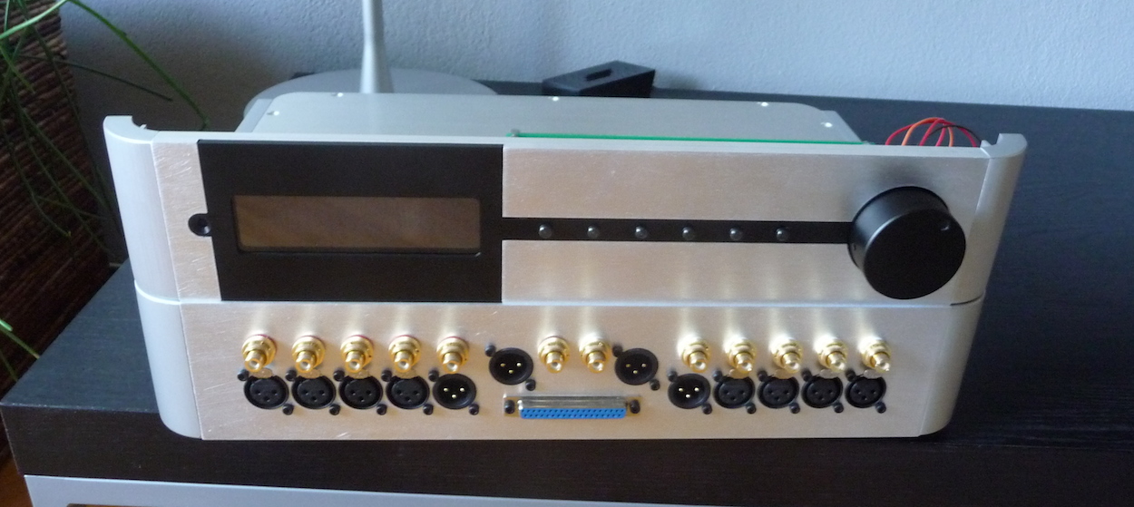

Hi all,
Really clean an pro-look like work Junie. I never post my UGS build version. Since UGS beginning mine was running under proto mod i was the first beta tester for francois. First try was with zvp/znv3310 before françois swith to ZTX actual version. So my proto version was already under use 6 month ago
The very first UGS modules
These are the one i use up to day in my new build in. It 's a simple version (not inclusiv one) since i don't use symetric output yet. I have a remote motor poti and a ES9023 DAC module that i feed with optical numeric signal from my dedicated computer
Behin with connectors
In
ES9023 DAC
ALPS volume remote poti module (fleaby one)
