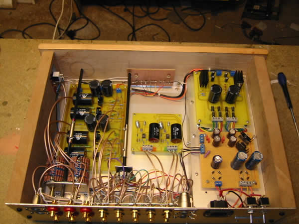

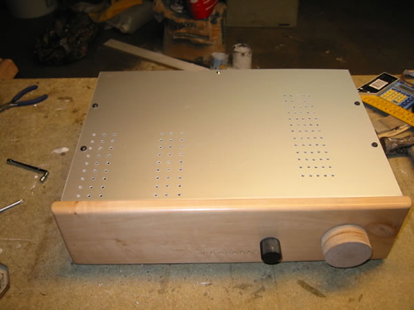

Box building is not what I am best at 😉
I am more concerned with what is inside a box.
I do like your box for your preamp:
Nice work!
Sigurd

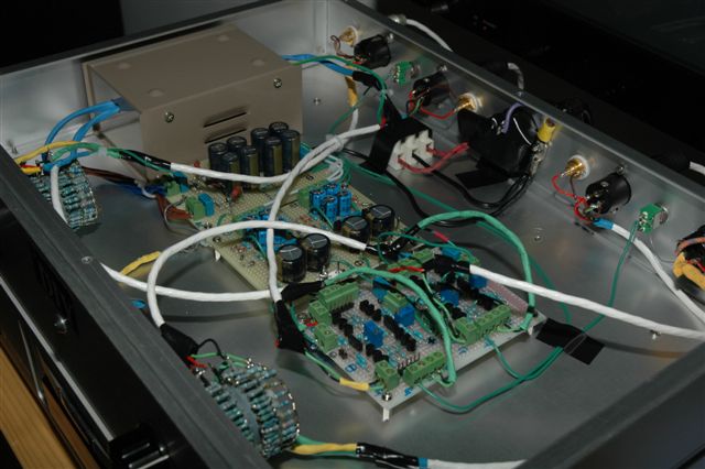

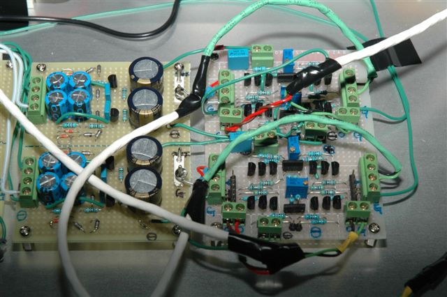

Just finished UGS Ver 3 and listening test under way. First impression is that the gain is too low in my system. Resolution is a bit better than Borbely SE pre-amp.
Any suggestion to increase the gain? Reduce input Rin or increase Rfb? Which way is better?
Spencer

Hi Cheff,
I give up my Aleph 1.7 casing and put in the UGS. I only hv two casings with XLR and RCA sockets.
The supply is just a zener and mosfet series regulator, follow NP design. Voltage at about 22.3V.
I use 3.3k Rin now and Rfb 47k, the gain is higher a bit but still not up to my expection. I need to turn to 12:00 for loud level.
The Borbely SE Jfet preamp is about 21 dB gain, I turn to 9:00 for same volume level. Gain is a bit high to me. I believe 10:30 for my loud level is best position to me.
I use 10k ohm volume at input for both amp.
My DAC is unbal output, UGS output is bal to my Aleph 60 diy.
I believe your power amp has higher gain than mine.
Spencer
