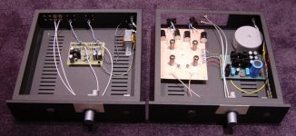

Rob Dingen said:Here is another shot from the 2 preamps side by side one is a bit empty but who cares.
Rob

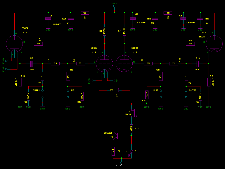

Hi Rob,
Do you have a schematic of your tube pre ? And I know music is not
numbers (although Bach could be the exception 😉 ), but could you post
the same measurements results on your pre than you did on
the UGS (distortion, output Z, etc...) ?
Just to compare, not to compete 🙂
Cheers
Cheers
Hi Cheff
Ok I measure everything with 2V RMS.
Bandwidht 650Khz.
Gain Unbal in Unbal out 5x.
Gain Unball in Bal out 10x.
output imp 80 Ohm (but when the amplitude increase the output imp increase).
THD 0.02% one side not balanced and only 2e harmonics.
If you can make time and want to spend some money on parts build the tube preamp I think you would like it.

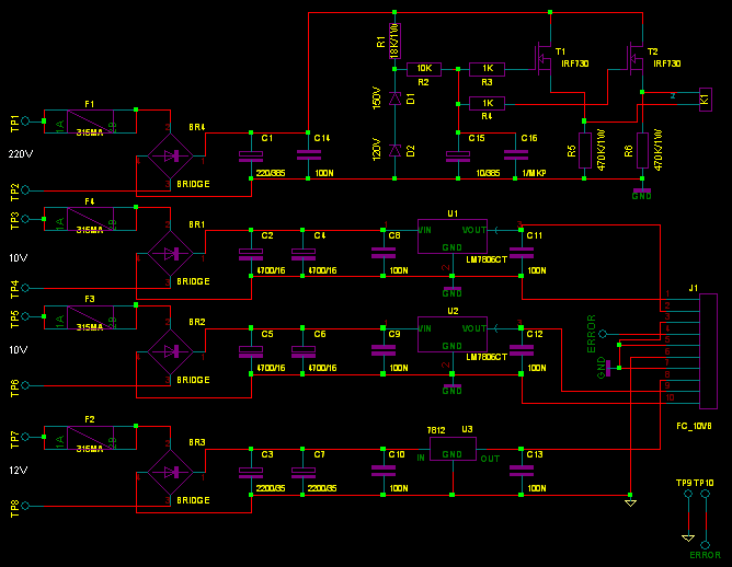

I attach the schematics of the power supply but there is one modification.
Between the 7806 GND pin and GND is a diode the Bat43.

I build the same power supply as Cheff with maybe a small difference in capacitane see the picture on the previous pages.
