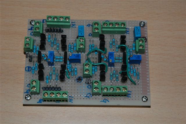

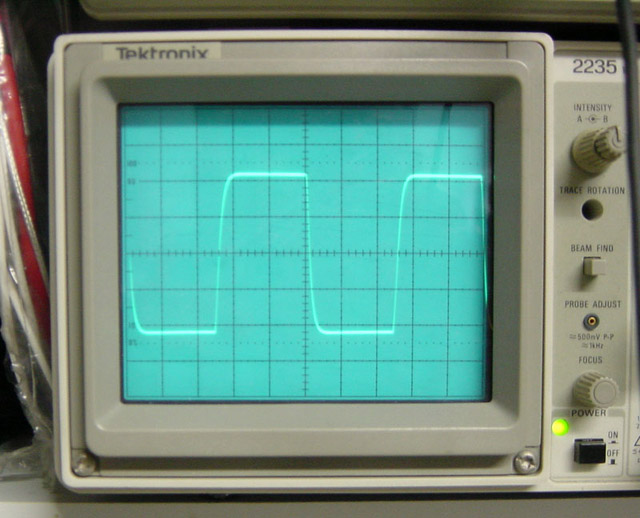

Hi
I build exactly like your schematics and did some measurements.
Only my power supply = +/- 21V and I use BC550 and BC560.
Gain SE in and Out 1.65
Gain SE in and Bal out 3.3
Bandwidth 760Khz -3dB
There is no overshoot.
Max amplitude SE = 20Vpp and Bal 40Vpp.
Distortion measurement is difficult because its balanced out and I don't have tools for that.
But when I measure one side its below 0,01% and second harmonics so Balanced should be lower because it cancel 2e harmonics.
I attach a picture from my scope with a square wave at 100Khz
Hi Rob,
Rob Dingen said:
Hi
Wow !
How quick, and what a nice job !
Concerning your supply, is it the schematic I posted ?
What about the DC offset ? Did you measure the bias of each stage ?
I'm a bit surprised by the max output amplitude, pretty close to the rail 😉
But I only simulated it, and have no measurements, my signal generator
output not being high enough for the gain I chose...
But these are globally nice figures, IMHO at least 😉
Do you happen to have a "real" distortion meter ?
Do you have a picture of the direct signal from your generator corresponding
to the USG output signal (100kHz square wave) ? Just to see if the
transitions are really rounded by the UGS... My generator begins to
exhibit some weakness after 20kHz (DIY...), so I really can't tell about
the HF behavior... But given the BW you measured, I think I should
blame it on the UGS (1/7th of the BW @ 100kHz), and not on the generator...

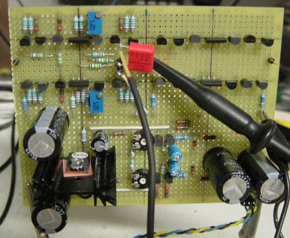

And the picture of my board.
I only build one half.
Now I finish it and do some listening.
Again, nice and neat job.
Quite eager to read your listening impressions 😉

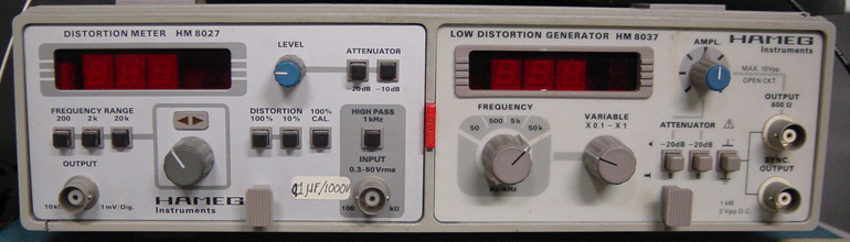

I have a distorsion analizer from Hameg not very hightech but good enough and distorsion is also at output to look at it on a scope.
Rob

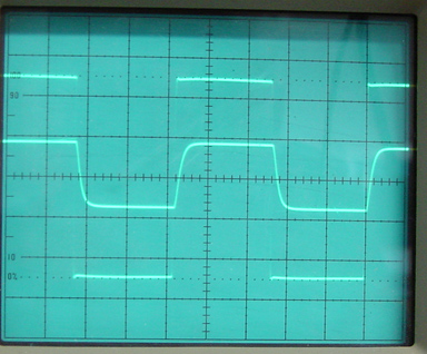

I attach a picture from the scope with 100Khz signal output and input.
The output impededance is measured with a 1K resistor between + and - output.
Input is - input to ground.
Then I take a thru RMS meter put 4 volt ac to the output of the preamp and then short it with the 1k resistor.
With the difference between the to value you can calculate the output impedance.
I hope to setup a listening test on Monday evening.
Rob
I wish I have this one 😉 If my math is ok, the measured distortion of
less than 0.01% gives less than -80dB, and that's the simulated range.
So I was right to blame it on the UGS 😉 Thanks for the picture.
I should have remember Thevenin's theorem :smirk: Shame on me :xeye:
A variation on the (open circuit voltage/short circuit current) classical
formula 😉
I just tried it with the simulator, and it gives 233Ohms balanced,
and 116.5 Ohms unbalanced. Quite impressive to achieve such a
great agreement with measurements ! Even the gain figures are
the same you have (3.3 balanced). Too good to be true 😉
