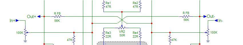

Hi all!
Is there anybody knows the output impedance of this schematic?
I look this schematic for a preamp but I need gain of 6! If I remove the Rin ang directly plug a potentiometer there is not any problems doesn't it ? (Imade a pic😀 )
My first idea was to plug attenuator, like Flat 😉 , in output of the UGS circuit but for my application, the output impedance will increase too much!
See you😉

While I like the idea of SuSy I see two disturbing things in this circuit :
- It behaves like an inverting amplifier ; ie. the input signal is current really ; to be able to input a voltage, a resistor is added at the input which converts the input voltage to current via the input virtual ground. This is well, but it makes the output impedance of whatever drives this a part of the problem. Note that the balancing of the differential pair is important (as per Self) so, if you drive this baby unbalanced, you should not connect the unused input to ground, but rather to an impedance equal to the impedance driving the other side.
- There is no buffer at the output ; open loop output impedance is quite high (basically equal to the Rout resistor) so it relies entirely on feedback to control this. What about adding a simple buffer at the outputs ? (an emitter follower biased by a CCS would do nicely).

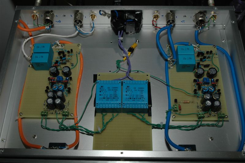

Sigurd,
Yes your ckt is correct except below:
1. I use white follower at the output stage for the Jfet SE Pre-amp.
2. No Pot P1.
3. C4 & C6 use 150pF, too much high if without it.
4. Output use 10uF Rifa cap
5. Use lower supply voltage, +/-24V.
6. R3/R6 = 8.2k.
See photo attached.
Spencer
