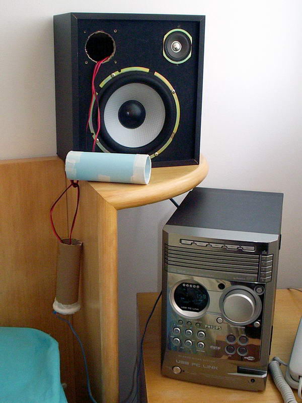

hummm...mine is a little bit less UGLY loking, because i have used a brush
But you can see how dirty is my tune duct....was made with 8 sheets of print paper...glued together and fixed with baby adhesive tape.
A 25 hertz tone was sent and the tube was going in till i could listen clearly the tone (not the mechanical movement of the speaker...nor the wind noise crossing the rounded duct apperture.
Them was glued with dirty PVC transparent cement...the same old glue we have used 35 years ago to Revell plastic toys that we bougth to construct as models.....

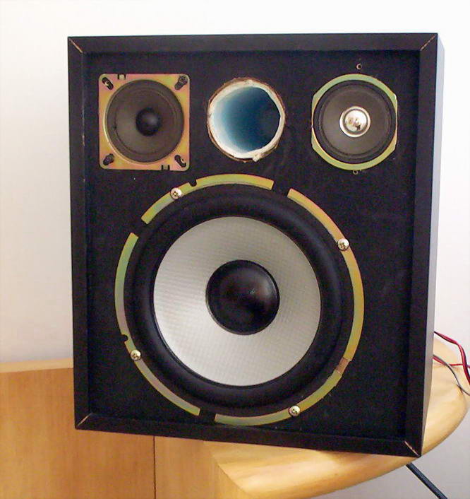

This is the back panel of an Industrial speaker...from a cheap system...
The back side....that was the original speaker front, was constructed with plastic.... that panel was attacked with a hammer and substituted with a 10 milimeters plywood glued with that white glue used to school works....captured from my young daugther.
Now a very flat speaker...as flat as many monitor speakers we can find.... with the flat unflat graphic glued into the front of back panel.
I have introduced a tweeter and the speakers are 4 ohms - 150 watts units.

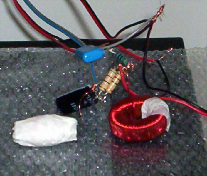

Here is the point to point "sophisticated" crossover
Now it is better constructed...the picture was made during adjustments using a microphone (with the graphic know) and a
cassete deck with analog meters...to capture and correct to flat
response captured with the microfone.
Of course the microphone peaks and gaps where considered...also the peaks and gaps of my "perfect diy speaker"

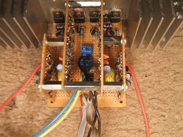

This one i made in a morning....was a Chocoholic Asia design that i have listened monthes ago....not more than 3 hours since the decision to make to be listening to his amplifier...of course...fast this way have to be dirty...very dirty...i could not wait the board dry after cleaning with kerozene and them soap and watter to make the image.

I think that little amp
is not very ugly ... it is nice!
Very much like my creations 😉

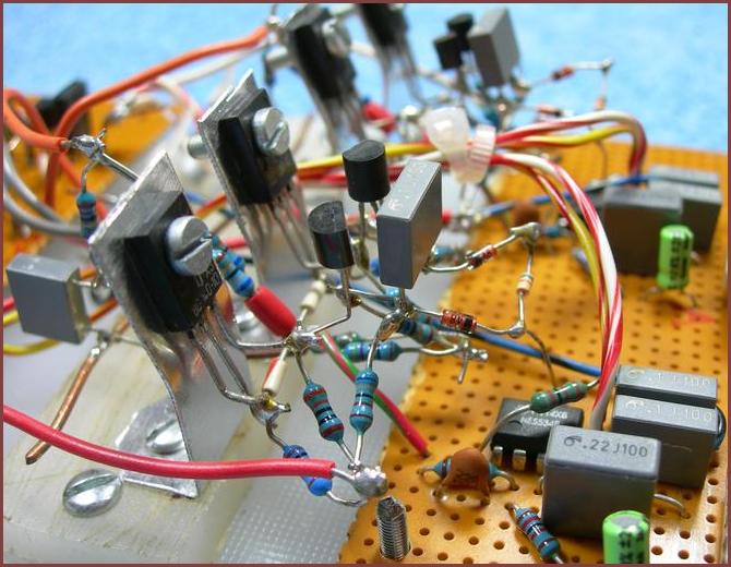

what you think of this one... ???
in all its dusty appearence,
there may some small goodies I can use
I spent many hours slaughter and de-solder old circuit boards
even from PC stuff ... most is digital junk IC .. no good for audio
once in a while there are some good transistors ..
or maybe one LM324 quad op-amp
But this is the way. when have no job and only 1.000 USD
This one ugly .... YEEEESS 😀
