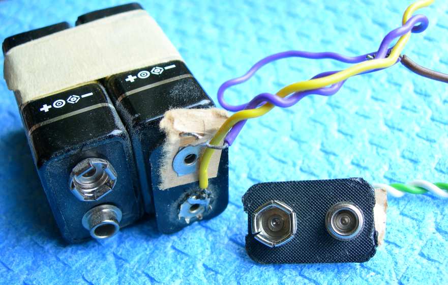

a little trick
in addition to my BATTERY driven microphone amplifier
before you throw away 9 Volt cell
you can cut away and save the top part of battery
where + and - terminals are
will make perfect connector
if you build something using 9 Volt batteries power supply
picture here shows one
18 VDC power supply of mine ( +- 9 Volt DC, mains hum / ripple free )

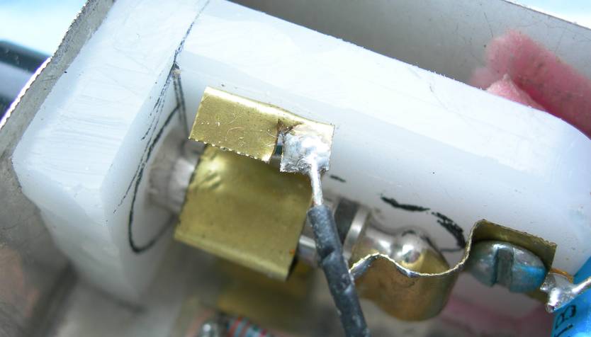

I have got plenty of more to show you, now that I've finally got myself a Nikon Camera.
This one refers to my little 4 transistors microphone amplifier.
See: http://www.diyaudio.com/forums/showthread.php?postid=1008980#post1008980
Background:
When you live in remote little town in country,
you cant just find a shop for special stuff, like electronics components.
And if you find it, it is not of the quality you had in mind.
Device:
Input for 6.3 mm teleplug, microphone mono type.
Material:
- 4 small screws
- Plastic from cheap chopping-board. Those you use for cutting up food in the kitchen.
This plastic is of PE type. Actially I think it is not bad for audio.
- 2 small pieces of thin BRASS. Like 0.25 mm thickness.
Result:
Works! Very short wire direct solder between input brass to input caps.
See Image here

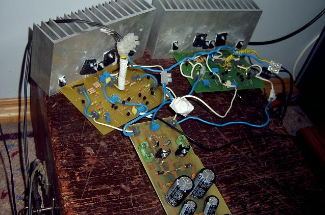

Background:
Power Amplifier,
with separate discrete regulated power supply for input + VAS stage.
Other one big trafo only drives 2 push-pull output transistors.
Notice 4 rectifier diodes hardwired directly at electrolytic capacitors.
Power Source Section of my little amplifier.
Amp is 100% lineup idea and construction from scratch, figured out with paper and pencil.
Ugly, but good working .... for sure.
Enjoy .. and maybe learn some new ideas for your own projects.
regards
calm and fine gentleman of the north
lineup

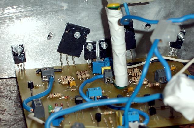

This is the image #2 of same system.
Power Section is followed by regulator
to give a constant and precise dual voltage
to the important input & voltage amplification stages, VAS
I have added some labels for different functions
and shouldnt be much explaining to do.
I think you'll get it.
