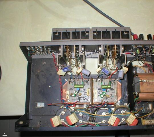

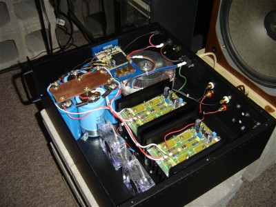

with that Supply
it looks power
.... like a Nelson Pass amplifier, actually
and this is what POWER amps is about:
handling big powers over to Loudspeakers
if they can not do this
they are bad or weak amplifiers
It is all about delivering ENERGY from MAINS to LOUDSPEAKER
with as low losses as possible.

actually: amplifier can not handle more power
than what is supplied from Power Source
- in fact a bit less than this,
- as we have some losses in the amplifier itself.
And the same goes for Transformator and caps.
They do NOT produce any energy - they consume a little bit
and handles the rest to amplifier.

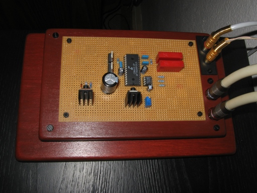

Igla said:This how suppose to look not beautiful
but decent enough design to put on a hi-fi rack.
Tell what it is please. Not a power amplifier.
I guess it is DAC
or eventually another kind of pre amplifier.
I would not bother to paint and make such beautiful wooden things.

Igla said:Yes...it's CS8412-TDA1543 NOS DAC.
Still not final version.
But if i get PCM1789 first to start a new projct...
TDA1543 will just have to vait.
Regards

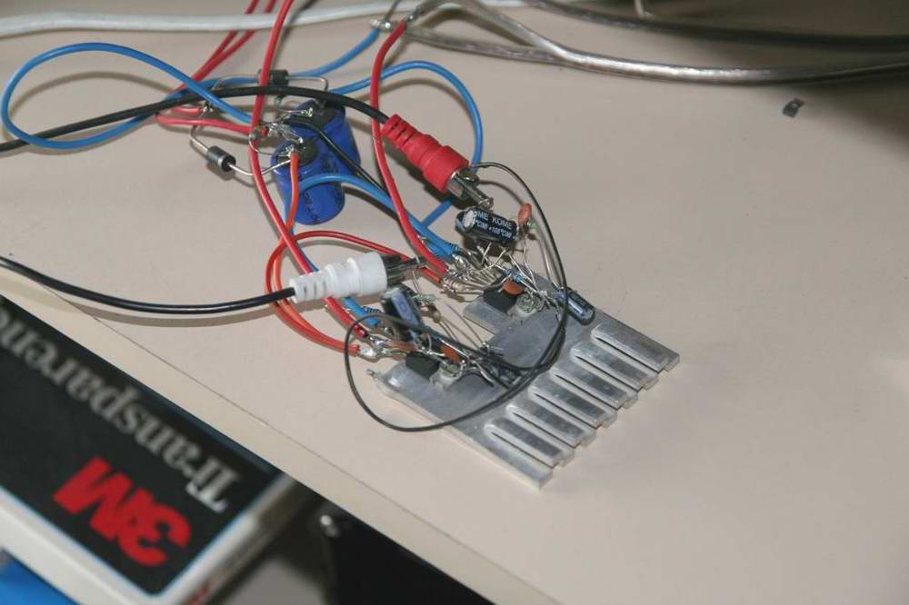

I don't know if this qualifies because it's an active crossover, but here it is.
it is okay, svensson
mycket ful, ugly ... but good working, I suppose
/regards
lineup i AC-län

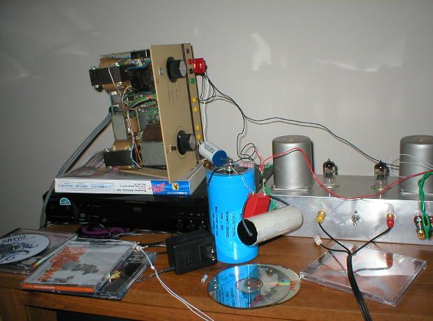

Here is my 6c45pi amp. Probably 2/3 of a watt but it sounds
lovely.
Thats one ugly dangerous looking about - well done !!
Shoog
Nice whoa..can you send me the schematic or tell me where you have published
Interesting... i do not perceive this construction you have made as something ugly... and nice Canon EQS 350D picture.
panzertoo@yahoo.com
regards,
Carlos
panzertoo@yahoo.com
regards,
Carlos

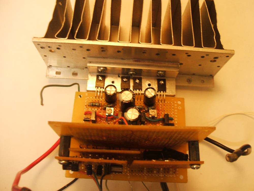

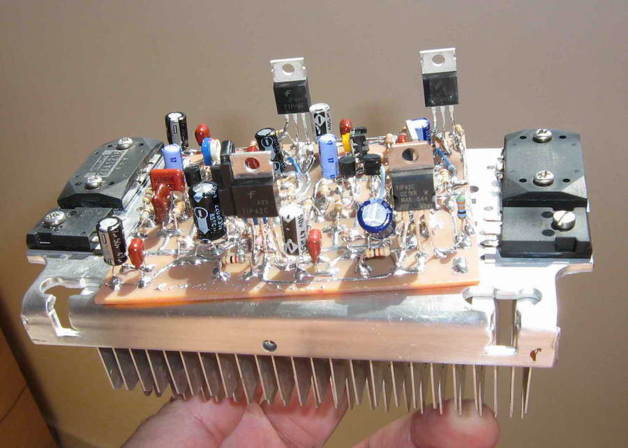

Have I got an amp that fits the description of this thread title. This is the bridge amp I've been working on. Pretty ugly prototype...but if it will work this good with THIS layout, it should certainly work with a proper PCB. The TO-126 parts on the top of the heat sink bracket are the Vbe multiplier transistors, they also provide error correction for the Cheap-o output Mosfet transistors, mounted on the bottom. Vbe multipliers and output drivers are http://www.fairchildsemi.com/ds/KS/KSA1220A.pdf and http://www.fairchildsemi.com/ds/KS/KSC2690.pdf
http://www.diyaudio.com/forums/showthread.php?postid=1369387#post1369387
Hard to believe even for me that those waveforms come out of this ugly-@ss thing.
