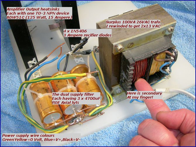

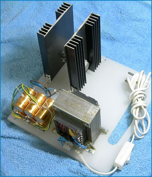

Here is one of my objects.
Ugly?
Maybe not too ugly.
Good working?
Not yet. If ever ..... 😀
Unfinished:
Lineup N-Channel Class A Power Amplifier
See my image for more info.
Another overview of this intended Class A system.
A good target value for idle current could be: 1.5-2 Ampere Class A.
BDW51 has got FT > 4 MHz, at current levels of 1-2 Ampere.
According to datasheets.
Max is something like 6 MHz.

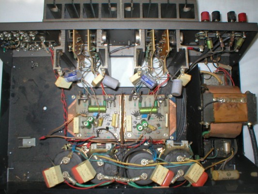

I built this little amp using the PASS A40 board. I turned the bias
down some and used 3 pair of to3 output devices for ~20w stays in class A for the first 10 w. My crippled amp is ok but
not nearly as good as the full A40 but I had that chassis and
transformer.

Perfect example of such amplifiers I want to see:
UGLY but good working. In this case a Nelson Pass diy project.

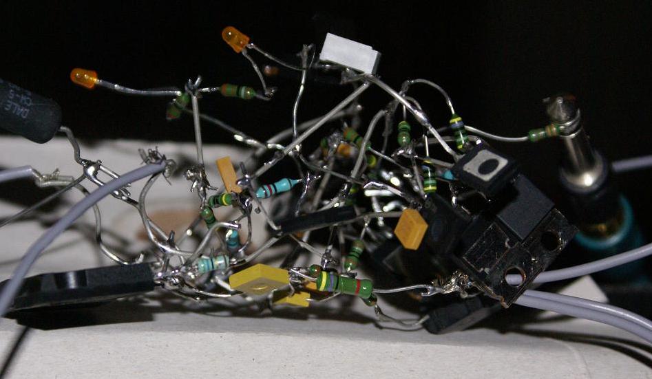

ok since I do pretty much everything In a "rapid prototype" kind of way first, theres going to come sometimes these nice looking amps, this one absolutely blew me away, even though I dont have a sink yet so i'll have to keep idle current a bit low OR play for a short while, hmm when the solder melts ,it's time to cool for a while :-D, ust finished pcb layout today so I might do a couple of boards soon..
The design is a really simple fully complementary irf610 / bd139 (4 signal paths from prestage) and irfp's at the out..

Rapid prototype 😀
Another synonym for Ugly but good working.
I will remember this when I make some quick setup to test my idea next time.
Rapid Prototype
.. of course - this is what we should tell 😉
No kidding, nikwal
hardwire (direct solder) may look awaful some times
but this is the superior way to connect amplifier components.
Especially if we can keep wire, leads real short.

Is it really Amplifier?????

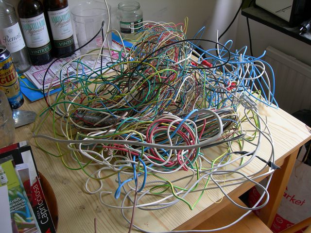

Poor Man's Shuffle
:xeye: Poor man low on money. Is n't this what Blues Songs often tell about.
Now, when you are old and relative poor, you may have some trick to make ends meet. We have all those re-circulation stations.
Where people can buy old stuff for a handful of money.
And re-use it.
People are Crazy and Times are Strange *** .. so they throw away a lot of nice things .. into them garbage containers 😉
Here is a catch I did from a nearby house reparing container. Just when I took a walk one late night in my neighbourhood.
I call this 'Ugly but good working' twist for:
Poor Old Man's Way
Now, this is not 100% legal. Nowadays even the garbage cans contents belongs to some body. Not clear to me who is the owner, though 😀 But right now, I know very well who is the owner (picture taken at my kitchen table). Unless The Swedish Police Force can tell me different 😀 😀
