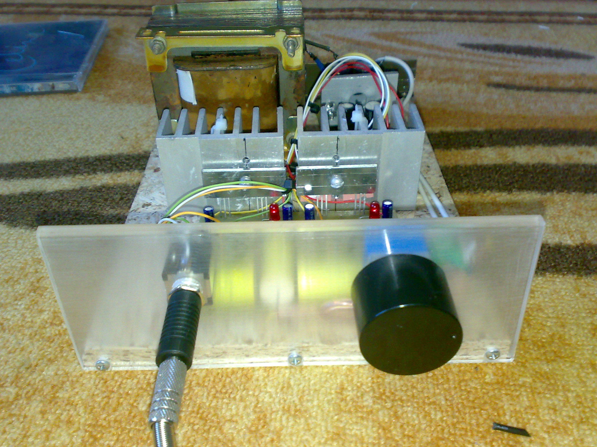

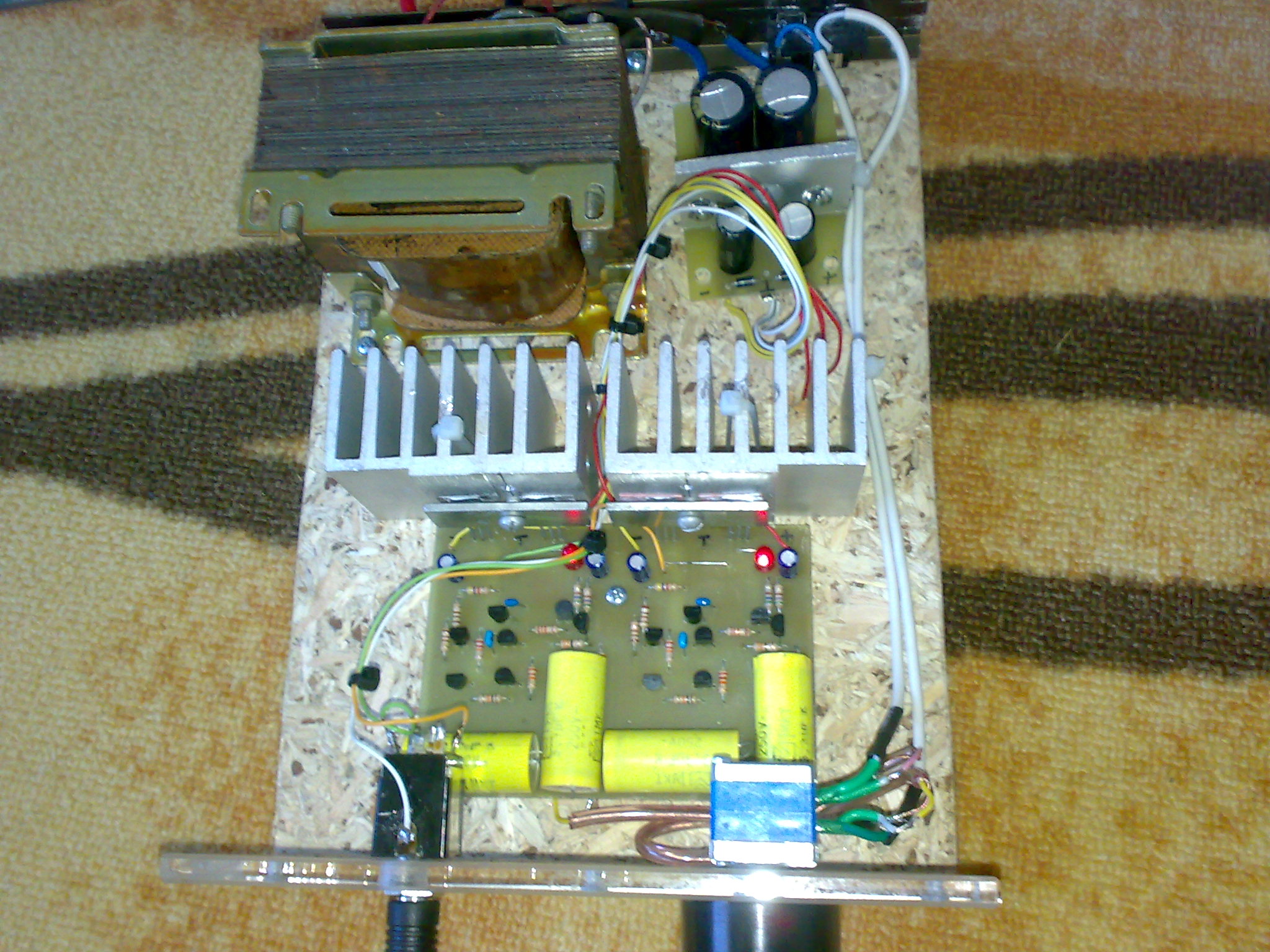

UGLY Looking Amp! - but good working

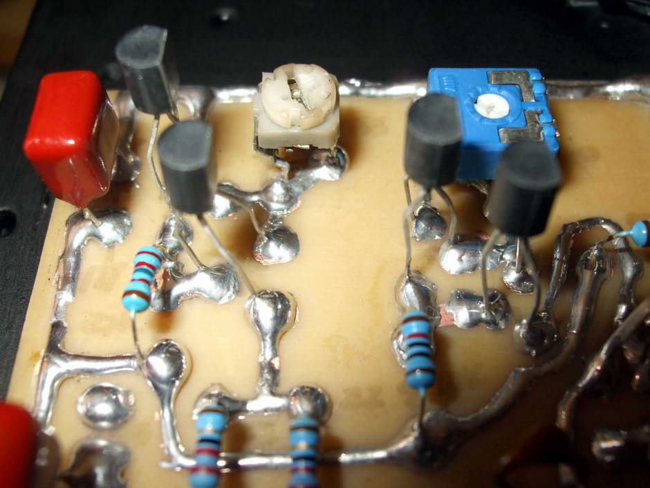

can,t do 2 pics at once
outside

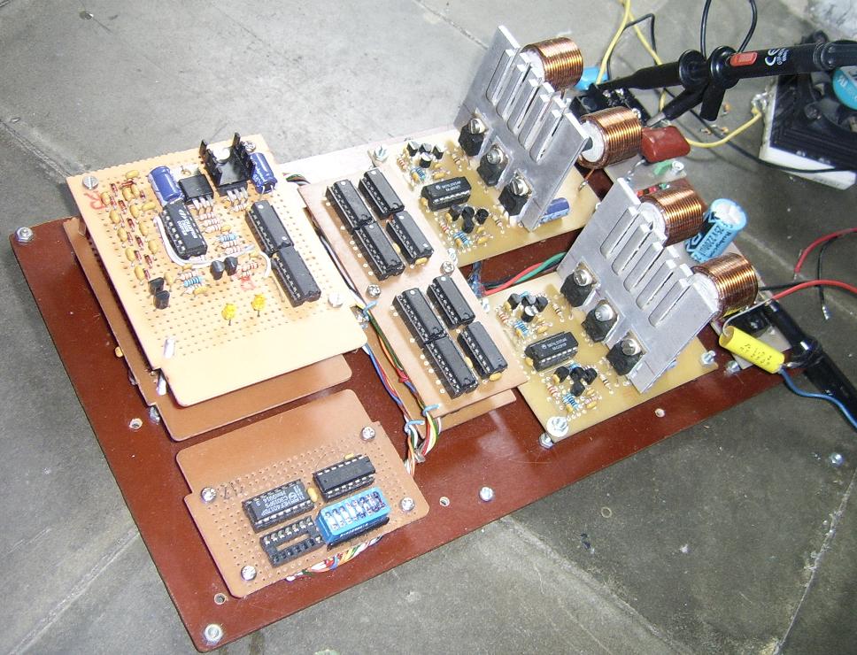

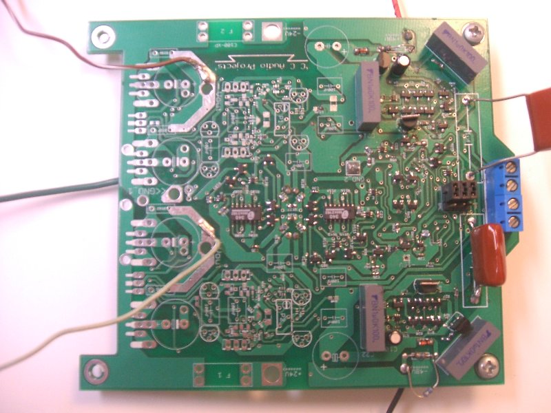

Back to the subject of ugly amps, I've finally been able to work on my latest amp. So far, so good.😀. I have everything working properly up to the output follower stages. (There are two identical output stages that are 180 degrees and balanced that bridge across the speaker.) The jumper allows you to select between a balanced input OR a single ended input, and the output is always balanced with 0 VDC wrt GND.😉 Anyway, I designed the output stages such that I have to nearly build that whole circuit in order to have everything bias out right.:irked: Oh well, guess I have to build it all anyway to see how it works.🙂
I don't have the WIMA 1uf polypropylene input caps yet, still on order. Get to that later....... this may end up being just a stepping stone prototype leading to better things.😎

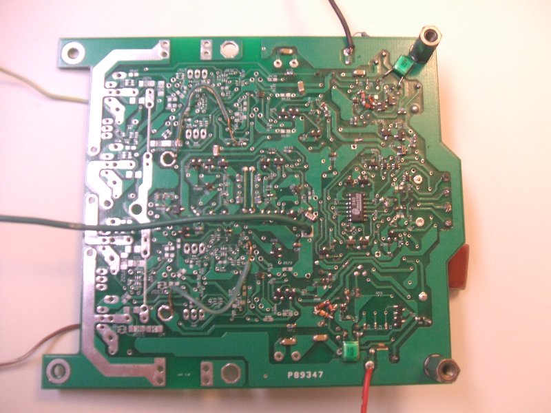

Due to some circuit modifications needed to make it work properly, it still has some "ugliness" to it. Signs seem to indicate that I may in fact get it to work properly. If it does work, I may start a thread on it.
Forgot to mention it is the continuation of this Ugly amp, which by the way is still working perfectly to this day. I'm listening to it right now, 1 year after being built.:bigeyes: What's the average lifespan of your ugly amps?😀

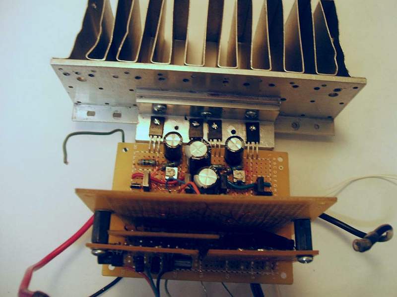

I show that with simple image work
you can get closer to reality. The Ugly True Reality
lineup 🙂 Ugly Pork Eater
Here is the orginal UUUUGGGLYYY image http://www.diyaudio.com/forums/attachment.php?postid=1369406&stamp=1197011242
Photo by: CBS240
Date: 2007-12-06 Time: 01:49:52 .. on the second!
Camera: Fuji FinePix A500

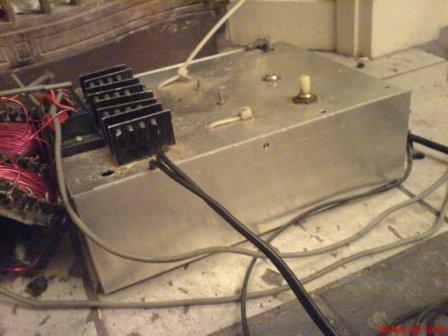

😎 More pictures of Normal Ugly (but good) AMPS! 😎
PLEASE post a picture of your NOT so well looking AMP!
Of natural causes, it is only the most "beautiful amps"
that get pictures posted. They are running the SHOW.
But surely they are only "the tip of an iceberg".
95% of All Good Great Sounding DIY-amps are REALLY Ugly.
Made up of materials recycled from scrapyards.
And simple chassis of thin, 1-2 mm Aluminium.
No fancy LEDs or Knobs.
I want to see more of these AMPS.
More of the DIY everyday reality. 🙄
I could bet on that the amps that SOUNDS best
built by diyaudio members, are not very exceptionally looking....
/lineup - has only built crappy looking amps

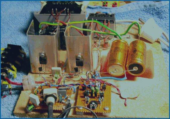

Lineup ugly _ Class A amplifier
This one is not exactly pretty
Picture was taken during testing and trimming days
- Class A
- Separate discrete Lineup Tracking dual Regulator psu for The voltage amplifier
- Output stage has got its own, bigger, Transformer
- Two extra 'added' electrolytics capas to improve ripple rejection
Image ..
is a bit overexposed .. too much light
but I think you all can get how this amplifer works
Sweet and good at Class A around max 4-5 watts out
At least in my speakers ( SPL= 92dB )
Enjoy!

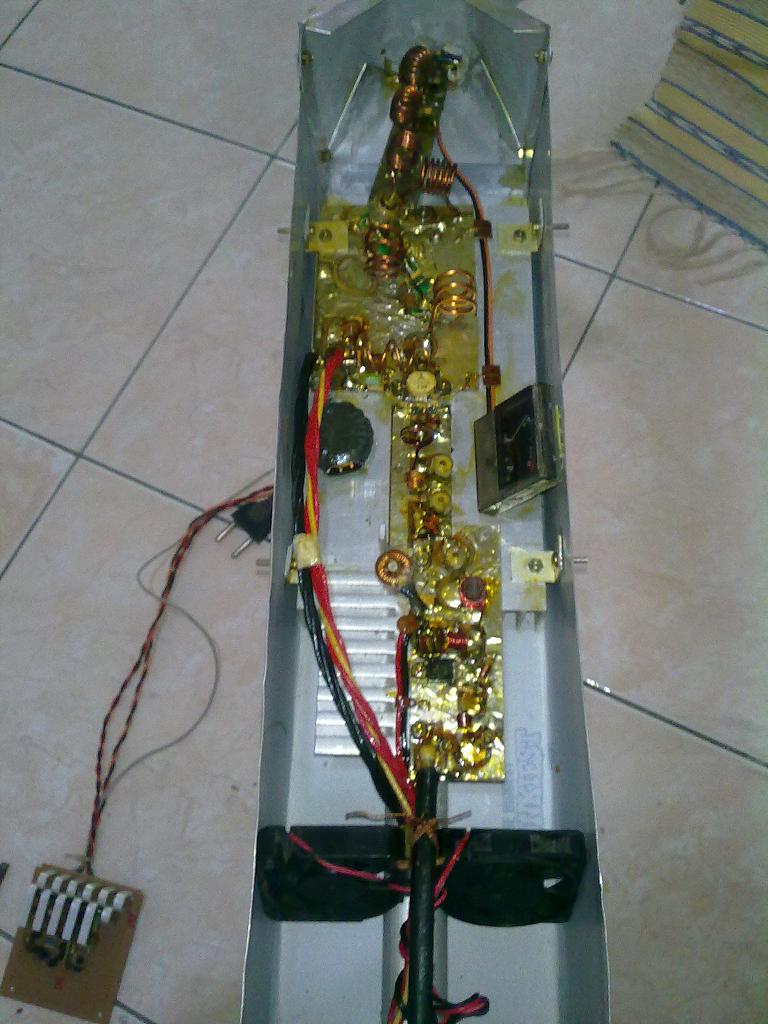

Above are new, this one is old.

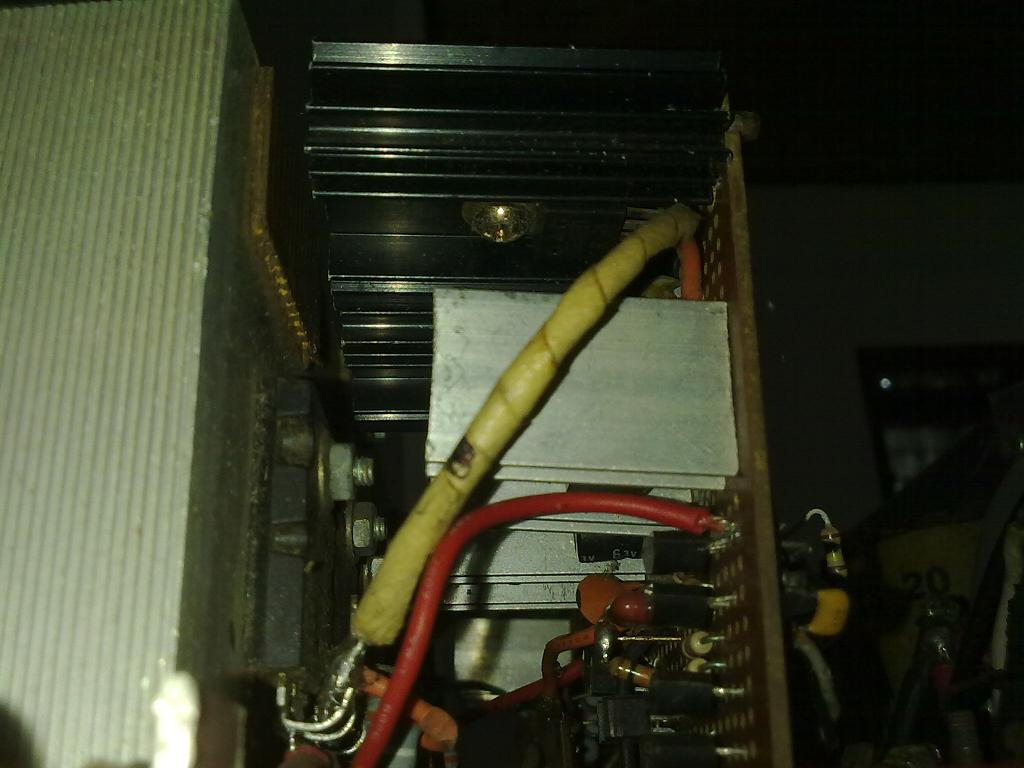

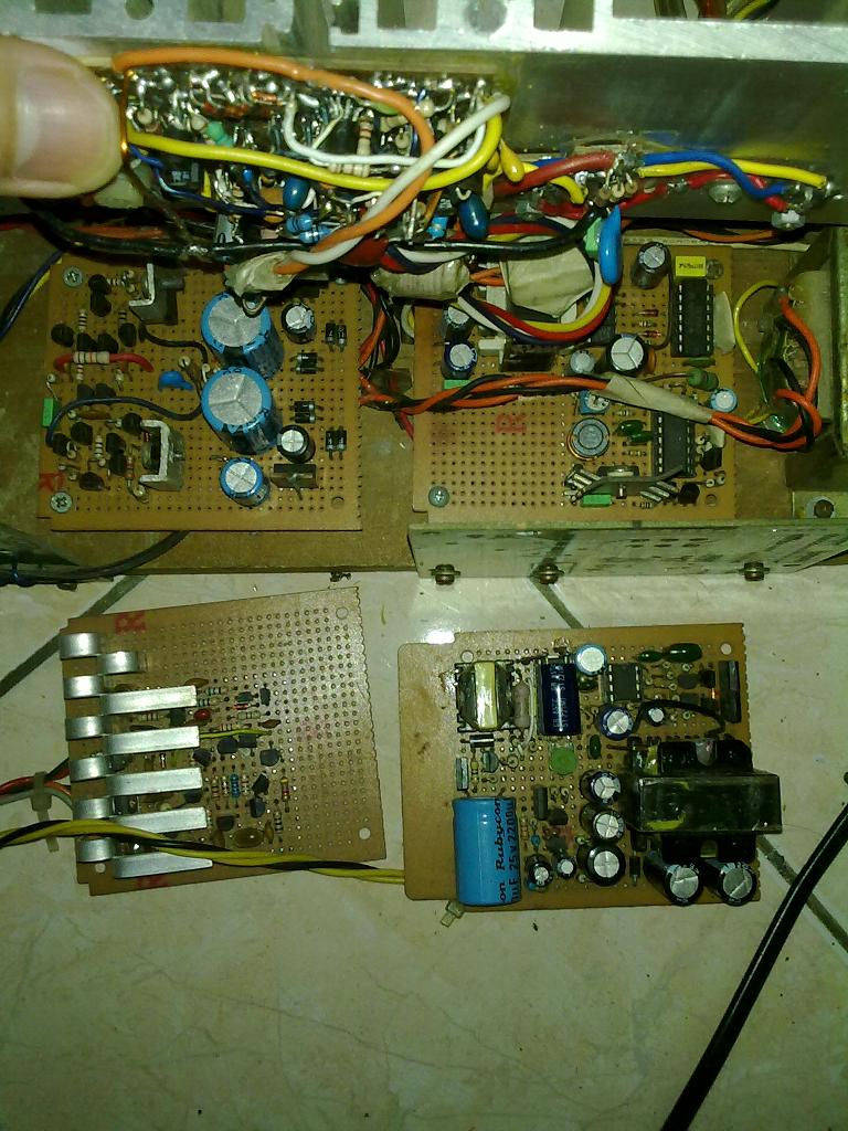

My last version of BJT prototypes, 2005. Discontinued, but my friends wants to buy it with various price, I say "no". Because it is ugly-good work. Using A1111-C2591 discontinued driver. I am still use it until now.
