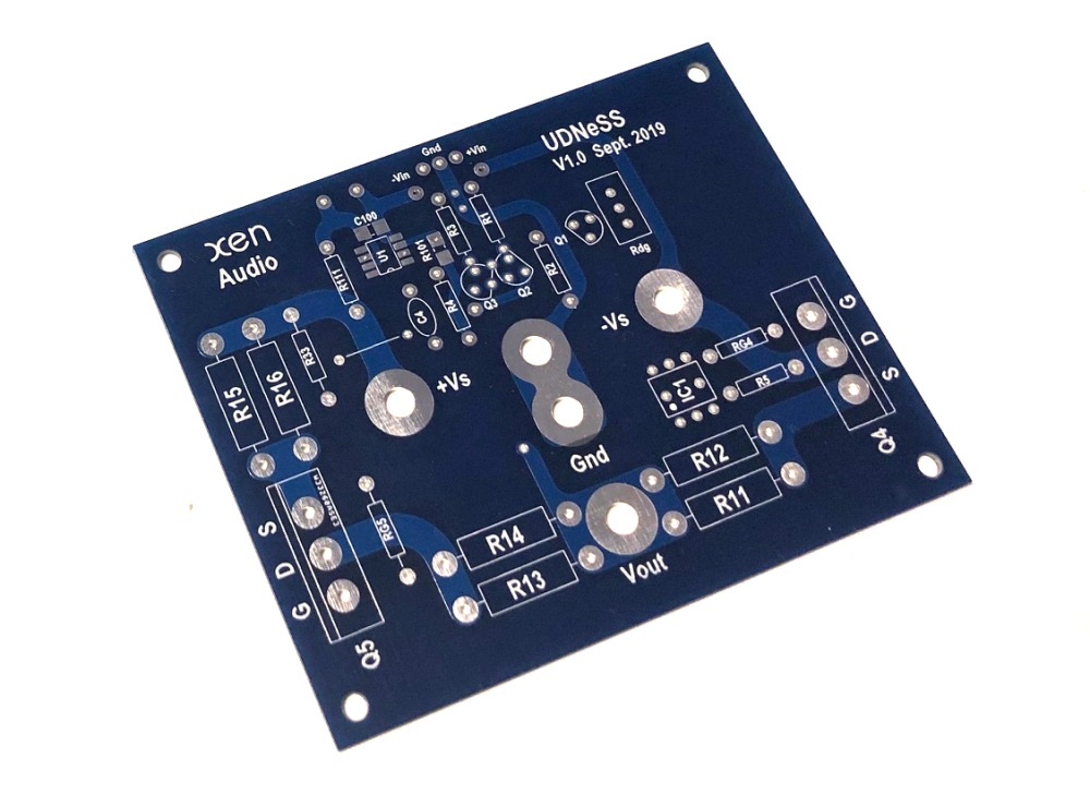

Ah, well, my question was not about "how does it sound", that would be asking way too much! I was more interested about the fact that the original idea for the J2 was to use the SemiSouth parts instead of the IRFPs, because the SemiSouths allow lower distortion. This is in contrast to your simulation, which seems to indicate that the IRFP version has similar (if not lower) distortion as the SemiSouth version.
If you read the article carefully, you will know how the lower transconductance of the IRFP is being compensated by the increase in input stage gain.
All information have been published and explained.
I can also show a simulation where the distortion is 10x lower by increasing the OLG further by a current mirror.
In a very similar way that opamps has ultra low distortion of < -120dB.
But that is not the purpose of this exercise.
Patrick

As you can tell from the schematics, you can use the already published PCBs for the SJJ, etc.
But this is as far as I'll go with the RUDNeSS.

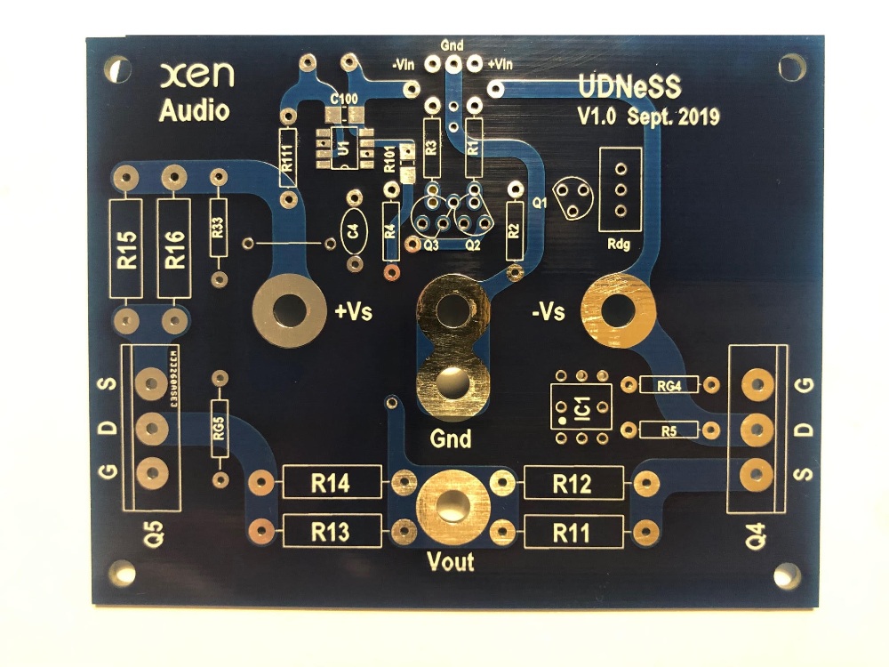

J113 has a different pin assignment (DSG) to the other JFETs (DGS).
PCB was originally designed for Toshiba's.
Orientation is correct as shown.
Patrick
Patrick
