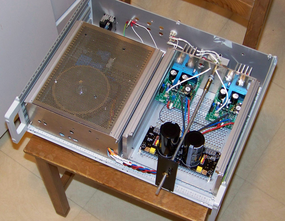

Well, case in progress... BTW, still questions, I've sent them to Hypex support, don't know if they answer such questions... and image search, website search I've done for hours never gave the the answers.
So I do let them here, on my UCD400HD HxR:
* are the 2 films caps just after the input connector coupling caps for DC blocking? As I'm serious about my sources and there is no DC there, can I and should I (soundwise) bypass them?
* are the blue 22uF supply caps for the LM4562? As the HR are quite close, do you think it is already top or a better cap will better these? (no snake oil there, I have spares Rubycon ZLG caps, if it's just pointless I don't mess with your design).
Thanks for any input!

I did get an answer.
• yes they are the couling caps, they will be shorted,
• yes they are for LM4562 supplies, right now they will stay, I'll look for an example of clear improvment by someone prior to mess there.

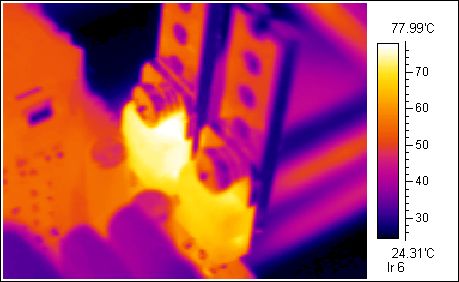

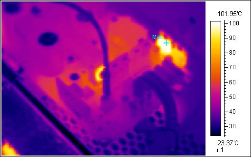

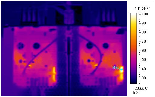

Hi fellows,
prior to close the lid of my amp, wich feature very few air vents, I've done heat measurements. As you can see the heatsinks seem to cool the aluminum T enough (55°C).
But other parts get hot, really hot, the worst being the two TO-220 devices on the very right of the boards, 100°C!
Is that normal, are these devices speced to run hot? The small device at the bottom of the T is also very hot, as a point (under?) the PCB wich is close to 70°C, seen on the top side of the PCB.
As it's winter and room temp is 19°C I'm worried for this summer and the 38°C we can have several days in the room...
Thanks,
Matthieu

I recommend vertical mounting of the plates and enough vents on bottom and top to allow for convective air coolling: éffet cheminée. 😎

I'm sorry dude, I'm afraid I can't do that.
That's a recycled case wich limits things ; can't flip the boards to the side, what's left then are large vents in the case for air flow. Don't know how to do that without butchering the top and bottom lids...
The TO-220 devices are Darlingtons wich are speced at max (internal junctions) 150°C, so to run hot. Will add a tiny heatsink anyway. And report.
