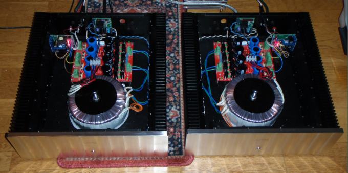

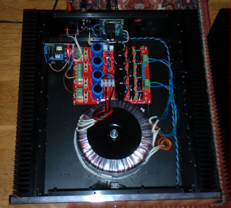

My Hypex Mono-blocks (in overkill-style)
UcD 400 HG + Hxr, Sjöström PSU (8 x 10 000uF), Antek 1500VA/2x40V trafo, Jensen JT-11P-1 line-input-trafos.
Arne K
Hi Cobra2,
I think "overkill" is an underestimation in your case 😀
Looks cool, man.
In my case, I think a very good PS is not enough:
I have tried some tweaks, like -ECdesigns-'s "charge-transfer supply" to great effect, both in UCD and in my DX HR II amps.
Also worthy is regulation with "PowerReg" from Teddy Pardo, of which I had great experience but with only 30VDC. Soon I will install those in my UCD180 and see if I manage to get 40VDC (uses LM317).
Another of -ECdesigns- ideas is the "stepped rectifier" which will also be tested soon. Much cheaper option.
Congratulations,
M.
