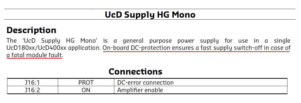

Hello everyone,
Not sure this is the right post to ask this.
I have a pair of UcD400-HG and a pair of UcD2k. The small modules are feed with Hypex linear PS, the big ones with the SMPS3KA700. Can anyone confirm if these modules/PS combos have DC/offset speaker protection in the outputs ??
Thanks in advance.
C.A.

I am using UcD400 modules. My modules are adjusted to have around 10mV DC on the output itself being disconnected from the source component.
I think they do not have a circuit which automatically null any DC on the output.
If so, any DC on the input of these modules would be amplified.
You can measure their outputs with your source component connected.
Outputs of the modules must not be connected to the speakers in the time of measurement.
Thank you for taking the time to answer me. I guess they do have speaker DC protection, as indicated in the TDS of the linear PS. The SMPS have similar feature. I got confirmation from another source after post. I would have rather preferred a relay on the outputs too, but this is already something.
C.A.
