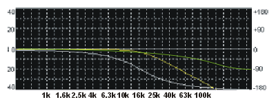

Below the phase plot of a second order lowpass filter, such as found in both UcD and ZAPpulse.
The yellow curve is the filter response of 30uH/680n.
The white curve is the phase response of that same filter.
The green curve is the phase response of the filter in ZAPpulse.

According to my simple calculations, a phase shift of 180 degrees at 400kHz (at oscillation frequency) corresponds only with a delay of 1.25us. I don't see where you get the 3-5us from????? I think there is no significant difference between ZAP and UcD on this feedback time stuff as both use the output signal of the amp, one before the filter, one after the filter, but they both oscillate at about the same frequency. In the ZAP case, an integrator is used (1st order roll off) and the UcD uses a 2nd order low pass (the output filter) and then a phase lead in the feedback which makes the combination of the filter and phase lead network a kind of 1st order roll off like an integrator. As a result, both seem to oscillate at about the same frequency (due to similar delay or more correct phase shift), so even if we could speak about something like delay, it would be the same for both ZAP and UcD. Or am I missing something here.

Lars Clausen said:Below the phase plot of a second order lowpass filter, such as found in both UcD and ZAPpulse.
Ehm, what are you trying to demonstrate there, apart from the fact that your conception of the phase response of a 2nd order LPF was wrong? I know what the phase response of the UcD filter looks like, because I closed a loop around it
All it does is show that indeed the group delay of the filter at 400kHz is not quite 3us.
Also, the phase plot of the zap post filter looks rather suspicious, because it levels out at 90º. This suggests that you would be using a 1st order output filter. This is obviously not the case, so something funny must have happened in the plot expression

Ok, he made a mistake with the phase plot, of course the 30μH/680nF lowpass network has 90 degrees phase shift at 35000 Hz and only approaches 180 degrees at the highest frequencies, like Bruno said.
BUT, when you have a load varying between 16 and 4 ohms on this network, group delay is between 1.9 and 7.5 μsec across the entire audio band.
I suspect that is exactly the delay that lars clausen mentions. NOT the delay at much higher frequencies where the group delay is much lower.
So please note that with a realworld loudspeaker load which varies with frequency, the open loop delay in the audioband is also varying with frequency and roughly between 2 and 10 μsec depending on the load on the lowpass network.
