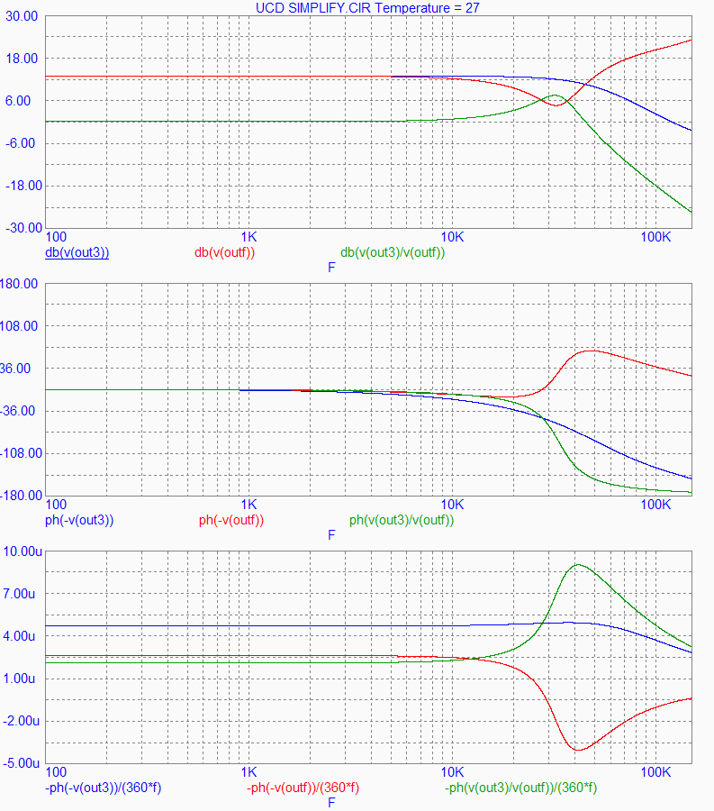

You can see it illustrated thus: depending on load resistance, the filter can take on any shape like bessel (thomson) or butterworth etc, so group delay of the physical output filter as measured inside its passband can vary substantially. Yet, with the loop closed, we see none of this. Instead, it's the loop that sets the final frequency/phase response, and it's fully independent of the load. To do this, I'm relying on the fact that the phase/attenuation of the output filter is nearly independent of load at frequencies well above cut-off. This neatly illustrates the point: the loop cares not a yip about what the filter does at LF, as long as its HF behaviour is predictable, which it is. The small variation for different loads is reflected in slight changes in DC loop gain and switching frequencies when load impedance is changed.
Well, to say the loop doesn't care is a bit simple. Let's put it this way: the filter's cutoff frequency is well inside the loop bandwidth, so suppose you remove the load and it makes a huge resonant peak. This peak adds to loop gain, but disappears from the closed-loop response because it compensates itself.

Yes. The main difference is that since the loop takeoff point in UcD is the speaker output, the response at the switching power stage is the mirror image of the output filter's response (well actually it's the difference between the closed-loop response and the output filter's response).
Suppose you have a 4 ohm load. With such a load, the UcD output filter has a group delay of 8kHz at audio frequencies. The closed loop response has If, for example, at 1kHz the output filter has a group delay of 8.2us, whereas the closed loop response has only 4.8us. Well... the response found before the output filter has a group delay of -3.4us (yes, MINUS, therefore it has phase lead).
Now, clearly the view of the output filter as a simple delay is insufficient to understand what's happening here, because as seen within the audio bandwidth the audio signal seems to arrive at the filter even "before" it's arrived at the amplifier input and just in time to make up for the "delay" of the output filter. 😱
This is clearly an absurdity. Good news: the absurdity goes away once it is realised this effect only happens inside a limited bandwidth. The "negative group delay" tapers to zero as the system response drops. No mystery there. We're not dealing with prediction, but with extrapolation. Extrapolation works perfectly with band-limited signals, and is, for instance, the basis of loss-less digital audio data compression.
This clearly shows that the "analysis" offered by a contributor to the thread saying that the error can't be corrected "before it's made its way through the output filter" is flawed, precisely because of the confusion between a straight delay (wideband) and group delay (passband only).

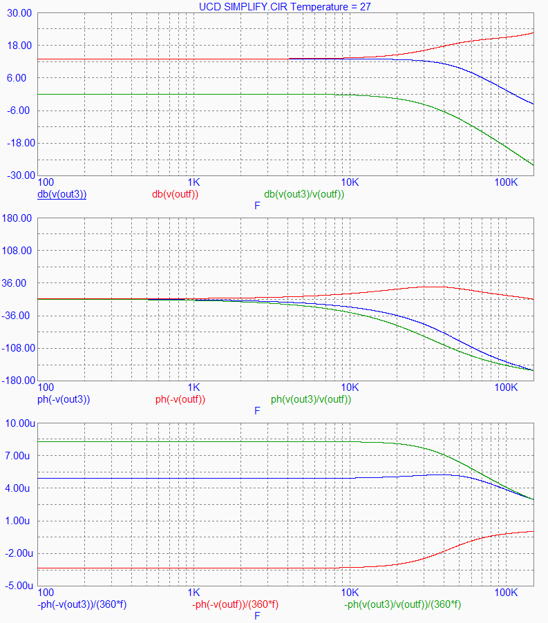

I've added a plot showing the amplitude response ,top, and the phase response (shown as phase, centre and scaled to group delay, bottom) of the output filter only (green curve), the response before the output filter (red curve) and the closed loop response (blue curve). The load impedance is 4 ohms.
The next plot is what you get with a 16 ohms load. The filter is now seriously underdamped, and resonates clearly. But, hurrah, the response before the filter now has a dip neatly cancelling the hump. Nothing shocking there, just control theory doing its work.
(I hope this also makes clear the difference in scientific usage of the word "theory" and common usage. The latter meaning "a conjecture", the former "a logical framework proven to model and explain reality reliably").
Interesting is that the group delay of the output filter has now become considerably shorter. As a result, the pre-filter response now has a positive group delay. The sum (=closed loop group delay) has remained virtually unchanged compared to what we had at 4 ohms.
I can already hear some contributors jump in saying "look but at 16 ohms you're actually making "delay" longer than without feedback.
Hmm. Possibly. However, absolute delay in audio is undeterminate. When I play some of my favourite CD's, the absolute delay of the whole chain is on the order of 25 years. Those 3us are not going to make much difference. What matters (and here is where the proper historic usage of the notion "group delay" comes into its right) is that you want all frequencies to arrive at the same time. In other words, you want the difference between longest and shortest group delay across the passband to be minimal.
At 4 ohms, and inside the 20kHz band, the output filter has a maximum deviation from linear phase of 0.18us, the closed loop response 0.17us.
At 16 ohms, the filter deviates 0.96us from linear, while the deviation from linear phase of the closed loop response has hardly shifted, standing at 0.13us (that it does shift is unavoidable, since I haven't got infinite loop gain)
Well you'll understand I could even make the deviation from linear phase zero if I wanted. All it would take is a single component change to set the closed loop response to a full Bessel response. This is the everlasting dilemma, also found in analogue post-filters for audio converters. Do we go for absolute linear phase, but allow in-band droop, or do we prefer a flat passband, and accept some deviation from linear phase? Both are audible (on electrostatics at least). I decided to cut it somewhere down the middle.
