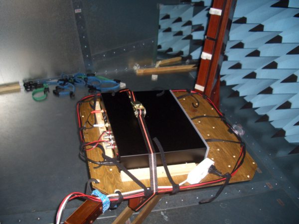

Today another ZAPpulse based amplifier, the V300, passed RFI / EMI tests for CE compliance. The testing was performed at one of the official EMI labs here in Denmark.
V300 is identical to the ZAPpulse 2.3SE action pack, and instructions posted here...
