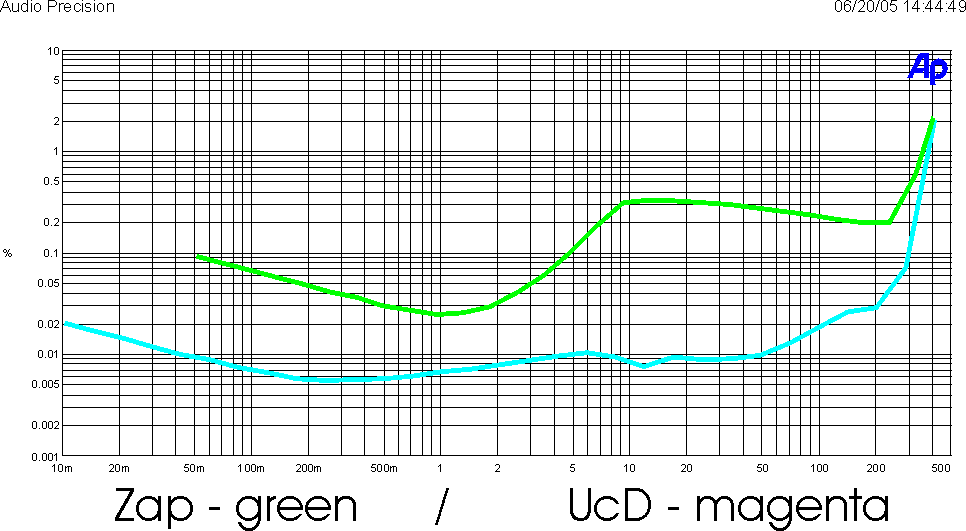

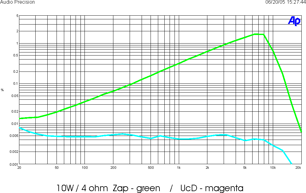

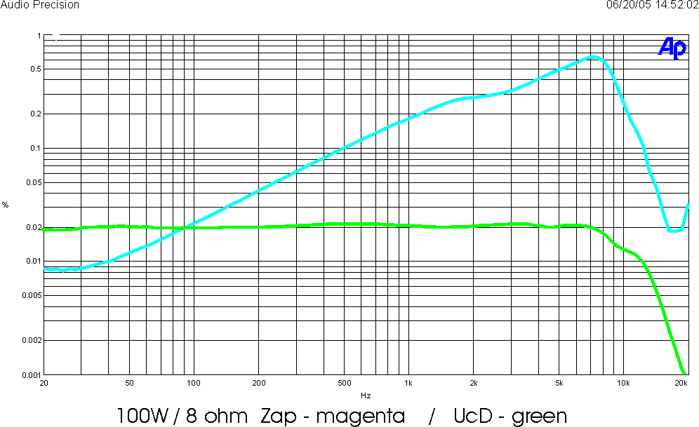

Jan-Peter said:Hereby a measurement of THD versus Frequency of Zap and UcD;
Jan-Peter
Hi Jan-Peter,
Thanks for sharing all those graphs. Next would be nice to see how the frequency response of both UcD and ZAPpulse compare when both are loaded with a typical speaker. Also step response (square waves) would be nice to see.
Best regards
Gertjan

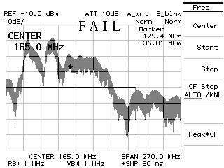

Originally posted by Jan-Peter:
Actually I measure much more EMI.......
Well if you look closer on your graphs, most of your noise is just below -60 dB, and most of ours is below - 50 dB. I would say the difference is something like 6-10 dB. I will not dispute your measurements, but i just want to ask if you have followed our RFI recommendations? (look here)
and better drawing is found here
In any case i found that incorrect hookup can mean a great difference in the noise emissions from our ZAP module, because we operate with a floating input GND. If this is not properly tied to GND, (As shown in the above link) the noise emission will grow significantly.
Anyway we are in progress with CE certification, and i will make some real TEM cell RFI emission tests of our modules in the certified RFI lab very soon. I will post results here later.
About the THD, there is nothing new here, your THD specs have always been lower than ours. As always, the way we see it, we could easily lower our THD, but not without sacrificing some of the high sound quality. Which has recently been confirmed by independent listening panels.
No doubt if your main interest as a customer is to get an amplifier with good THD spec's you should definitely choose Jan-Peter's amplifier over ours. Or even Icepower, which has very low THD spec also).
Of course NOT, it's a one to one comperation and not measuring one without any one with extra shielding. Or an amplifier what is tweaked for an EMI certifaction.......
The both amplfiers were mount on an aluminium plate and all power wires are put true a current clamp. So actuall we measure the HF antenna current.
We have done a lot of official measurements so we know below which level we must be to be on the safe side. When you look back to the Spectrum Analyzer measurement you have to be around -60dBM of the screen, in this case you have big chance you pass all EMI rules....
In our internal demo 19", were we have the advantage of a complete metal case, the EMI measurent in an official test is really VERY low.

Now now, Lars 😀Lars Clausen said:About the THD, there is nothing new here, your THD specs have always been lower than ours. As always, the way we see it, we could easily lower our THD, but not without sacrificing some of the high sound quality.
1% THD at higher frequencies exceeds that of most good tweeters and is plainly audible, manifesting itself as a very obvious brightening of the top end. I am in no doubt that many people will like this sound, but an amplifier should not have a sound of its own like that.
Lars Clausen said:No doubt if your main interest as a customer is to get an amplifier with good THD spec's you should definitely choose Jan-Peter's amplifier over ours.
You seem to believe I design for the best numbers. This is not quite the case. If I did, the amplifier would have had a rising THD vs frequency response (0.003% at 1kHz, 0.03% at 10kHz). This would have resulted in a spectacular THD vs power graph at 1kHz, which is what numbers-minded people are looking for.

The Zap output is in no way more "special" than any other class D's, except that the output ripple is unusually large.peranders said:Just wondering, but those measurements you have made are there any special considerations taken due to ZAP's special output?
In order not to be influenced by switching ripple, the AP is fitted with an AES17 input filter that rejects anything above 20kHz. Further, if any HF did make it past any input filtering, this would show up as noise, not as distortion.
Also, the EMI level of the Zap is way too low to cause erroneous analyser readings. The amplifier shown as an example of "really bad EMI" produced much lower THD readings than the Zap modules, demonstrating that THD can still be reliably read in the presence of EMI much higher than what either Zap or UcD produce.
In other words: the distortion plots show actual distortion that is really there. It is not a measurement problem.
The only way forward from here to reducing distortion is switching faster by the same factor. All other things equal this also increases EMI by the same amount. Yet, switching faster is exactly what UcD does. To arrive at the low EMI levels that we are getting, an extreme amount of attention to detail was required.
