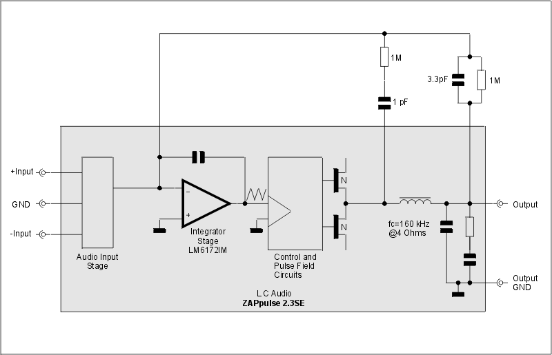

The main difference between ZAPpulse and UcD is that ZAPpulse uses pre filter NFB, while UcD uses post filter NFB. (As discussed in another thread).
With the new feedback tweak as proposed by phase_accurate, and optimized to fit the ZAPpulse, you have the option to run ZAPpulse (any newer version) in post filter NFB mode. or what could be called 'UCD mode'.
So maybe it's now UCD and ZAPpulse 😀
The tweak will bring about the sonic properties associated with post filter NFB amplifiers (like UCD), whether you prefer these or not is a matter of taste. But anyway some readers of this website might like to check it out, and so can now tweak their ZAPpulse module to this mode.
Since ZAPpulse's gate driver system has very low time delay, a ZAPpulse in post filter NFB mode will operate with a switching frequency of 700 kHz.
Will post tech details in 'the easy tweak for NFB' thread later.

The tweaked Zap is not a UcD. The UcD control loop has no feedback taking off before the output filter. Done correctly, this provides the most neutral sound possible, a feature that mixed feedback loops do not share (ie. Lars' criticism of the sound of his mixed feedback modified modules is correct).
700kHz switching frequency does not sound like a good idea to me. The switching frequency in UcD is determined by several parameters of which the propagation delay is only one. One can get any switching frequency from any prop delay.
I'm not going to publish a schematic of how to get the best performance from a Zap module using a proper UcD loop. Besides, while porting the UcD loop to other power stages will obviously work, most power stages will produce too high distortion figures, due to UcD's modest (but constant) loop gain. Having frequency-constant THD is a prerequisite for good sonics, but so is low THD.
Much of the secret in the UcD power stage lies in getting low THD at medium powers without resorting to overlapping FET drive. IC gate drivers generally result in very high THD at low powers when a similar dead time is chosen.
The UcD700 is called so because you can set it to deliver 700W continuously into a 4 ohm load and come back a year later with the module still playing happily. The semiconductors are not an issue here, the capacitors are. The ripple current in the local buffer caps is 0.2 times the RMS output current. This is 2.7A. You will need several caps in parallel to handle this at elevated temperatures with good lifetime. I've seen elcaps blow up on "high power" modules with insufficient local storage. Admittedly the current incarnation of UcD700 is seriously overrated with respect to this. 2 or 3 electrolytics per side (or 5 much smaller ones) would do quite nicely in all but "night&day" applications.
Nobody claimed that, and definitely not what we are trying to achieve. We just want DIY'ers to have a chance to play with post filter NFB.
In this implementation prefilter NFB is limited to above 150 kHz, (like also suggested by charles - the filter cutoff frequency) and therefore have no significant effect on the sound.

Below you can see our post filter NFB setup for the ZAPpulse. The values shown are the ones that work best for ZAPpulse, and will give a constant switching frequency independent of the load. For other Class D amplifiers other values might work better. The sound is best with plastic capacitors, compared with ceramic NP0 caps.
