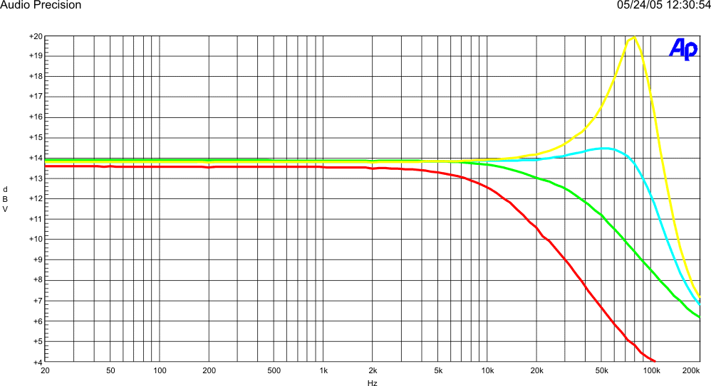

This has been my experience. Fractions of a dB can make dramatic differences. I have also noted that a slight change (e.g. slight increase) at high frequencies (between 10khz and 20khz) can be perceived by some people as harsher (more apparent high frequency content) and by other people as smoother (less apparent high frequency content). The location of a high frequency resonance will also affect different people differently. This makes for some argument when fine-tuning a speaker system with multiple listeners describing the differences they hear.
So when Lars says he hears better things from his amplifier I believe him. I expect that if we all had several amplifiers to play with we could find our favorite, and it would not be the same amplifier.
My own experiments with the ucd400, comparing to an Audio Research M100 monoblock, has been interesting. These two amplifiers sound more alike that any other two amplifiers in my experience. This is particularly strange because one is a tube amp and one is class D. Somehow they both do the important things right (they are both very good). The biggest difference is a small but significant difference in high frequency response caused by the frequency dependent output impedance of the tube amp (favorable to the electrostatic panels I am using). I am working on this, getting closer to the sound of the M100 amps.
I know that making very small changes to the HF roll-off.........say something in the area of 0.1 to 0.25 at 20 kHz.........can make a radical difference in the perceived sound.

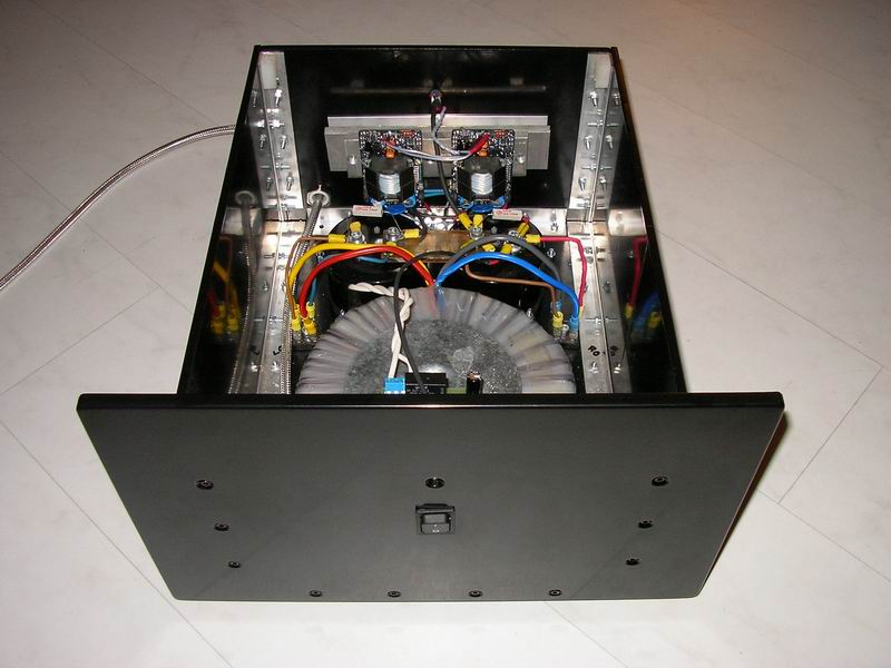

Hello,
My Opinion from the listening session between the Zappulse 2.3SE and the UCD400 from Jan-Peter.
I found the differences between the Zappulse 2.3 SE and the UCD400 very big, the Zappulse has a very open sound, the air/space from the voice of the singer and the instruments from the Zappulse were much more present than the UCD400.
Also was the Zappulse more detailed in placing the instruments, UCD400 I found too tame, it like there was a curtain over the loudspeakers.
My Zappulse has a much larger power supply in the test, I have done that because it was tested on the Dutch forum that you have minimum 1000Va transformer for the Zappulse.
A person were in the assumption that with 2000Va ring core transformer the bass much more under control, and more dynamics than with the 500Va transformator in a Zappulse.
Rudy
Sorry for my bad English
Preamp: AVM
Amplifier: Zappulse 2.3SE monoblock 28 Kg.
Amplimo ringkern transformator 2000Va 2 x 42 Volt.
2 x 47.000µF 80 Volt type Mundorf M-Lytic HC.
DVD Player: Marantz DV17
CD Player: Denon DCD 3560 LClock XO 2.
Speakers: ACR Isostatic RP-400
The picture has a bridged Zappulse in the test was only 1 Zap.

Can't really be sure if what you're comparing here is the UCD Vs ZapPulse or the ZapPulse small PSU Vs ZapPulse grossly oversized PSU.
It must be the later though because all of the test specs you've provided deal with the ZapPulse, not even a mention as to the VA used with the UCD for instance, for all we know it could have been 10VA on the UCD but not a word of your sonic dissertation of it would have been untrue.
Have you applied for a review mag yet 🙂
Could you possibly swap transformers and retest each module with the same PSU for more meaningful listening results? For your own curiosity anyway.

There is indeed a difference soundwise spoken in the high end of an UcD amplifier and a Class-D amplifier who has not a post-feedback. That's is an HUGE difference in the frequence response with different load above 10kHz.
Hereby a measurement whereby there is NO post-feedback.......
(from top to bottom; 12, 8, 4 and 2 ohm....)

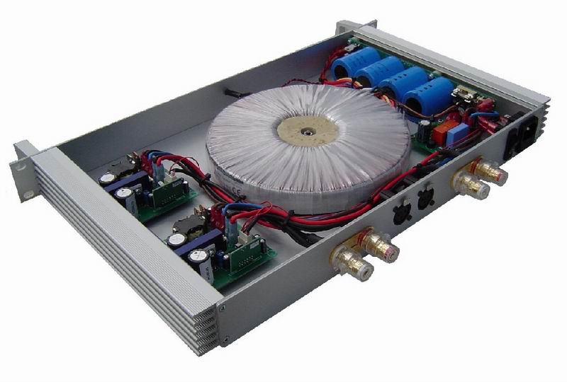

BMW850 said:The UCD400 has a 1200VA transformator and 4 x 10.000uF BCC elcos.

two comments :
- in the UCD-based amp , i would put the caps closer to the modules
- to compare the two modules , you have to use the same power supply , as they are both VERY sensitive to the filter caps
